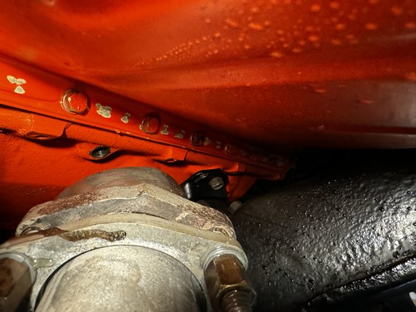

First up was replacing the generic starter that was on the car. I was able to source a correctly dated and rebuilt unit and made the swap. After spending some some time investigating I decided it was easier to tackle this by removing the RH exhaust manifold rather than fight the wiring blindly and wrestle the starter out - was much easier this way. No rust issues to contend with so removing the 7 bolts and sliding the manifold out of the way didn't take too long. Found a loose lower control arm cross shaft bolt while looking around so took care of that too.

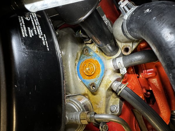

Lastly - when I bought the correct starter for it I also bought a correctly (or more correctly) dated water pump. We've been having issues with rusty anti-freeze/water mix even after draining and refilling the radiator 2x yearly since we installed the new motor 4 years ago. While I had the radiator drained to install the new water pump I thought it a good time to replace the thermostat (I should have known that Dad had a spare AC Delco one in his stash) and drain the block (easy to do on the starter side when the exhaust manifold and starter are removed - not so much on the driver's side) to try and get most of the rusty stuff out of the system. Last summer I also installed a new fan clutch on a correct fan sourced from Verne Frantz a few years back (I miss Verne). Ran out of time this afternoon and didn't get the belts adjusted or the system re-filled or tested today but will get to that in couple weeks - all the hard stuff is done.

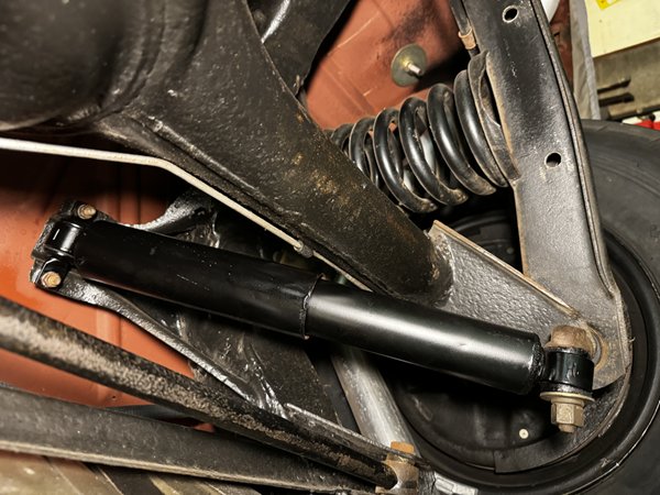

Next up was to remove the Gabriel Hi Jacker air shocks he installed and re-install the shocks he took off - I know they are not correct/accurate - but they are much better than the air shocks and will do just fine for now.
