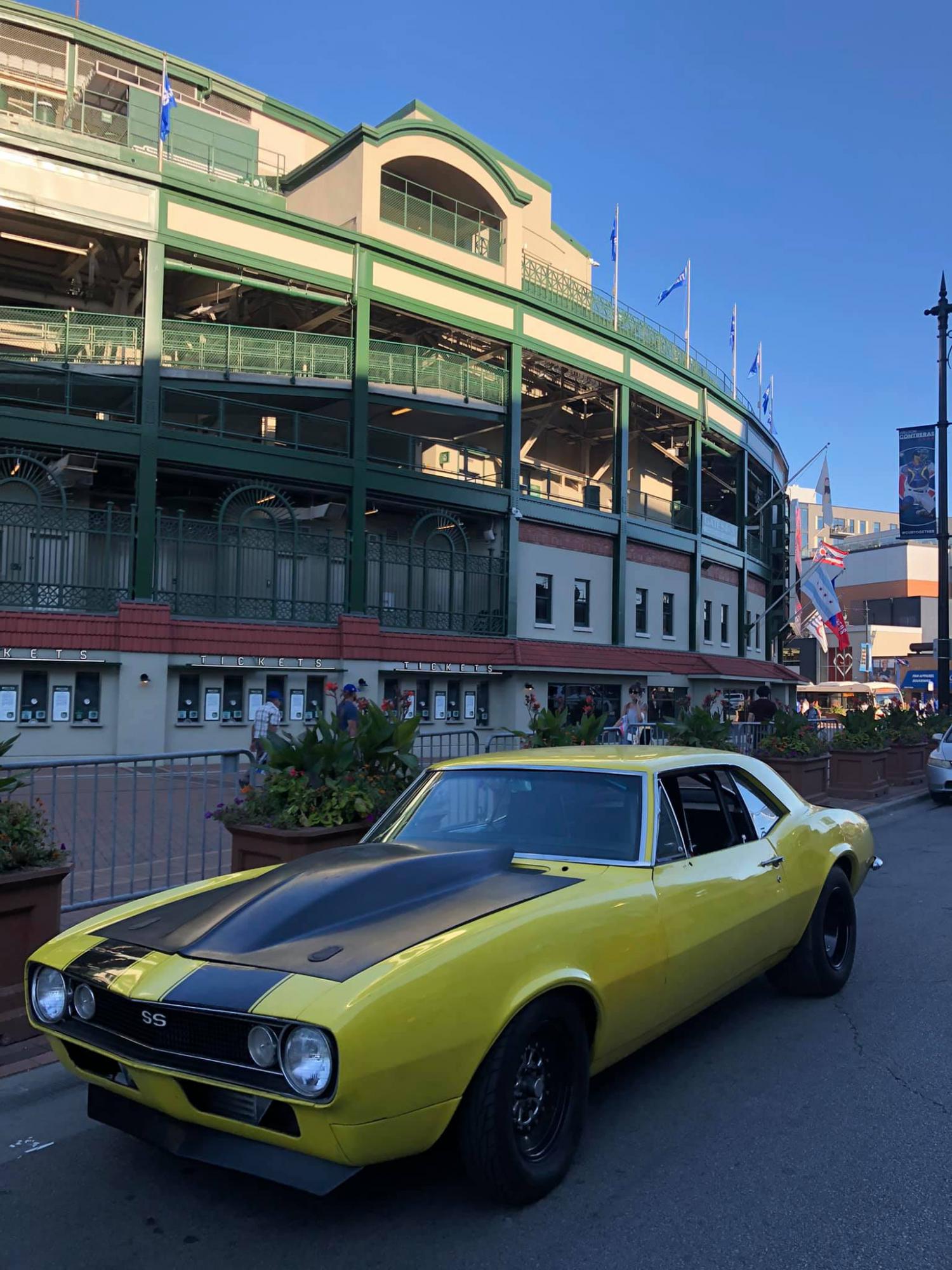

@turbobird would love to see some pics of your car.
I got the car out last month first time ever, went 12.4 and on my 4th pass went 9.30s. Later went 6.04@123 in the 1/8 maybe a high 9.2x pass.
I am redoing some of the front suspension for next season to rid the car of the current death wobble at high speeds.
