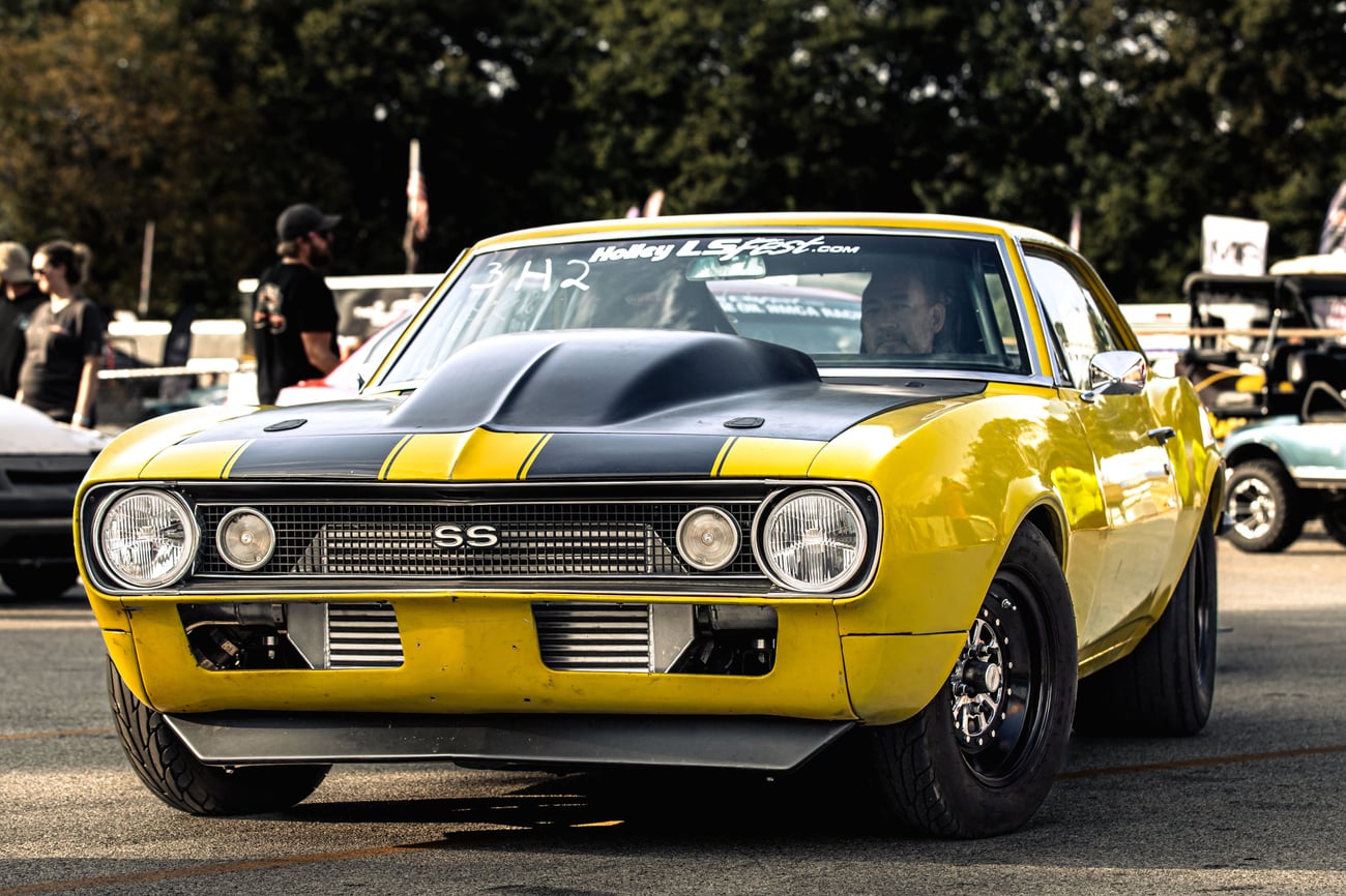

  #25
Old 09-10-2024, 06:37 PM
Pro Stock John's Avatar
Location: Chicago, IL
Posts: 1,277
Thanks: 891
Thanked 1,344 Times in 444 Posts
Found a nice shot of my 5.64 (8.75 in the 1/4) run:
