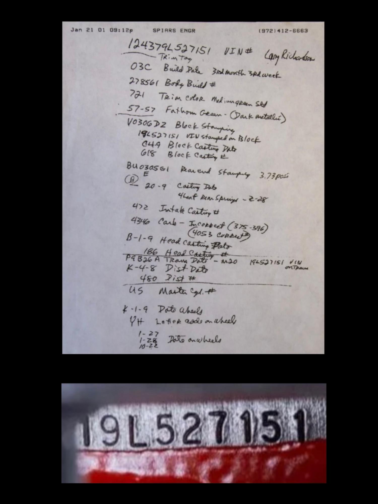

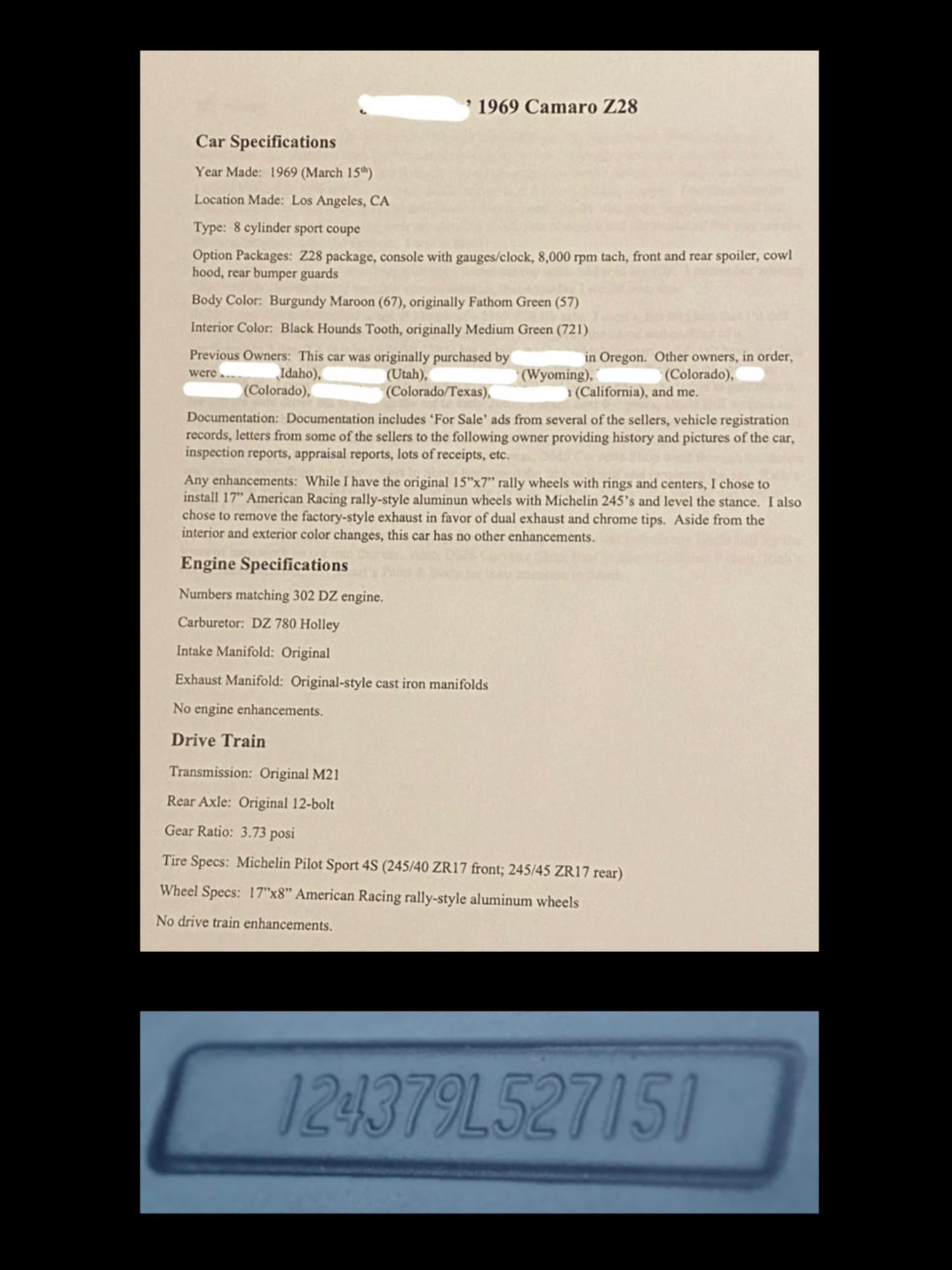

Default '69 #s Z/28, MacNeish Cert
Nice looking '69, originally Fathom Green according to the MacNeish certificate.
I have to say, this is probably the cleanest '69 Van Nuys pad stamp I have seen. I've owned a few DZ blocks from Los Angeles builds and each of them had a partial VIN that had at least one mismatched number font. This one is textbook perfect.
Link to 1969 Z/28 eBay auction
*Note: When you click on this link and make a purchase, I may earn a small commission from eBay. These commissions help to provide financial support for the sYc site.
124379L527151

Looks a lot better than when it was on BAT. Grill painted and rallys installed. A few guys were insisting VIN restamp during the auction.

Trans/Engine Vin stampings appear slightly different/need inspection/comparisons.
McJerry Certificate notes Original Drivetrain but report pages w/ details not shown also, included info descriptions note Trans + Rear as Original but Engine #’s Matching?

I hate when they don't include the appraisal document.
Drivetrain stamps are good, I'm not seeing an issue.
I think the color change actually benefits resale - mainly because of the original 721 interior.
