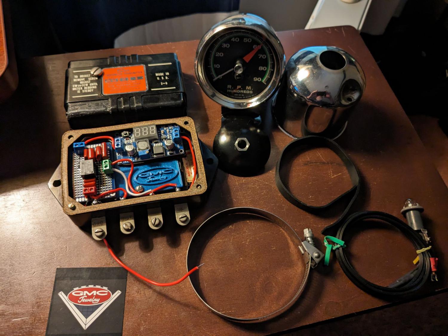

I was looking through my parts shelves yesterday and stumbled across this tach that I bought about twenty years ago. I didn’t have a use for it at the time so it’s just been occupying a shelf until now. My question is, does this type of tachometer require a sending unit? It had 4 wires bundled together coming out of the rear of the tach. No idea if they are the original wires…2 were red, 1 black and one yellow. I’d like to use it but I want to be sure I don’t damage it by wiring it up incorrectly. Any advice is appreciated!

No unit required, go online and get wiring diagram for them. Simple to hook up.

Tachs are direct connect. They can be for different cylinders though. This one does not have the model number on the face so you will need to pull the cup to see the application on the back.

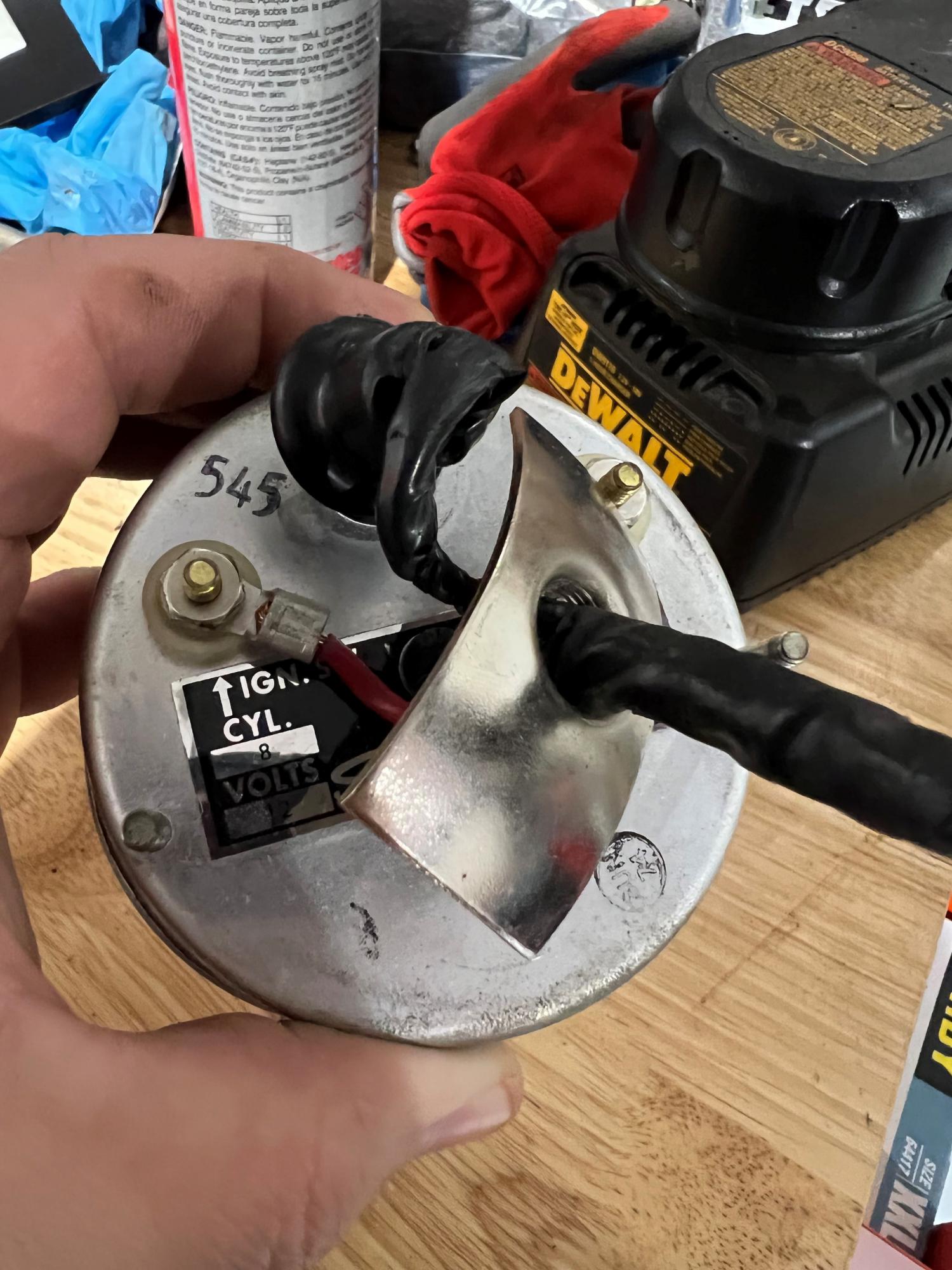

After removing the chrome cup, I have an SST-802-2 for an 8 cylinder engine and it has a stamp in black that says 545 close to the light socket. Is this a date code?

My Sun Tach is a 802 but it doesn’t have the -2 on it. I’ve used it with points and now a Pertronix set up.
