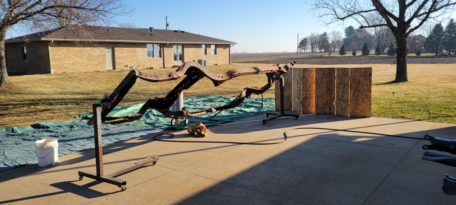

What type of product are you using for your blasting and what are you prepping the blasted surface with before painting ? Thanks
I use basic sand blasting sand and a standup outdoor blaster. For many of you following I dont get bogged down in the details of thinking the most exocitc process is the best. I keep things as simple as I can. In terms of sand I use the stuff stocked at the local Menards for those that live in the midwest. Most here on the forum are gonna die laughing but I still use the old school lacquer based primers. Im not afraid to use the lacqur direclty on the blasted metal. Once I get into the stage of sanding and removing pits 90% of the first coat is sanded off. Body panel work is a total different story. I get into the more better adhering epoxy primers for my basecoat but still layer body filler and lacquire primer on top of that.
Ocassionally i will use a 2k high build primer but I will only get into that with easily sanded surfaces and heavier pitting. This car will not require and 2k as im already finding a single sand is elimating all pits if they even exist.

AND takes all day with a pot blaster. I see you sweep it up and screen it back in the pot too. Been there, done that, but only once. Now I farm that out. Getting more difficult to find places that blast anymore though.
Your media looks like black diamond, coal slag. I do use that on frames but use the white play sand for other things.
