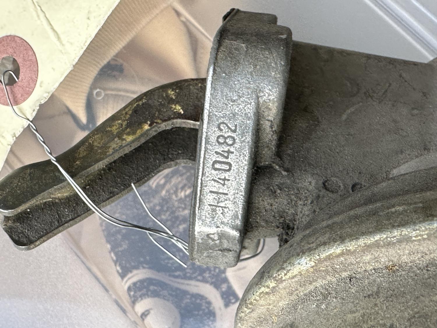

I’m no expert at all but here is my legit Sept 69 40482 AC fuel pump for my L89 corvette

Yours make sense. The 1st 2 are letters, "I" "I" which is as you say Sept 1969. The original that is posted I have no knowledge on. Originally they were 2 letters (month & year). Later changed to 3 numbers (julian date) & 1 letter which was the year....Joe

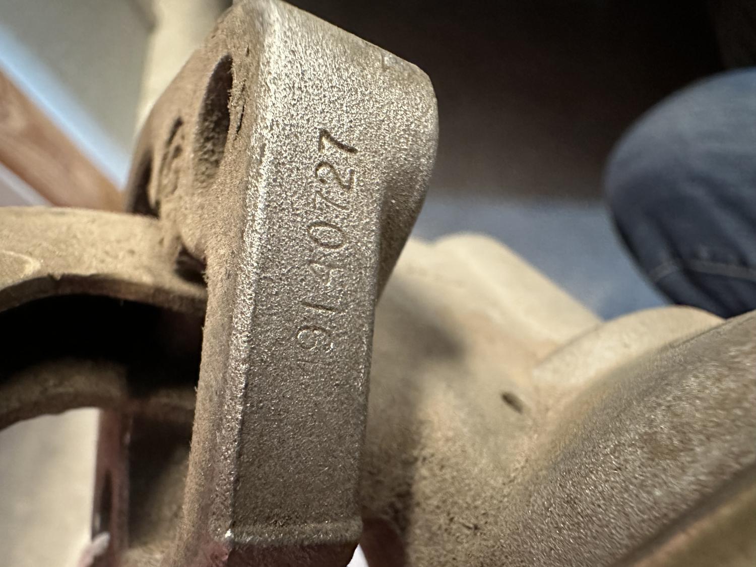

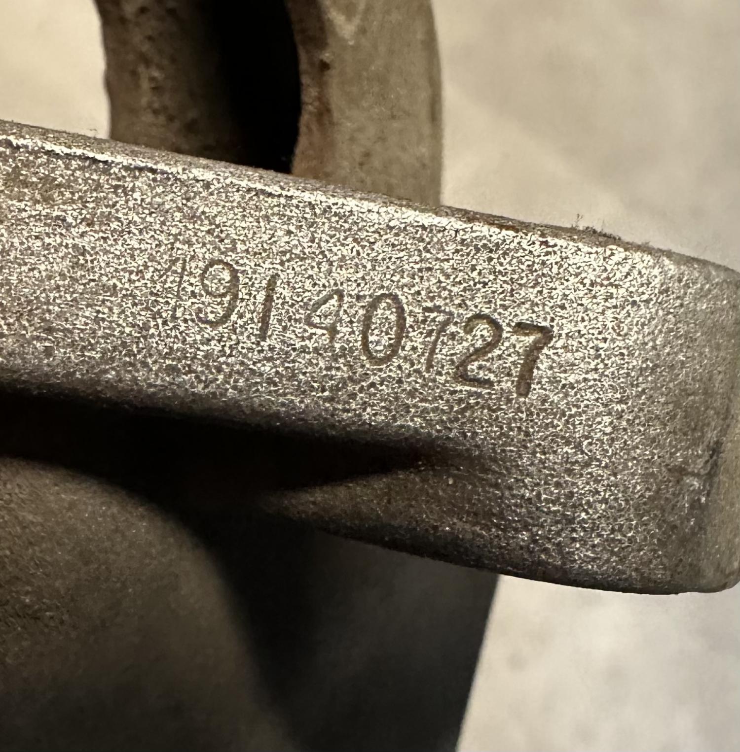

Here are original fuel pumps from three of my 427 Corvettes, all are original to the cars and have been rebuilt.

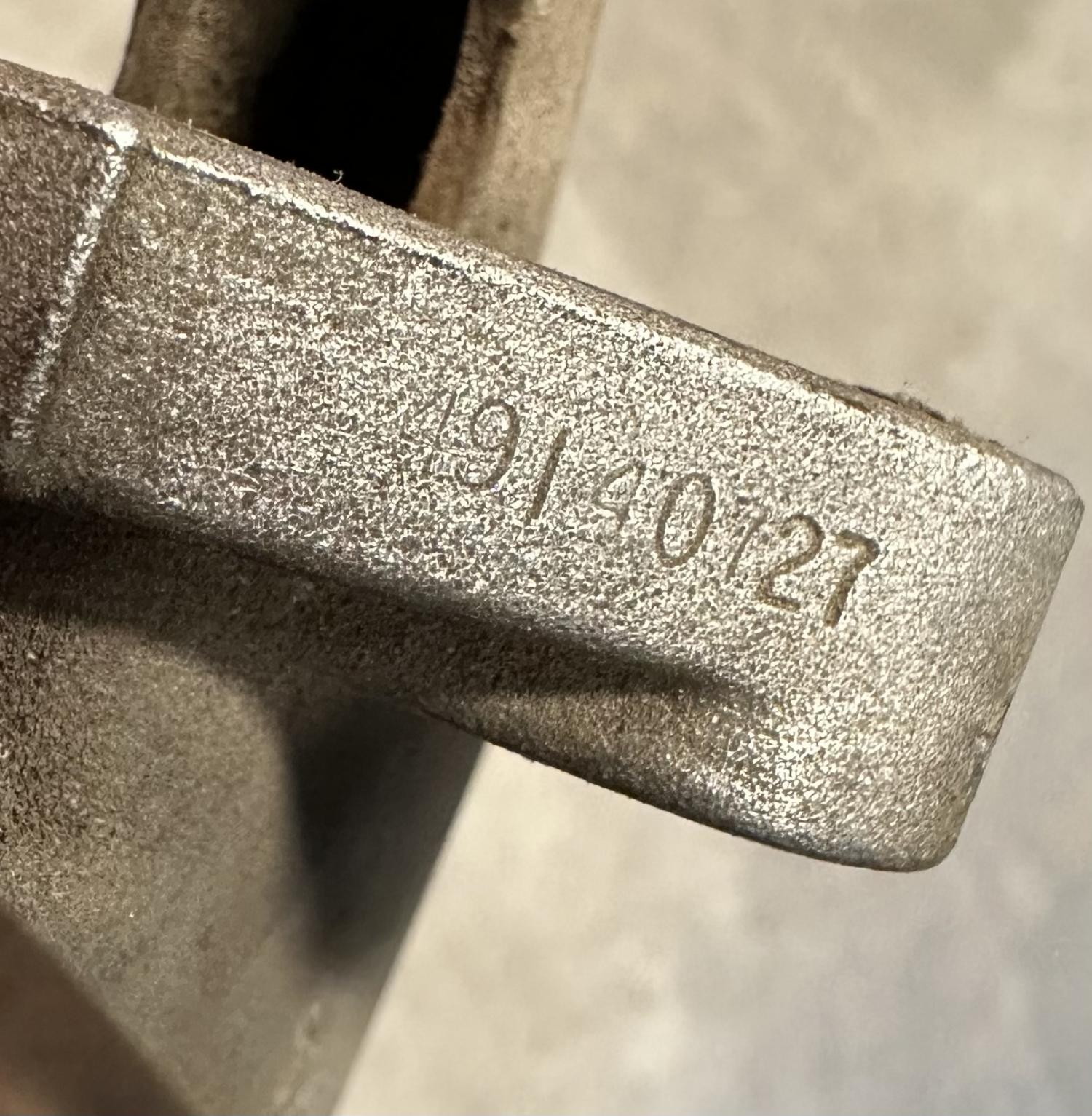

Here's a pic of an assembly line 40727 fuel pump stamp.

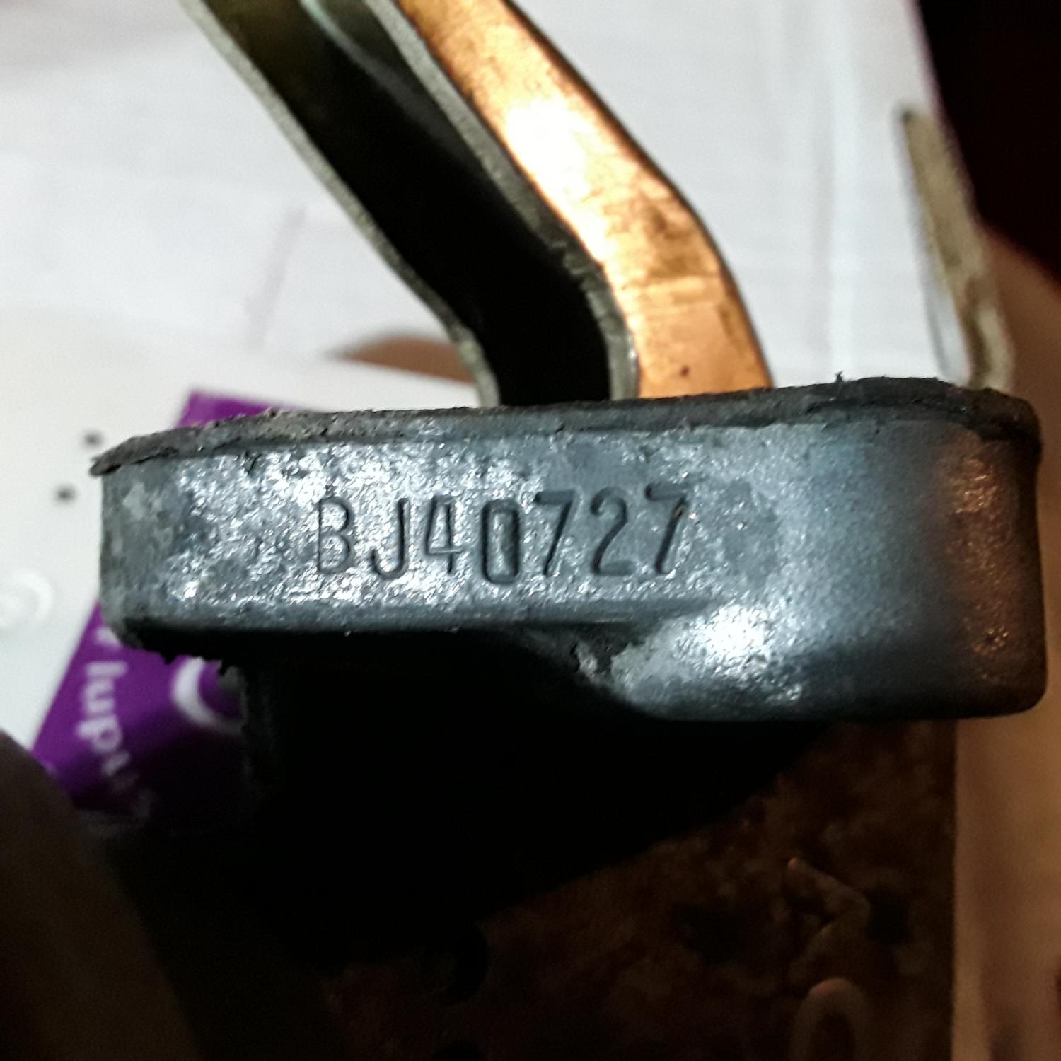

From all the pictures, it looks like the assembly line pumps have the more square "0" and the replacement pumps have the more oval "0".
