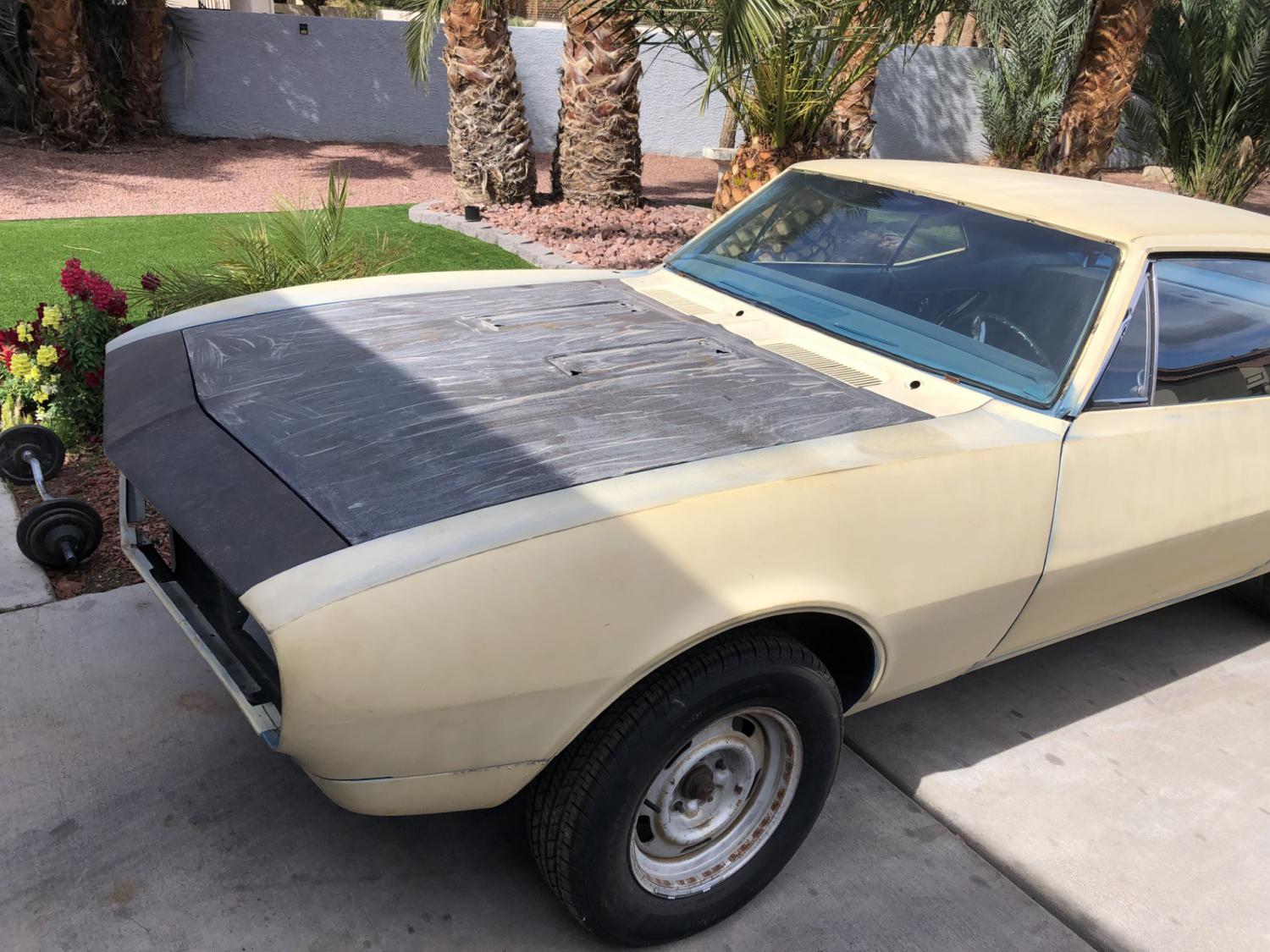

Available is a extremely nice and rare 1967 Camaro "L30/M20" rust free project car
I am helping a buddy sell this off, as he has a few other cars to build, before he could get to this one, so offering it to someone that will make it their dream car

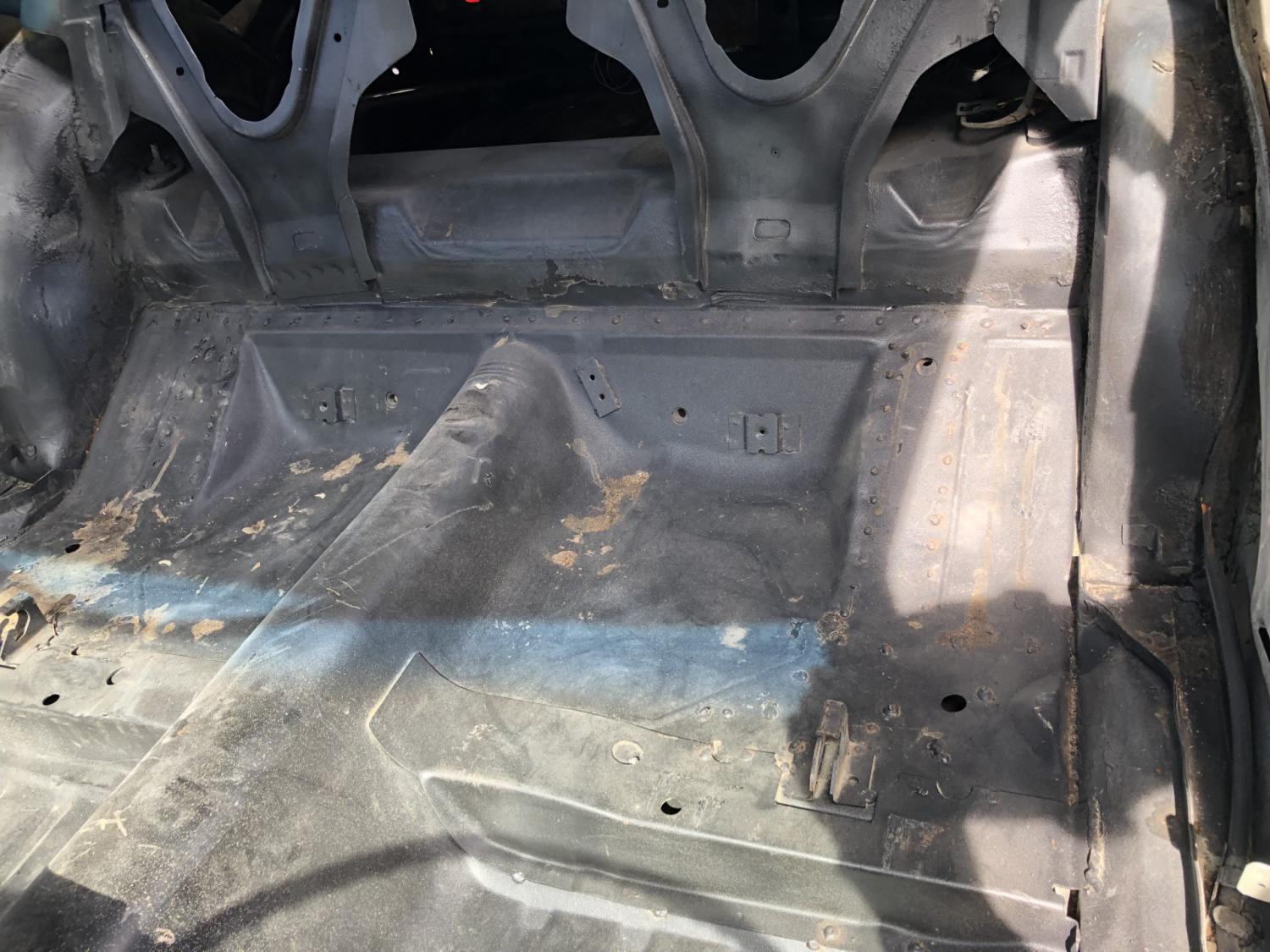

It has had all metal work has been done by previous owner, new full quarters, rear body panel, full floor pan, SS hood, Header panel, NIB rear spoiler, it was sprayed with sealer, my buddy sanded off two sections, just to verify, no repairs, ready for bodywork and paint
The previous owner already painted jambs, inner doors, fender, hood of car on original Marina Blue

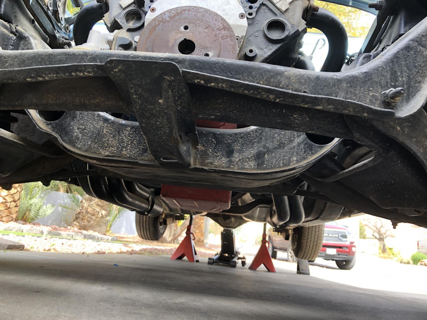

Car has a later model 350 with domed pistons, head studs, GM performance aluminum heads (#14011049), 70-71 Z/28 / LT1 aluminum intake manifold (#3959594), Moroso oil pan, no other specs on engine, haven't touched it, Hedman headers, no accessories

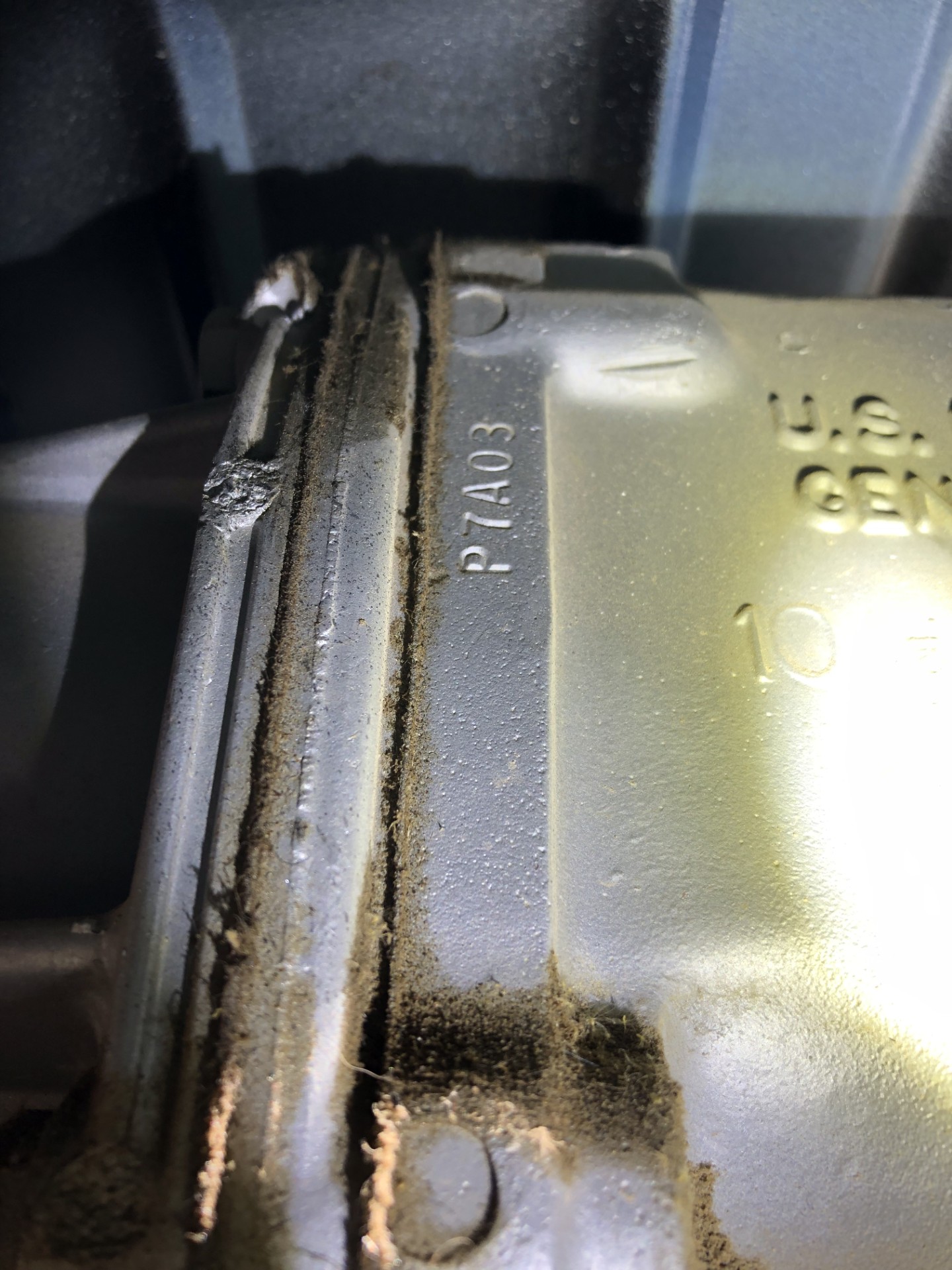

Has early (Jan 1967 P7A03 code) Muncie M20 4 spd w/ Hurst shifter assembly, mated to the original 10 bolt posi rearend "PE" code 3.08 posi
Stock frame / suspension, later disc brakes, manual steering, new SS Brake and Fuel lines, new body bushings

Since you mention the CRG report, have you checked for the firewall piercing for the Muncie speedo cable that would be present on an SS ? That would be another indicator of this being an actual L30 car. The build date of the Muncie is curious also. It is in line with the build date of the car, but the L30 never received a Muncie trans, they were all Saginaw. Use a mirror and light to see if there is a partial vin stamped on the top of the trans. Which, if that is a match, why the 10 bolt rear with a close build date ? Very interesting car...
I have an 02C built at LOS with many of the same options but an automatic, which, thankfully, eliminates all this guesswork.
Thank you for input!
That is exactly what I checked, the speedo cable hole is under master cylinder (left of steering column, Saginaw location)
the Muncie has a different 67 VIN stamped on it
