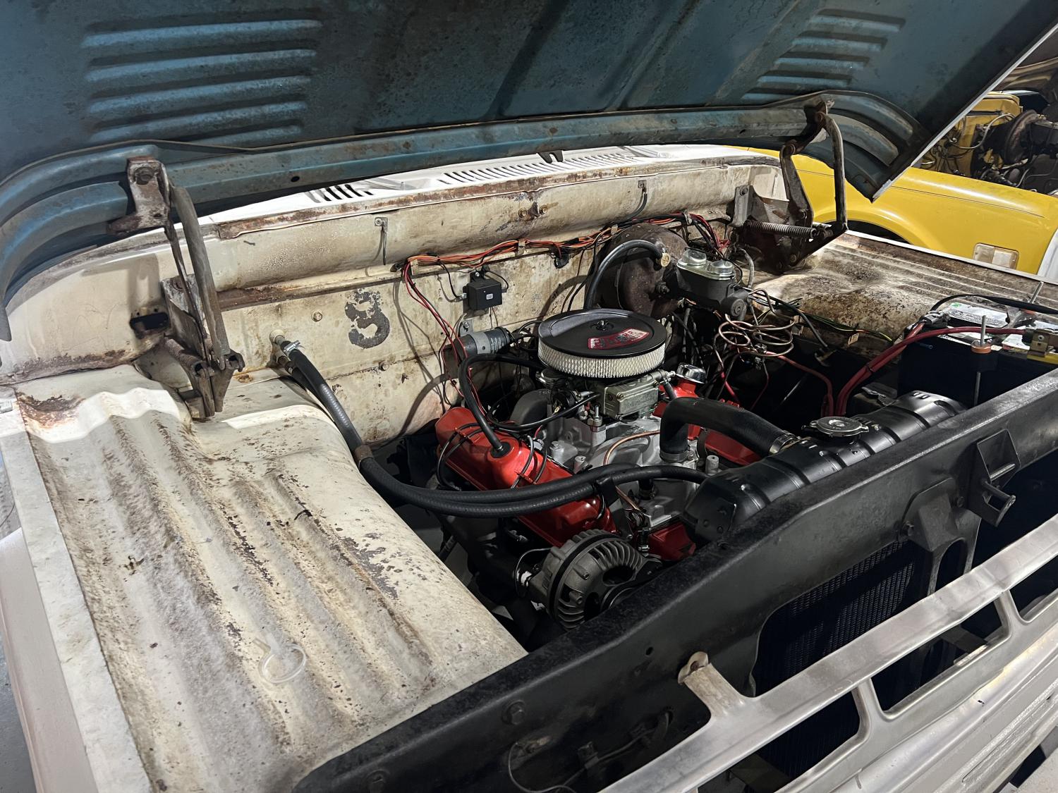

Moving on to the engine, it was evident that it was filthy, 50+ years of grime, grease and makeshift repairs, it was leaking from every conceivable orifice, but it ran very well, so I decided to put a new Cloyes timing set in it, new rear main, front timing cover seal. and all of the gaskets. I went through the wiring replaced what was necessary. Need to rewrap the harness still but at least the issues are fixed.
While I was at it, I had an old LD4B Edelbrock intake and 390 cfm Holley 4 barrel collecting dust from an old project so I cleaned them up and put them on the truck. The truck is no speed demon, about 60 mph tops with the 4.88s, so I knew this would be more than adequate for putting around town or hauling when necessary. I had to make a piece of throttle linkage to connect the Holley and used some spacers and hardware from the local Ace to get everything aligned correctly.

Here are some additional engine bay photos of my progress. I noticed how filthy the distributor was, so I pulled it and cleaned the cap and wires and continued putting it together. I am currently trying a few different rust converters on the inner fenders and firewall and have cleaned those up a bit, but it still needs a lot more work. For an old work truck that has been well used, I think the TLC has really turned it around for the better and will keep it in service for years to come. My 3 year old son loves this truck and wants to go for a ride whenever I take it out. I plan to pass it along to him when he grows up. It's not a supercar but it is a family heirloom that I have so many wonderful memories with. My dad was able to find a few pictures of it from when he bought it in 1985. I've also shared those. Amazed it's still around after almost 40 years!
