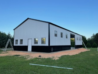

I just had a 2,100 SF shop built with 14 foot sidewalls and 19 feet at the peak and currently researching options for cooling / heat without breaking the bank. I did go with insulation during the install, but potentially will supplement that. Shop is in North GA, so not too concerned about heating it, more so cooling. Looking at using several mini splits as I don't think I'd get enough air circulation from a single wall unit. Think I need at least 40,000-50,000 btu. Curious what others have done.

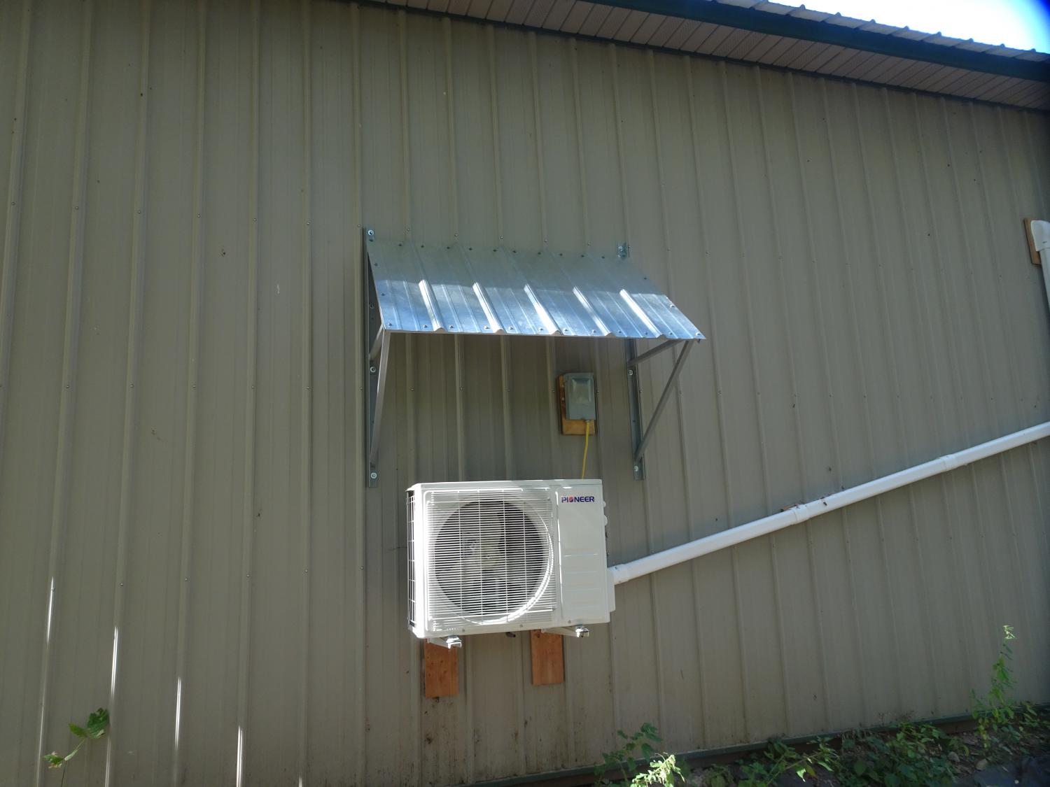

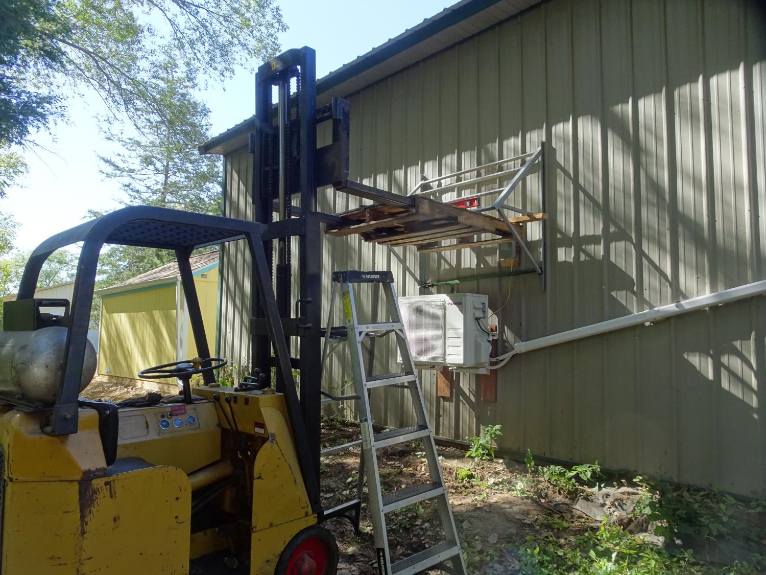

I built a heavy duty awning to deflect heavy snow when it slides off the roof.
