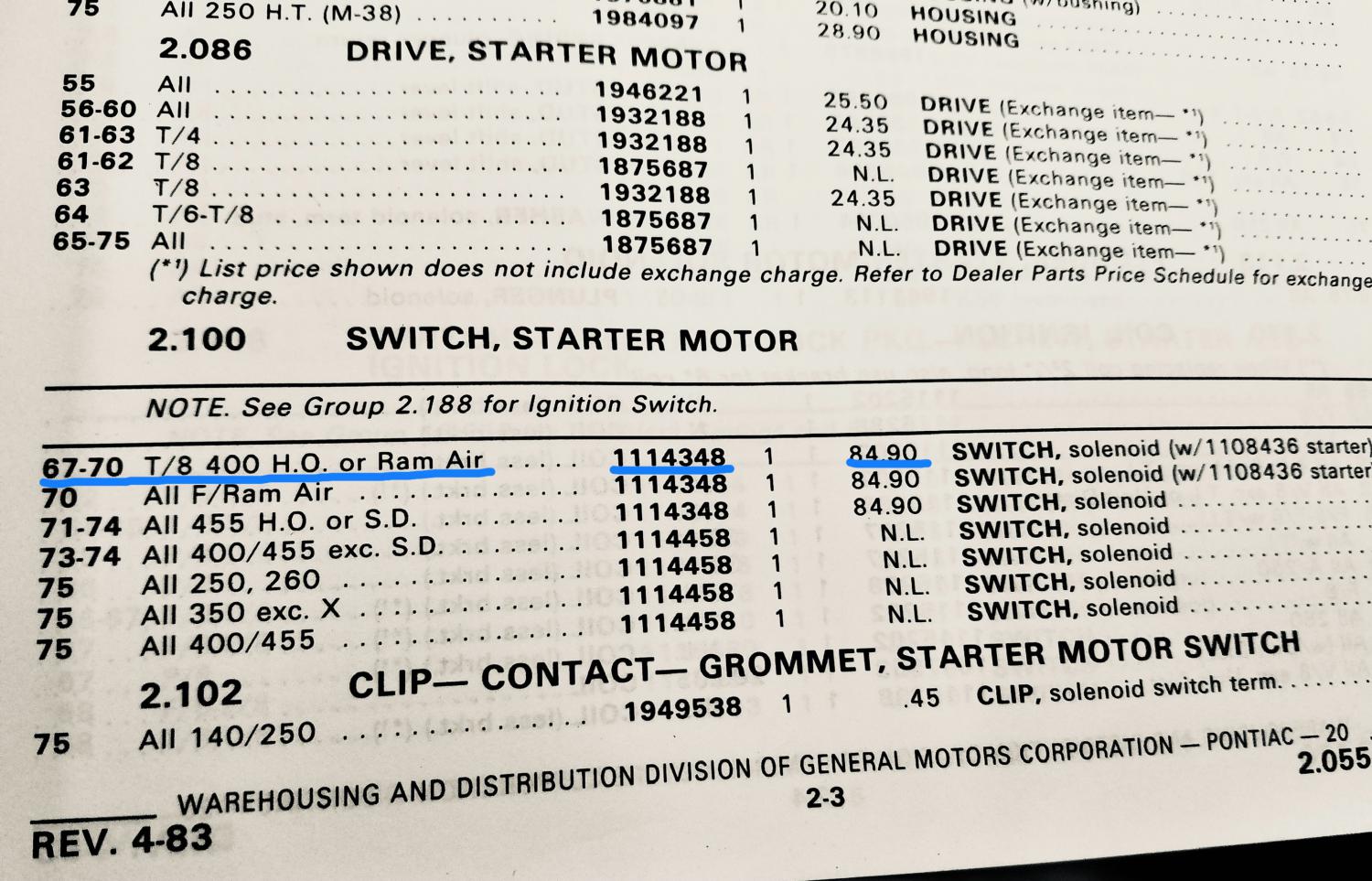

A little off the OP topic, but it is starter solenoid related.
This pertains to Pontiac usage and the early (65,66,67) GTO specifically.
Decades ago I purchased whatever I could find electrical related.
Distributor caps (no R), rotors, points, AC plugs and starter solenoids.
Below are a few still in my stash.
#1114356 Switch
#1114348 Switch
Check the price difference between those two Switches especially the ‘83 rev. price.
The “4348” are like gold. Brutal construction with no Bakelite cap, but instead a heavy metal cap to hold up to the tremendous heat generated by the HO/RA exhaust manifolds.
The three ‘67 GTO HO cars I once owned all had the 4348 switch as they never went bad.
An old eBay ad from years ago showing what the “4348” solenoid was priced at.

----Good info, Chris! Would my 69 SJ GP with HO exhaust manifold upgrades actually need the 4348 solenoid in your opinion? Have never had a problem to date.....Bill S
Hi Bill,
Sorry, but my knowledge is limited to 65,66,67 GTO’s.
I would suggest asking Grant Baber. He is the guy when it comes to the GP.
