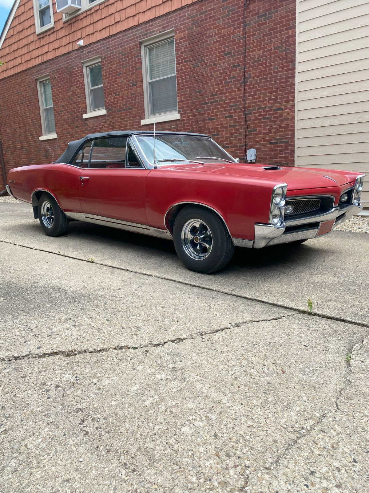

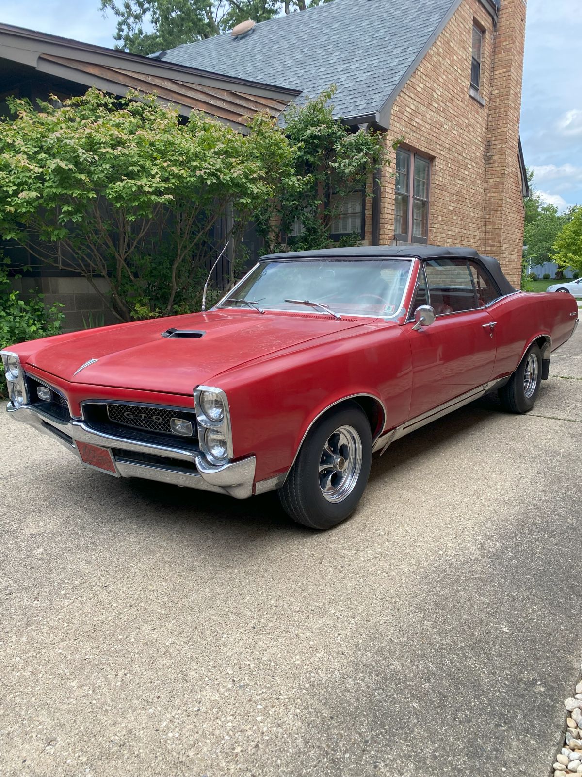

Hi all,
I recently purchased a 1967 GTO convertible project. Some of you might recognize it due to the unique interior. I bought it off eBay and the seller was in Texas however the car was originally sold new in WV at Gibbs Motor Company.
As mentioned, the car is a project and needs a good amount of work but it’s a genuine 67 GTO convertible 4 speed car. It came from the factory painted regimental red with red interior and a black top. It does not have the original engine but it appears to have a 67 GTO WS code engine which would be a 360 HP engine with a 4 speed. It also has rally gauges, power top, console, power disc brakes and close ratio power steering.
My plan is to get the car running good (currently runs) and driving. I’m ok with just cleaning up the paint as is for now. The interior will definitely get replaced with factory interior but not until after the car is drivable.
