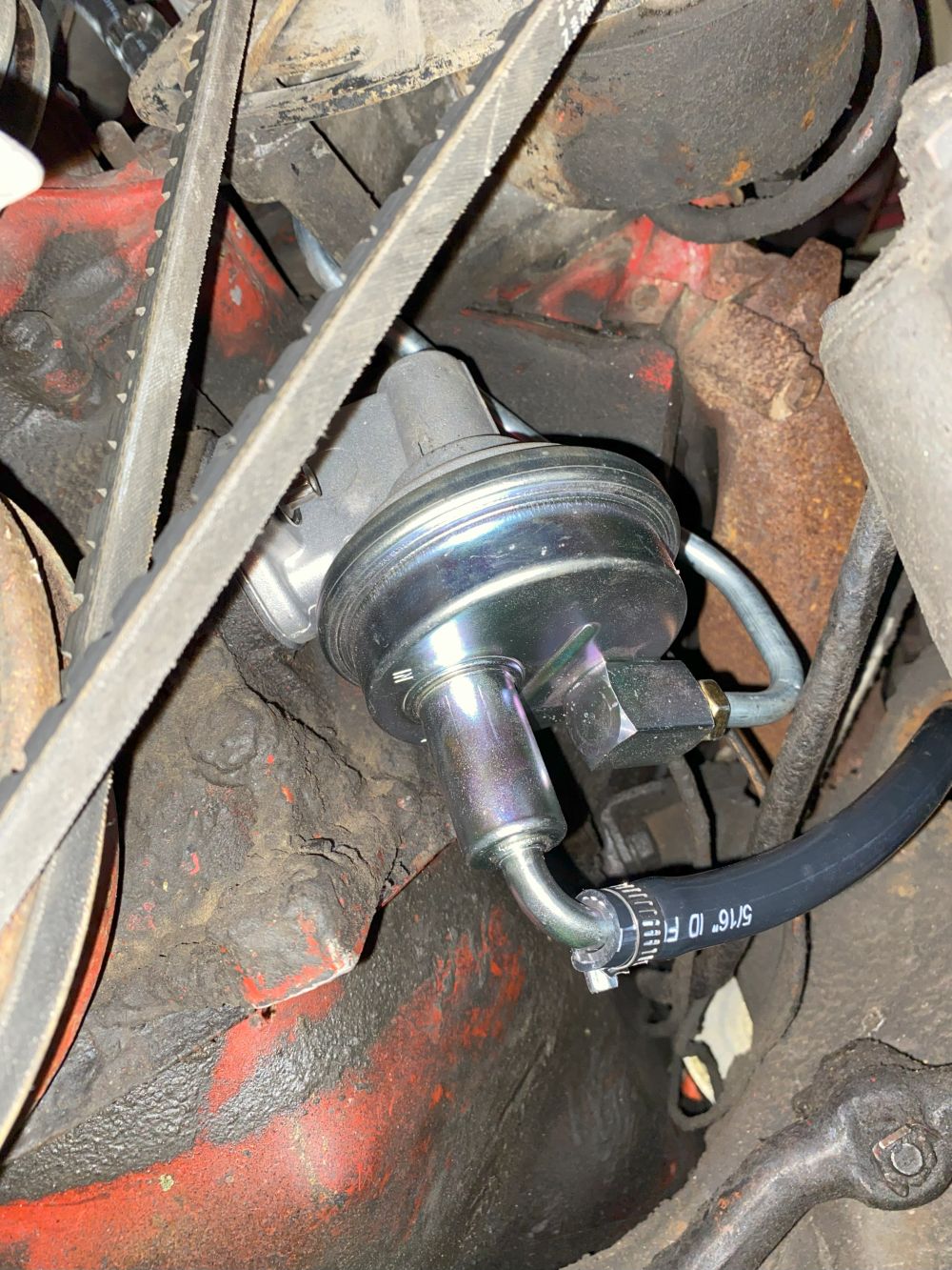

I finished up the fuel system. It took way longer than I expected. I replaced the fuel tank, the fuel line from the tank to the fuel pump, the fuel pump and the line from the pump to the carb. The car started after several cranks/pumps and no leaks!

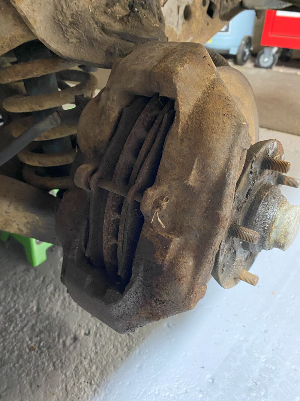

The brakes don't really work at all so I plan an replacing pretty much everything. Disc brakes are not on the PHS docs so I guess someone added them later. Based on the part number on the calipers they appear to be correct for a 67 GTO, along with other models in 1967.

You can get those rebuilt and keep the disc advantage. 4 piston brakes were an option for only 2 years. Quite obvious there is seized piston issues there...inner pad looks almost new and the outer is gone.

I have those brakes on my 67 and they are fantastic. Had them stainless sleeved by Vette Brakes and they work great.

If you elect to keep this added disc brake option on your ‘67 I would SS sleeve everything front to back.
Four piston calipers
Master cylinder
Rear cylinders

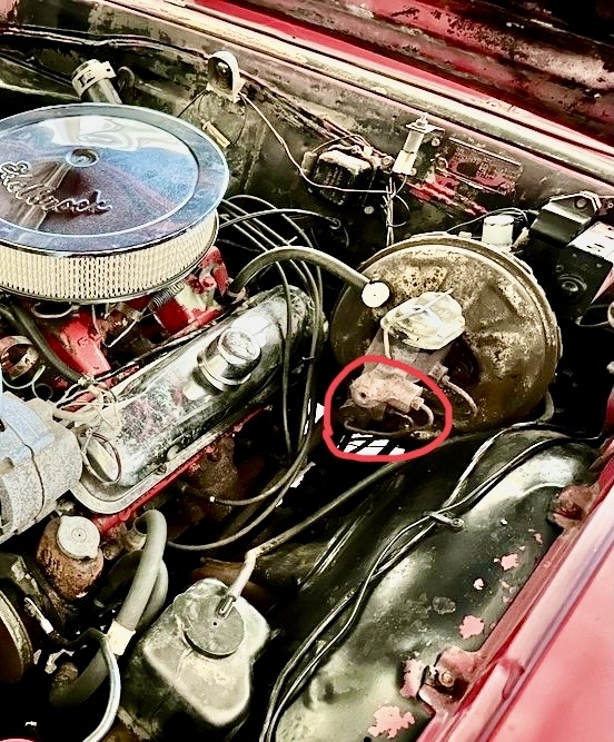

Check the proportioning valve that’s circled in your photo.
The master cylinder is unique to 1967 disc brake as I show in the photo of the ‘67 HO I restored years ago.
BTW, your WT 335 HP has the added HO exhaust manifolds which require a completely different engine wiring harness.
