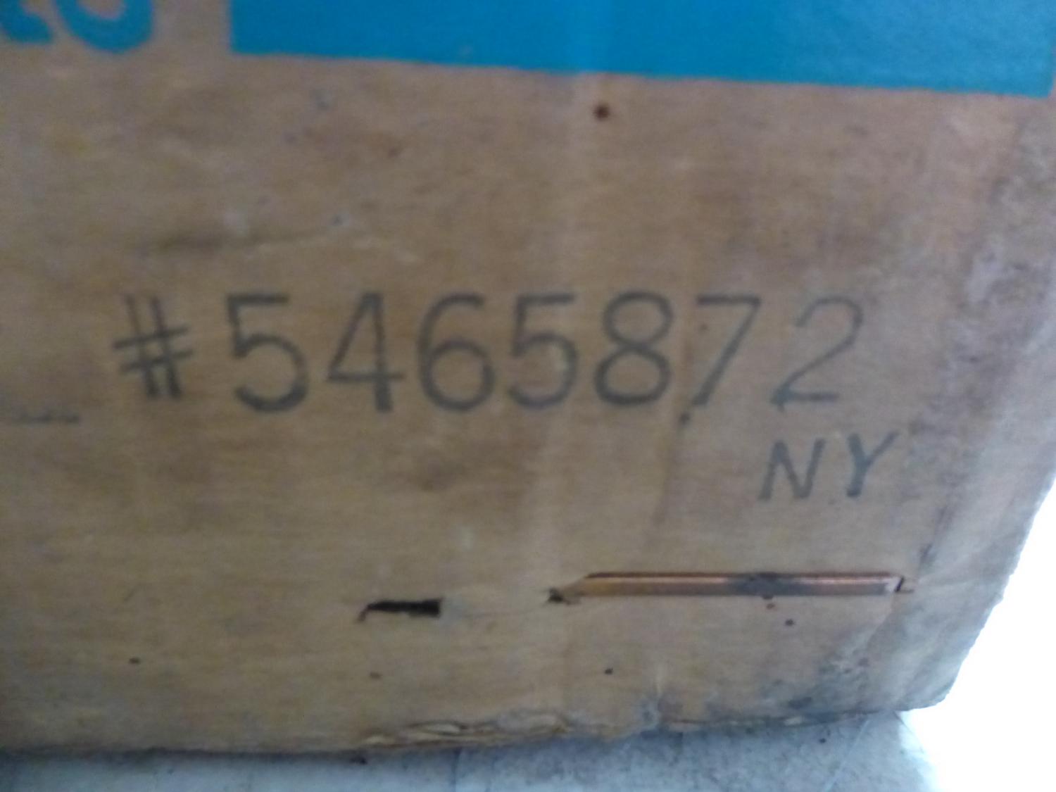

I googled these and the only thing I could find is that they were discontinued in 1981. Any body know what these fit?

Chris,
Just needed to confirm they are fronts? The parts book page shows rear???
Also what model is the Olds VC? Vista Cruiser?

Back then fronts were usually two inches wide; rears 2.5.
Not a hard and fast rule.
Usually the other way around. Such as 2 1/2" front vs 2" rear.

They are 2 1/2
Exactly. That is what my brain said. That isn't what my fat little fingers typed.
If they are 2.5, they are likely fronts.

this sheet Hawkeye posted is the same group as the one I found this morning but the one I found on GM Parts Wiki shows front brakes. Interesting the same group and one clearly shows Front and the other Rears
http://www.gmpartswiki.com/getbigpage?pageid=89594
