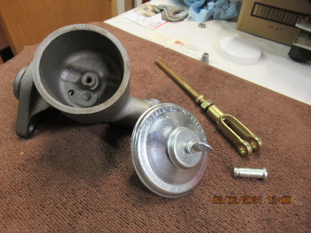

The guy I got the original group of parts from found and restored a correct master cylinder with the correct screw top, so I got that bought today as well.
Making progress.......

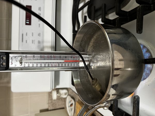

We were down at Mom's for the annual family reunion this weekend and I had some time Sunday morning so I tested the NOS temp gauge I got from Tony this spring. These things run warm as it is and I wanted to be able to keep tabs on it. Given the age of the NOS gauge I thought it prudent to make sure everything was in order prior to installing. Took one of Mom's candy thermometers and boiled some water. Gauge checks out OK. I was able to find a proper bracket from Summit to install - so now I just need to get 'er done.
Was able to take the car for a 20 mile ride and topped of the tank with some fresh fuel.

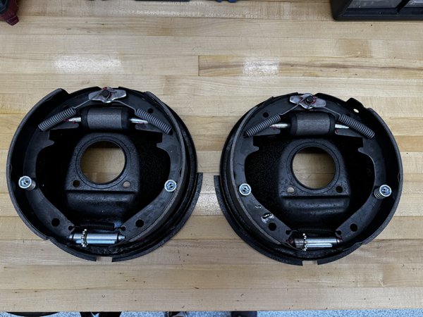

I had some spare time on Saturday afternoon to tinker with mocking up the front drum brake assemblies. Part of my motivation is trying to consolidate my parts pile off the garage floor as I'll soon have to make room for my truck inside as the weather turns colder in the coming weeks.
I found out the backing plates are for self adjusting brakes with no hole for the adjuster on the bottom. I just found and ordered the correct (non-reproduction) backing plates with the shoe adjusting hole. Will need to get those blasted and painted when they arrive.

Do the drums have the hole in them for the adjuster ?
Most self adjusting brakes I've worked on still have a hole in the plate, or drum for manual adjusting too.
