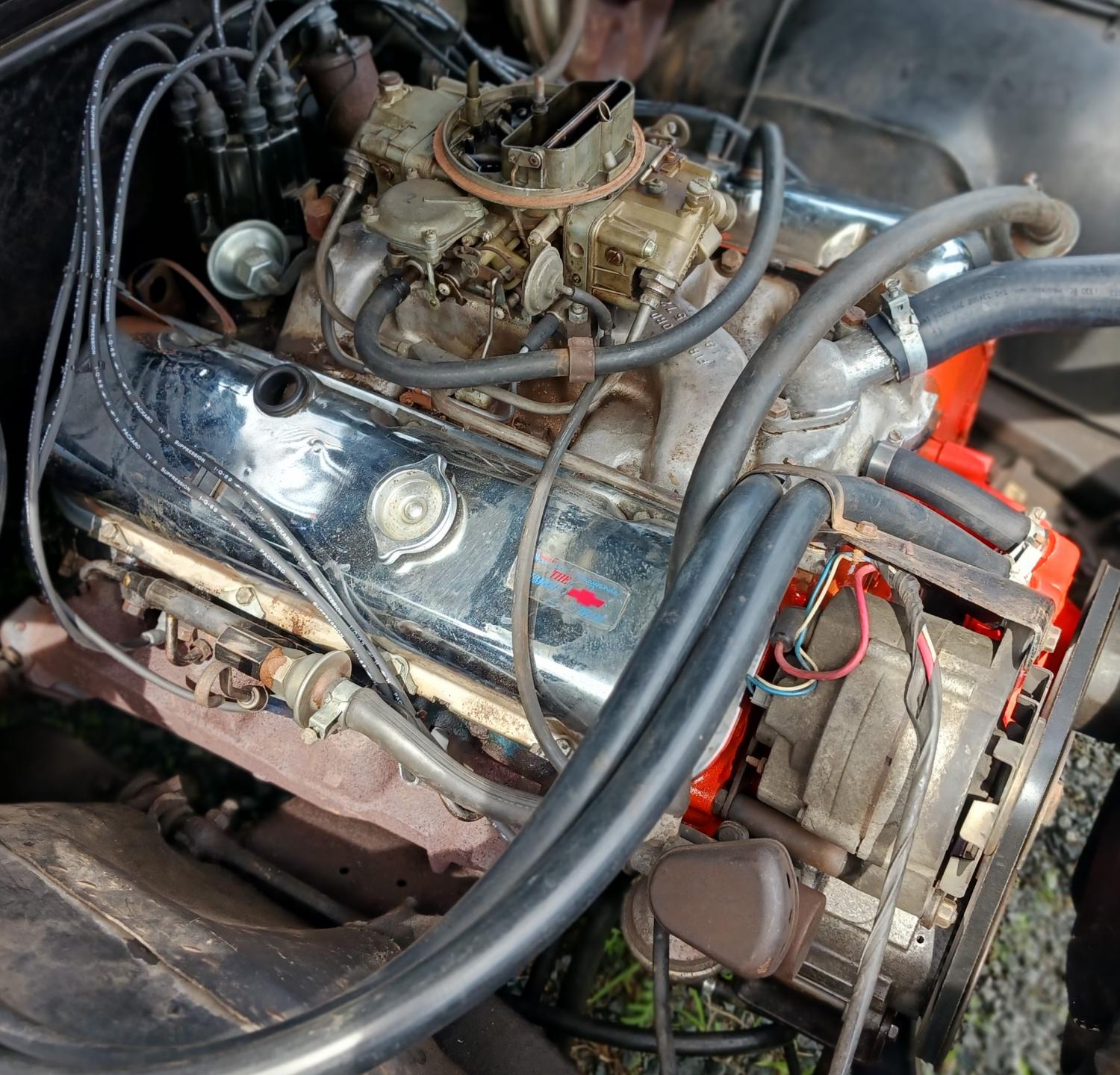

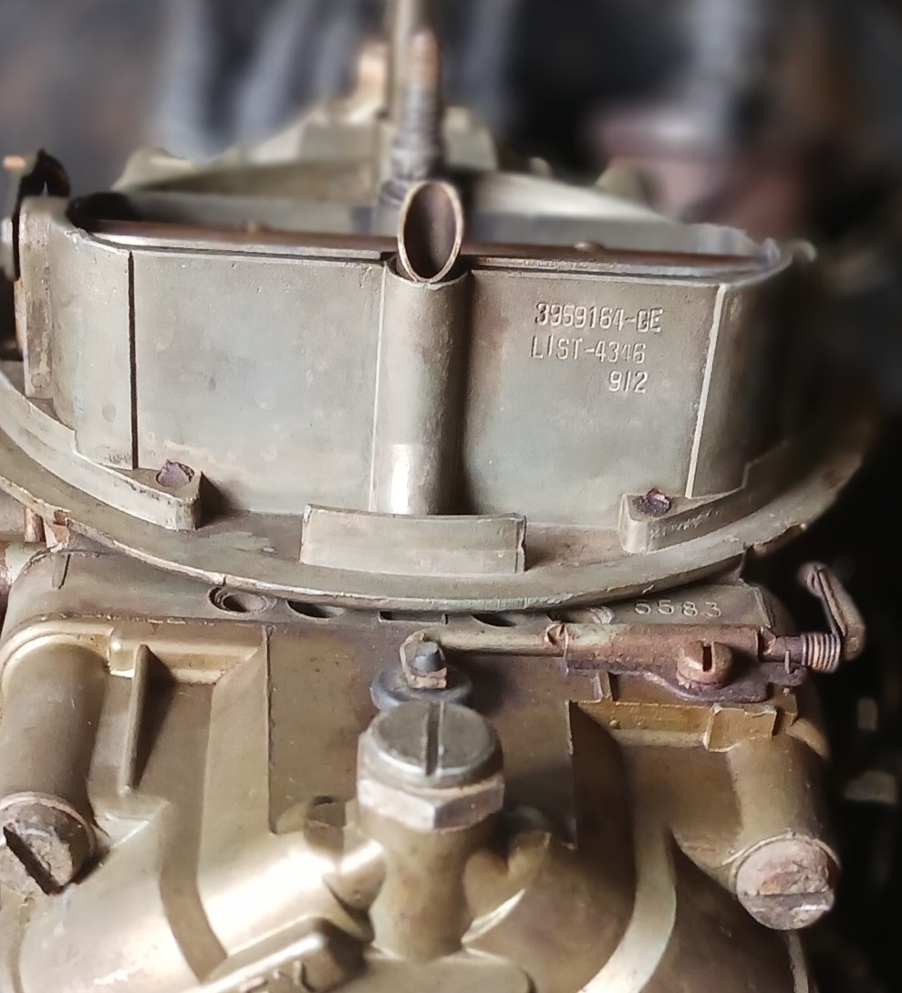

Found this in carb.
Power valves and accelerator pump were STIFF.
Ran but a little sick.
This is how it was when shee bought it.
Test drive was a little shaky.
All good now.
Went down slightly from factory specs on power valves and jets.
All it gets is 110 racing gas and it likes it.
Plug wires are repops.
Working on a NOS set but not complete yet.
Dist not changed yet and smog hoses are 71 in pic.
69 hoses were not on yet.

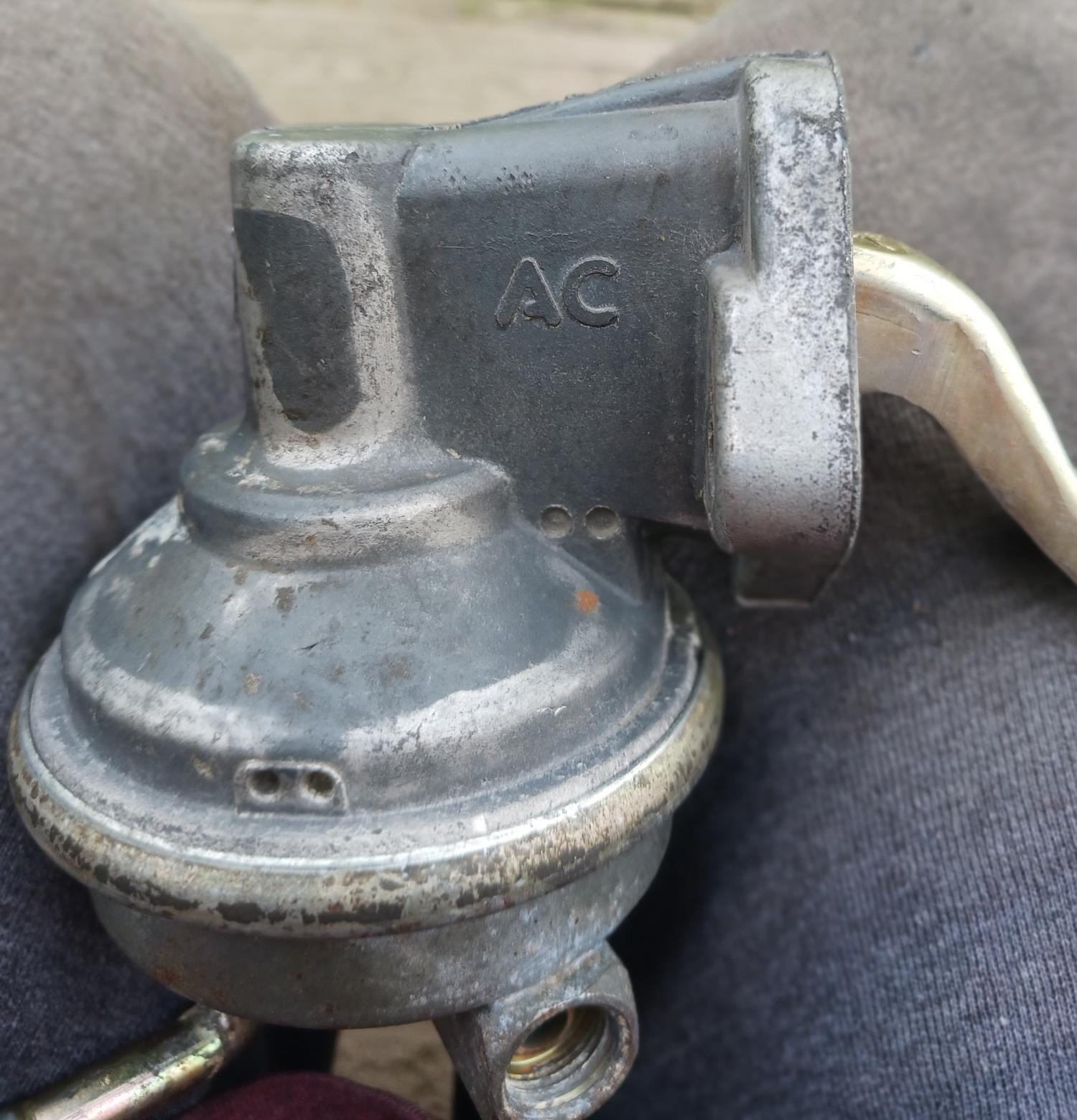

Originally Posted by daveg View Post
Fuel pump off it.
Works but is quite stiff.
Who can rebuild it without making it pretty?
Fred Ballard
661-251-2362
daveg (01-31-2025)

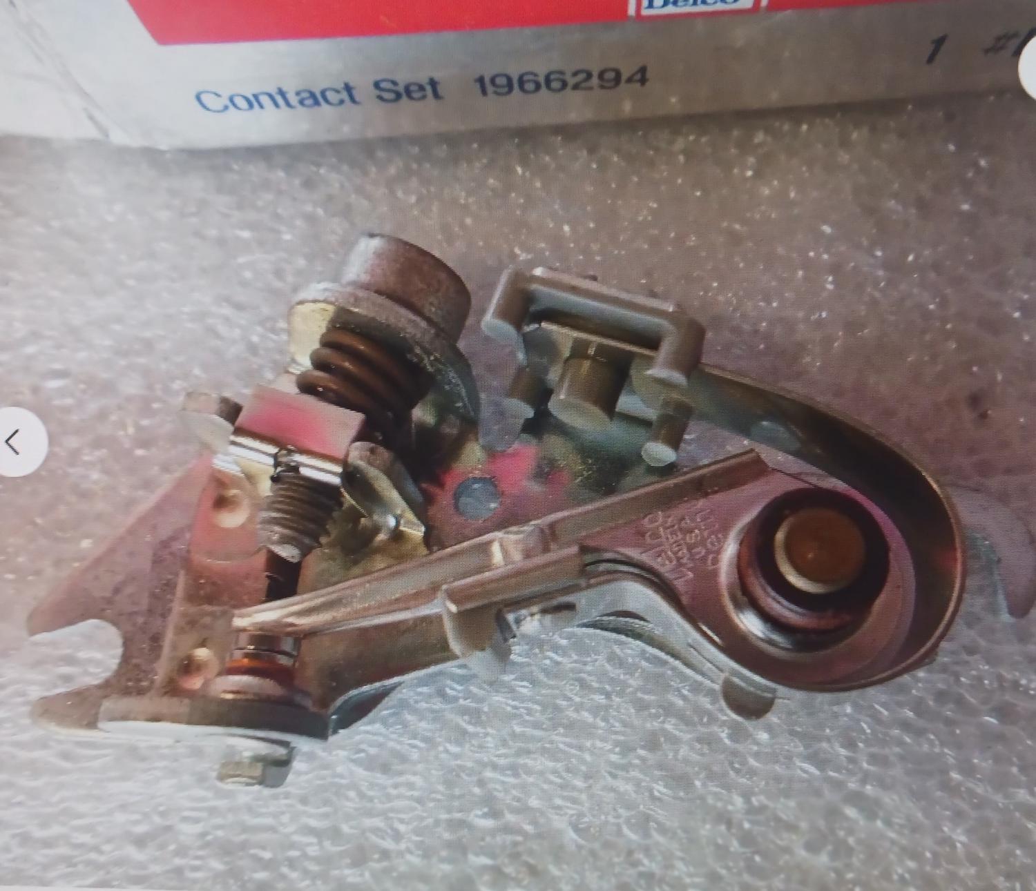

Before pics are here and will post after pics when back.
"Survivor" service is $275.00 with $30.00 return shipping for any interested.
Fred said the return time is quicker on this type rebuild without plating.
Said it should look pretty much the same.
"R" distributor cap cleaned up nice.
Aircraft stripper made short work of the overspray.
Factory points should have the old Delce Remy on top of arm?
Condenser same on end?
May as well get them too.
Info says these points are the stiffer spring ones for HP motors?

Freds handiwork on fuel pump.
Thanks for the heads up.

Looks good to me. Are you pleased with the results? Looks like all the patina is untouched and still looks as original. Can you post a pick if the back where he has to slice it to get the bottom off?
Thanks for sharing.

Here ya go Marty.
Very pleased.
Only pics it will let me post????
