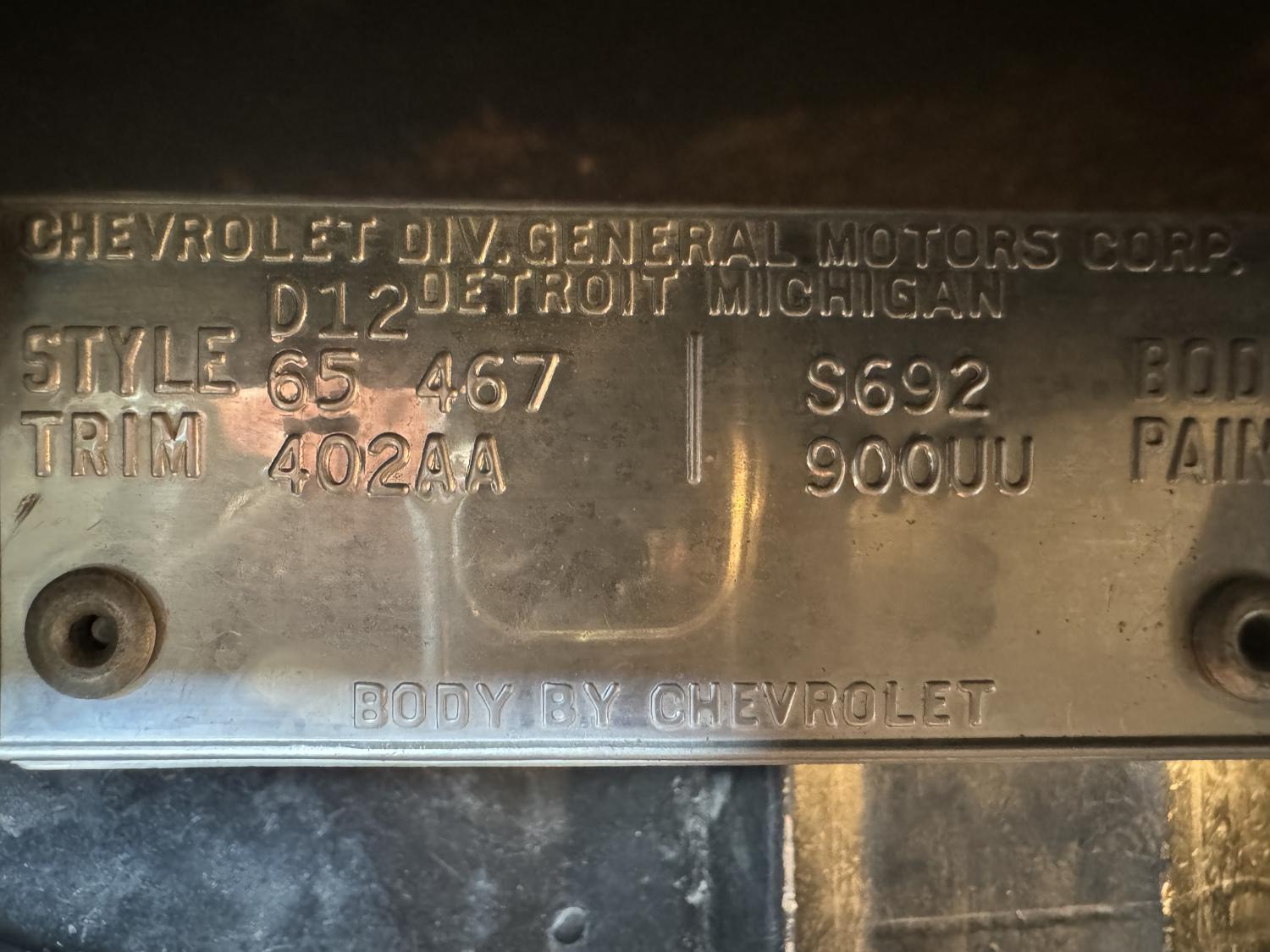

I am looking at the 1965 Trim Tag section of the book by Al Grenning/Roy Sinor. There appears to be several differences between their documented example tag and the tag you posted. The "M" in MOTORS and the "H" in MICHIGAN should vertically line up perfectly on the right side. One more example would be the "D" in BODY, the documented tag has extra flashing(material) on the internal right side of the "D"; the picture of the "D" in your post appears perfectly clean.

The top pic is the tag from my Bowtie / Benchmark 65. Below, is the tag in question. The dates are not that far apart. Study carefully

Paint code 900UU looks like it is climbing uphill in all of the photos posted which looks odd compared to the others I’ve seen.

Cousin Paul's March St Louis coupe.

Rivets look different.
