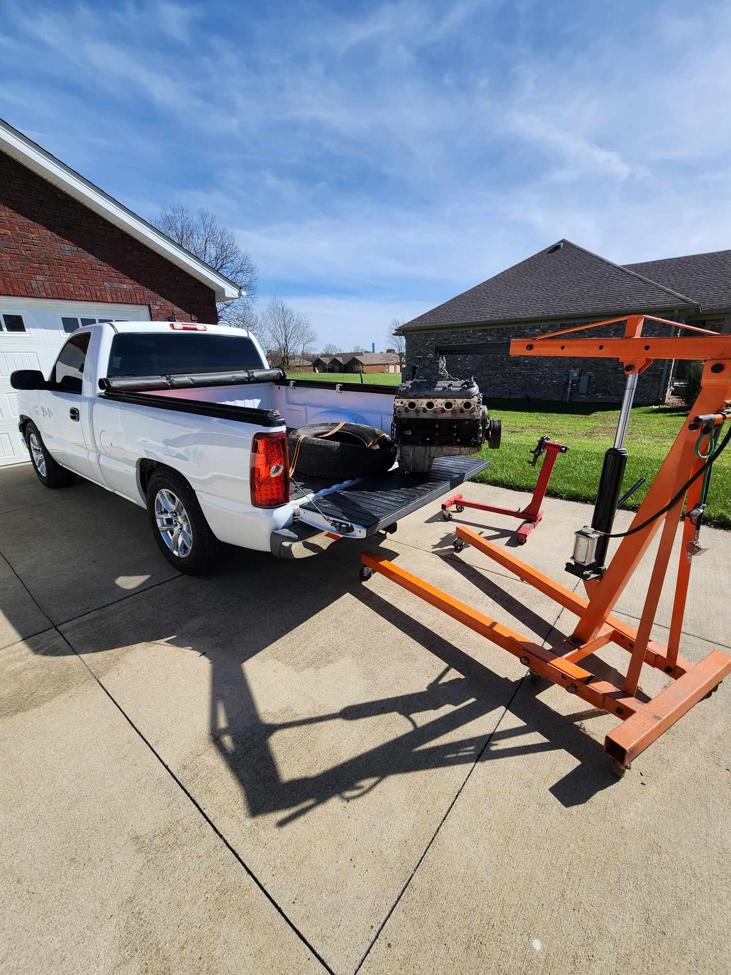

Here he is unloading the engine after we brought it home and before assessing the parts .

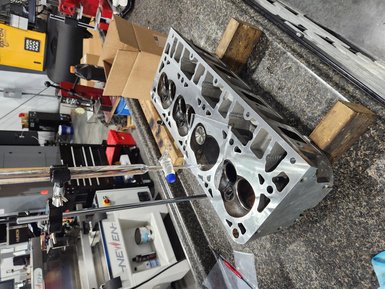

Next up we added some true Hollow stem LS3 intake valves and Ferrea Exhaust valves as wel as a quick lap in to make sure everything seats well.
Then the heads were CC'd to check chamber size, and consequently milled .040" .
Along with a .045 gasket and 61.5 CC chamber we set the compression at 10.75-1

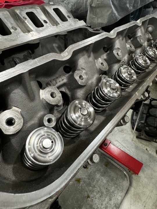

Here ha has all the fancy OEM rotating assy parts cleaned and fresh out of the jet wash tank .
Also had him assemble the heads using our .660 lift dual spring kit w Titanium retainers in preparation for the soon to come new higher rpm camshaft.

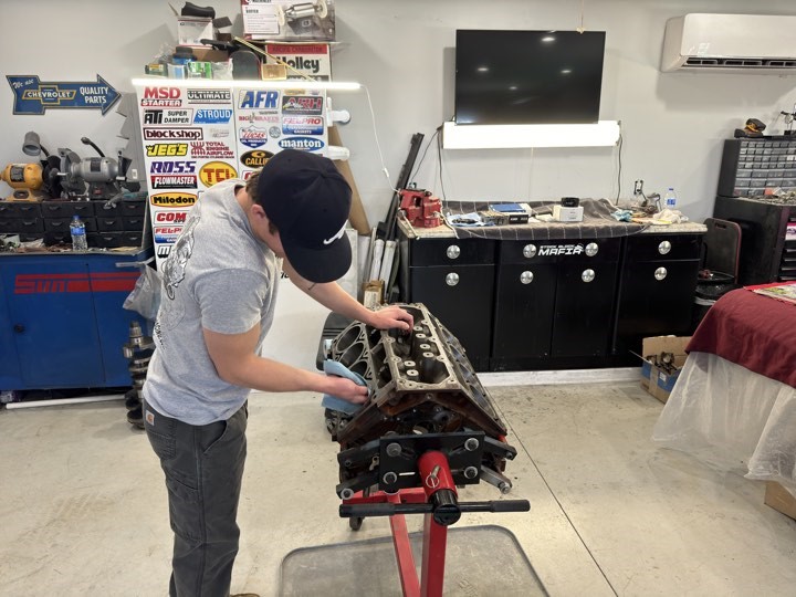

Time to build and engine .
We 1st checked all the clearances ( although nothing needed tweaked thanks to GM doing the work for us
The freshly machined block being delivered home .. lol
Here Alex is final cleaning the cylinders one last time .
