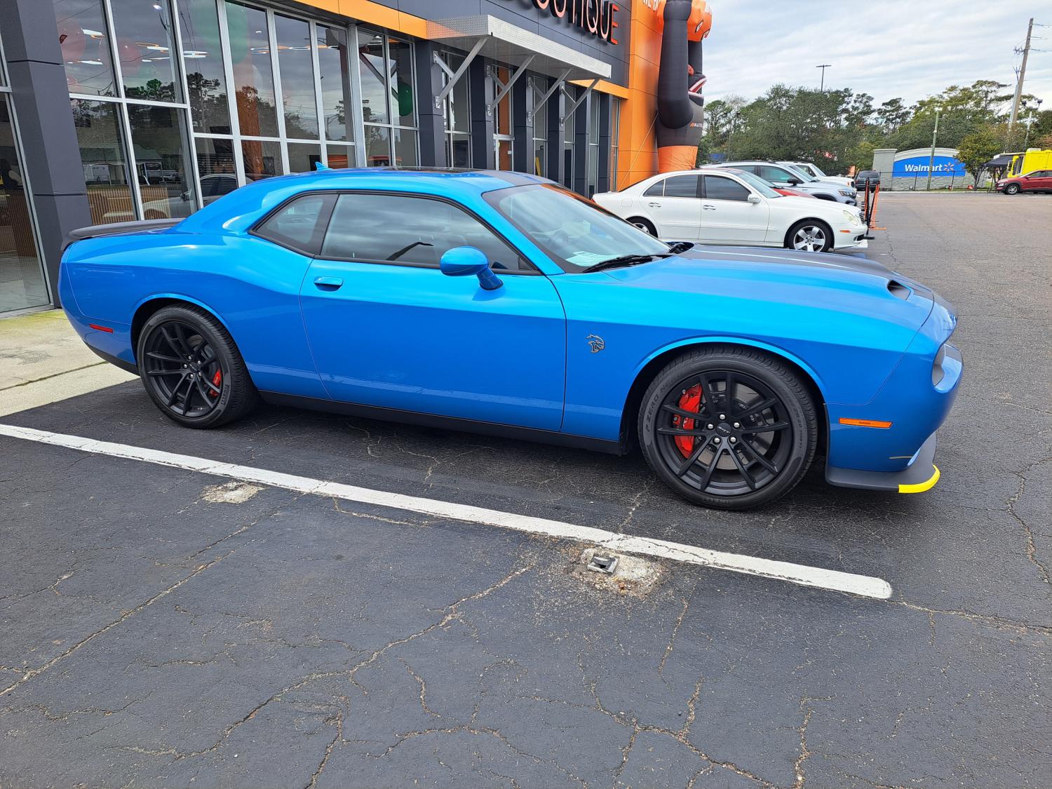

A few days ago I went on a 2 1/2 day road trip to look at a few 2022 and 2023 Challenger Hellcats that I found for sale online. I looked at 9 cars in South Carolina and northeast Florida. I was up front will all of the dealers and told them I was going to look at all of the cars on my list before making a decision. Of the 9 there were 3 that I would even think about buying, a 2022 and 2 2023s. These were all low mile cars. The one I liked the most was at a high end car dealer in Jacksonville Florida. It was the 5th one I looked at. They are one of the "No Haggle" dealerships. They gave me their price and I left to go look at the others. I wasn't interested in any of them so I went back to test their No Haggle policy. It took a little while but I got them down $2400 and they agreed to deliver the car almost 400 miles away for free. We finalized everything Friday at around 1:30. As I was leaving the dealership to drive back home, they were loading the car to be delivered. It was delivered 11:30 this morning.
It is a 2023 Challenger Hellcat Jailbreak with 290 miles. It has 366 now.

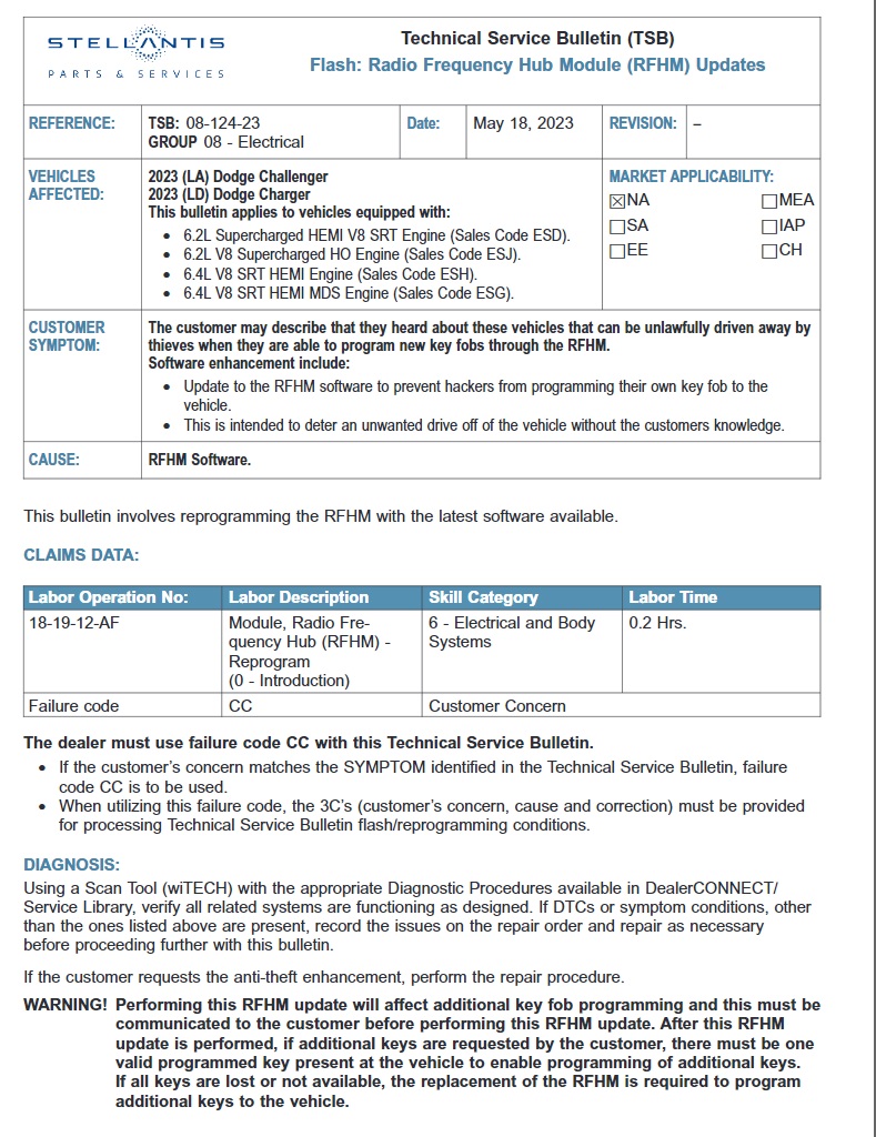

One more thing. ABSOLUTELY get the dealer to perform the RFHM lockout. This is a TSB that is covered under warranty to prevent a thief from programming a new set of keys in a matter of seconds and driving off in the car. This is how the majority of them are stolen. And bring them all your keyfobs when you get it done. (2 red, 1 black). Don't let the dealer tell you it was "done already at the factory". That is BS. They have a special form you have to sign that says you are aware that once the lockout is done, no new keys can be produced without replacing the RFHM module itself on your own dime.
Also, And immediately buy the Faraday pouches for stopping the keyfobs from sending the signal out to the car 24/7 - another thing the thieves can intercept and make a new fob from. And test the pouches before you rely on them. Put the keyfob in the pouch and then get in the car and try to start it. If the car starts, the pouch is bad. And furthermore...place the keyfobs and pouches somewhere inside your house (a metal safe is best) and not hanging on a hook by the front door. (Another theft method is they walk around your house/garage with a modified receiver to pick up the keyfob signal from the typical homeowner who hangs his keyfobs by the back door.

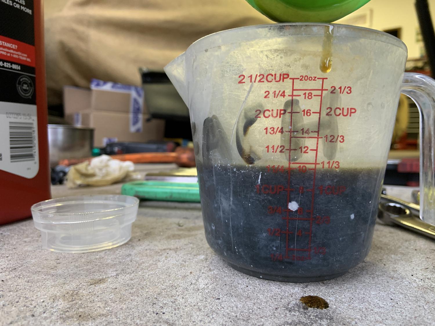

But, wait, there's more! Change the oil now. It takes exactly 7 quarts of the 0w40 Pennzoil Platinum Ultra (the only oil they recommend and will give you $%^& if there is ever a warranty claim and you used different oil) I bring this up because the factory overfilled the engines by close to a quart and the drain plug on the oil cooler is always loose. There was a TSB on replacing that drain plug because the rubber O-ring seals were too soft.

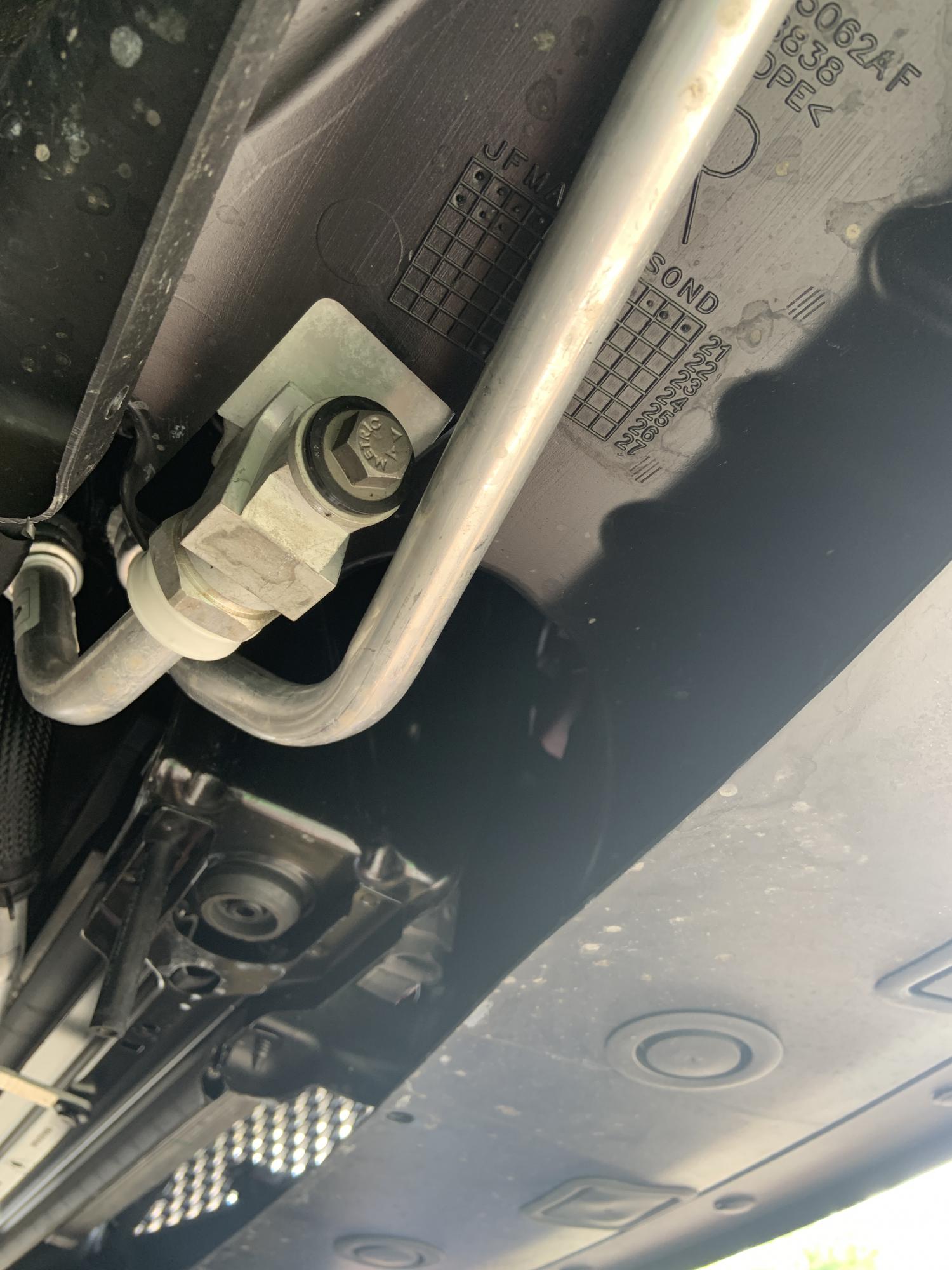

And yes there are 2 oil drain plugs on these cars. One on the pan and one on the oil cooler near the bottom of the passenger front fender. You have to remove most of the underbody shields to get to it. The dealers either don't bother or don't know it's there and leave half a quart of dirty oil in the cooler and lines when they ignore it...and then they dump too much oil in thinking it was drained. But it is critical to check the tightness of that cooler plug. Mine was finger tight and about to fall out when I changed the oil at 500 miles.
Here's how much is in that cooler after an hour of draining. Second photo is of the actual cooler drain plug
