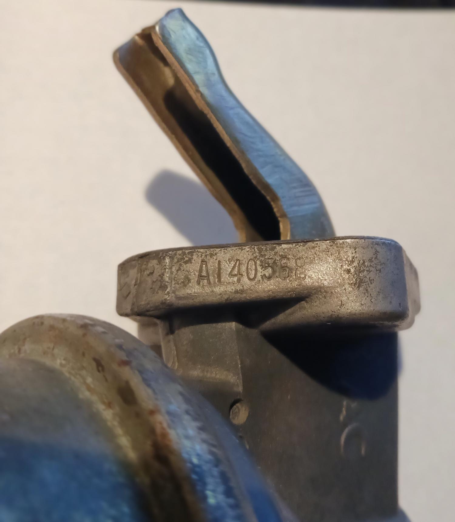

Can someone help me read the date on this fuel pump.
Attachments - The Supercar Registry IMG_1712.jpg FP5.jpg FP2.jpg fp14date.jpg

No idea what that is.
Pic is Jan 69 off a 3rd week of Feb Baltimore built L78 4spd.

136th day of 1980. The earliest 40727 was Oct 1969 found in a 1970 model year car. The 40568 was used on all 396 engines in 1969...Joe

Is the 568 pump for sale?

Should have made it clear it is not for sale..
It is reference only and we had it rebuilt.
It is the factory pump off her 69 L78 "OLE BLUE".
