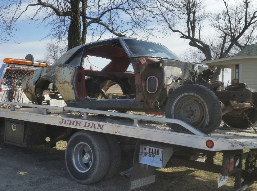

That picture on the flatbed really shows what you started with..wow!
Hey but the trim around the windows was really nice.....
That was after some disassembly when it was heading to the chassis shop to get new rear frame rails and trunk floor. It had been modified with narrow 2x3 square tube rails. Then that effort failed miserably with respect to dimensions (the rails were 2-3/8" too close together and all the gaps were finger painted with seam sealer) and I took it back from the body shop and started over. After the new floors, rails and quarters were installed on a proper frame jig by Jube Mayes at The Installation Center in Georgia, all I've subbed out is the brake calipers and master/booster restorations, boring and balancing the shortblock and some minor head porting.

That will be absolutely stunning when done.
Can’t believe someone could screw up frame rails to that degree. Whew.
