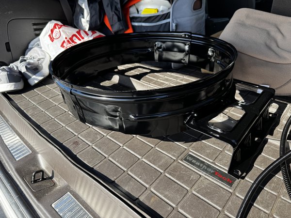

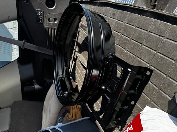

I picked up the fan shroud yesterday from the painter - he will have the air cleaner finished up later this week as he wasn't happy with how it turned out and needs a bit more time to get it right. Happy I did this as it will bring the engine compartment a long way for the minimal investment. Turned out better than I could do at home......

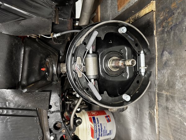

I was able to get the drivers side brake lines wrapped up last night - I needed to remove the generator to get some access from above and then work from underneath the car to install the distribution block bolt to the frame. Got everything lined up and tight. I also installed the backing plates and shoe assemblies on both sides. When I went to slide the hub assemblies on the spindle I found out the inside bearing I bought was a touch too small diameter and would not go on the spindle. Luckily I saved the original bearings from the hubs after I disassembled them and those bearings fit. I threw everything in my truck and will swing by NAPA to see if we can source the correct inside bearing and a new seal. The old ones actually look good if I need to re-use them. Outside ones are the correct size.
I took some pictures of the assemblies installed along with the new outside mirror and the better aligned exterior door handles and cleaned up arm rest and inside door handle chrome. Slowly but surely making progress.

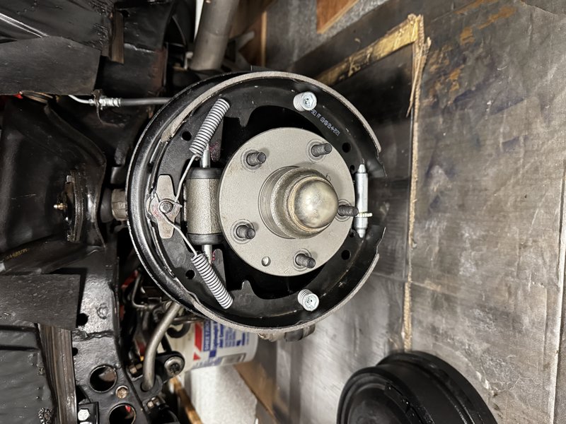

Got the hub assembly and drums put on - the bearing issue was not an issue - my bad.
Did a preliminary adjustment on the shoes - I will have to tweak this I'm sure. One of the things I did was to source and restore a pair of correct (I think) backing plates that had the proper adjusting hole in them vs. the pair that came with the parts I bought that did not have them. I filled the master cylinder with fluid, made sure the master cylinder pushrod was adjusted to the shortest throw possible (so as not to have the plunger engaged and prohibit the flow of fluid) and waited for it to gravity bleed....and waited........and waited.......and waited some more. I was having flashbacks of my issues with the Chevelle brakes a few years ago. This is a much simpler system with no proportioning valve and a single circuit master that goes one way from the LF and around to the RF and then to the rear. Still no fluid as of now, the master is working as I cracked the fitting at the main line and pushed the pedal down and fluid came out........so not quite sure what is happening there.

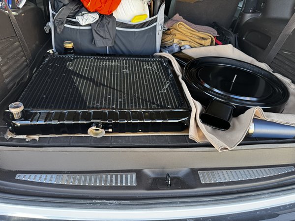

I picked up the balance of the parts being painted this morning so tonight the re-assembly begins.......
