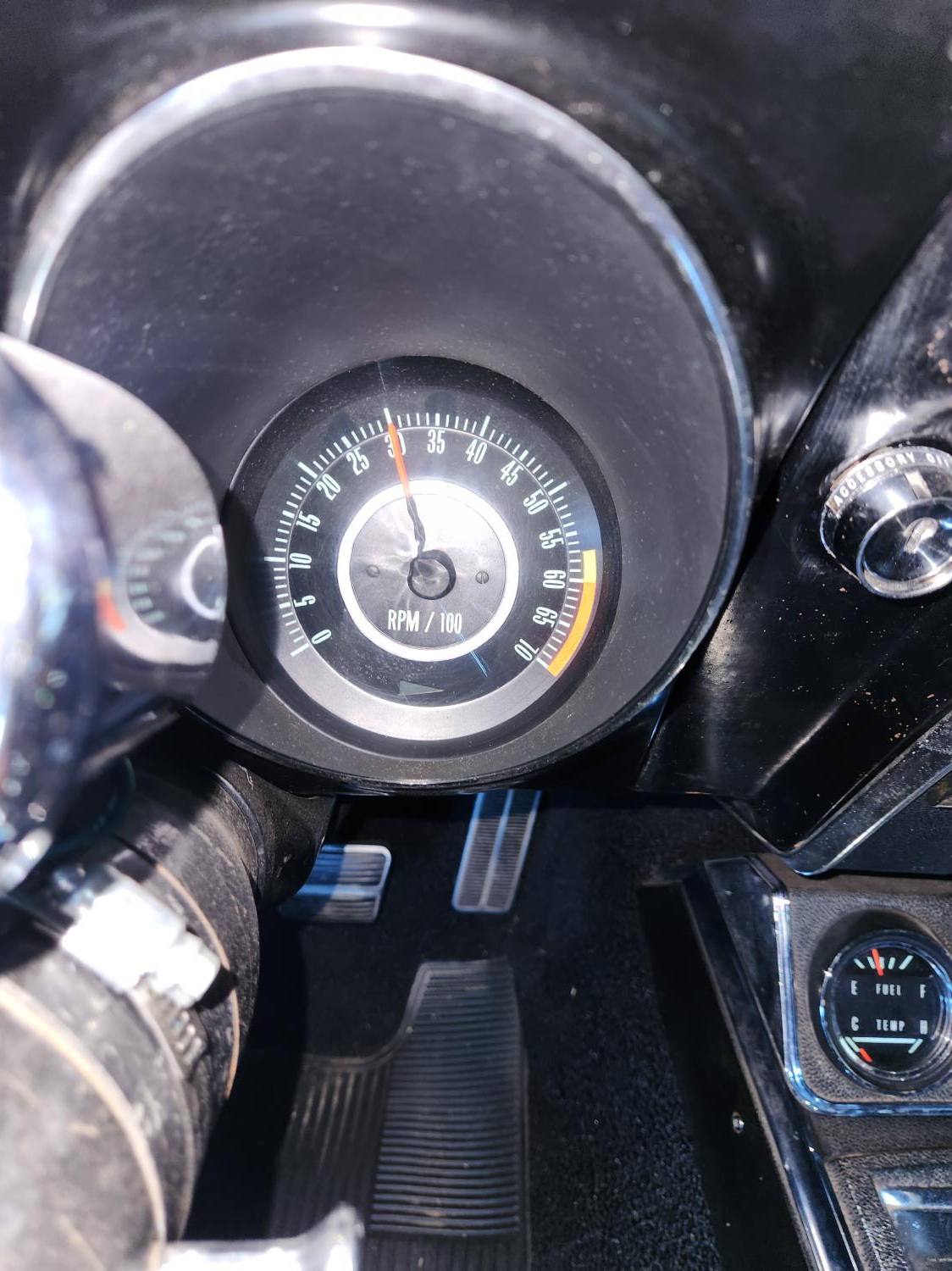

Finally got around to adjusting the tach. I removed the driver seat, laid on my back with my head/arm behind the dash. With a small screwdriver I adjusted the tach and this is best I could get it. From idle to 2000rpm it reads around 150-200rpm too high but from 2000-7000rpm it's dead on. Prior to adjustment, when I was cruising at 2800rpm the tach would read around 3500rpm. The tach photo is when receiving a 3000rpm signal.

How were you able to adjust the tach needle?
Jason's advice and photo from post 270:
Originally Posted by SuperNovaSS View Post
There is a potentiometer on the back of the tach behind this sticker to adjust the rpm reading. Just be careful, the potentiometer can be fragile after all these decades.
Jason
I used a very small flathead screwdriver and with the power off I ever so slightly turned the what I'm assuming is the potentiometer screw counter clockwise. I retested and repeated until it was accurate to my liking. I read that it's possible to cause a short if the screwdriver touches the housing during adjustment which is why I did mine with the power off. It was tricky and I couldn't even see inside the opening for the potentiometer but I as I gently turned the screwdriver with the tips of my fingers I waited for it to fall into the slot, Once in the slot I felt a resistance as I turned the screwdriver. Luckily it only needed 2 adjustments. After adjustment I replaced the painters tape that I used to cover the hole.
With all of that said the tach needle itself when the car is off rests about 100-200rpm too high, but since my readings were accurate from 2000-7000rpm after adjustment it was fine by me.

Jose,
Did the tach always “zero”
At 100-200 or was that after the adjustment. Moving the potentiometer shouldn’t affect the zero reading.
Jose,
I love the chrome line lock button. Fancy!
Jason
To clarify the tach never did rest at zero. The adjustment did not alter the resting position but it did make a huge improvement in the overall accuracy of the tach. Here is a photo of the tach off/zero rpm.
