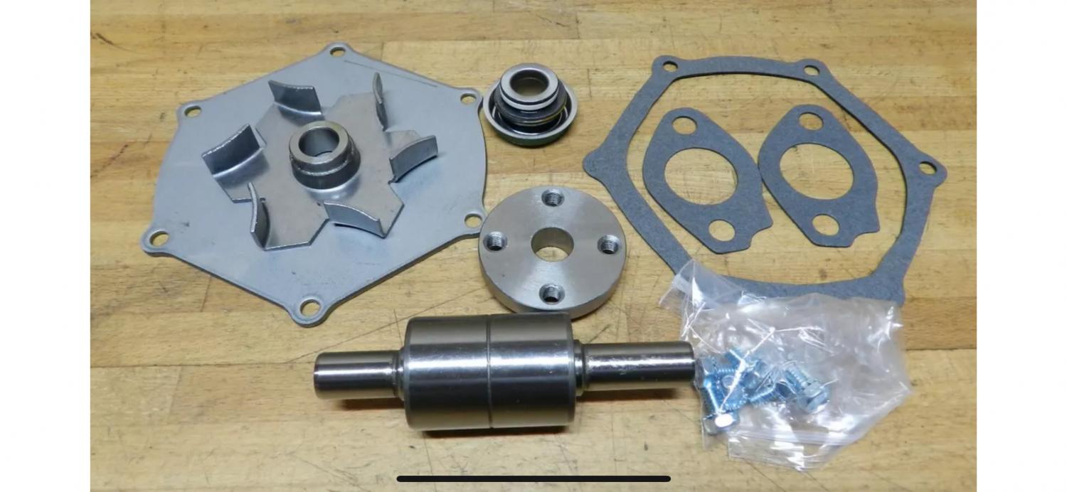

Update. I have a GM aluminum water pump due here this week. I received the rebuild kit from 2ndGenAutoParts. I also got their 3D printed special tool to install the bearing to the shaft.
https://2ndgenautoparts.com
Ignore the hub in attached photo - they substituted the correct 8-hole hub in my kit.
Any best practices for cleaning up the aluminum pump?
