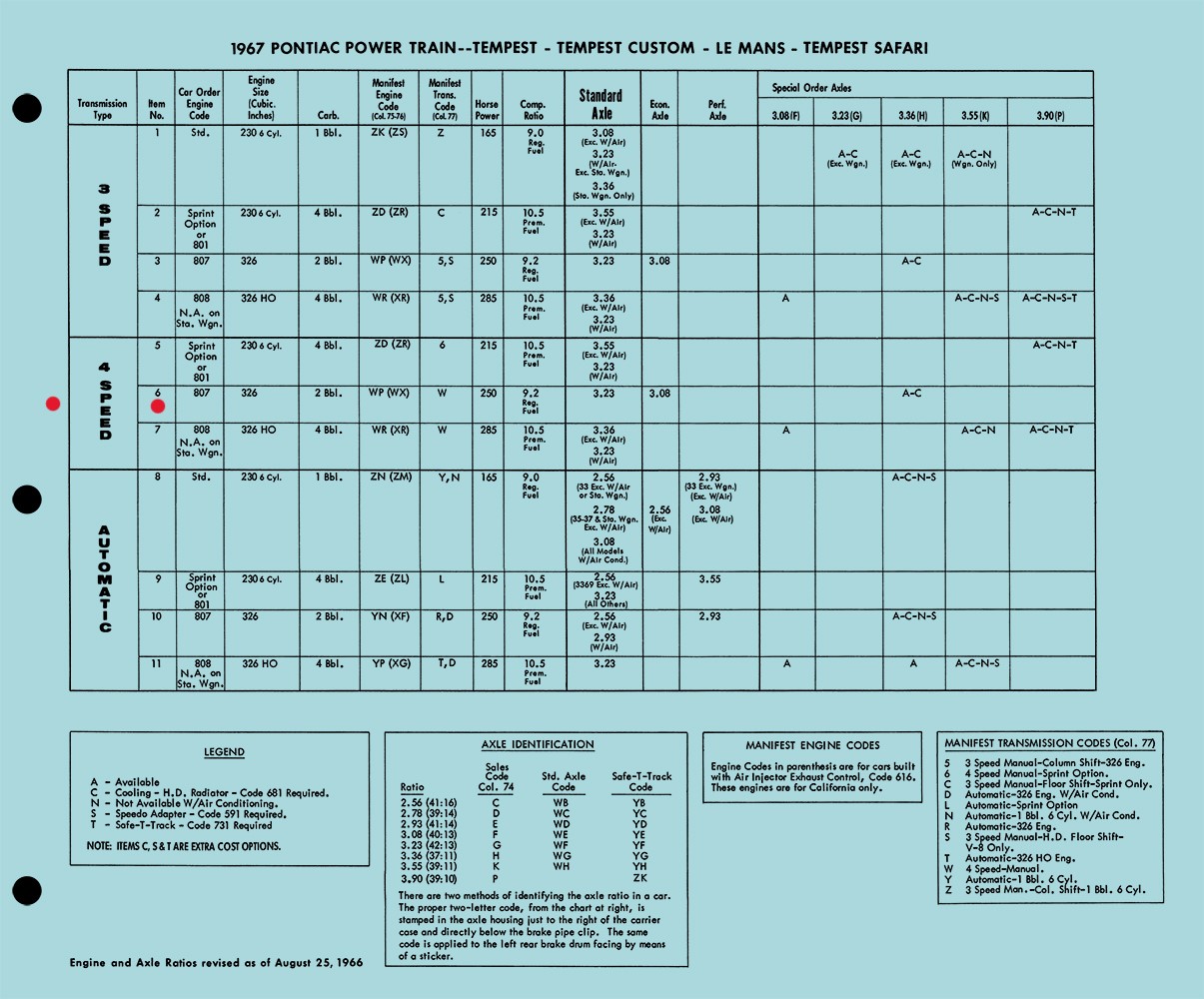

Picked up a Muncie 4 speed over the weekend and the guy said it was from a 67 Lemans with a 326 2 barrel. It still had the tag on the side cover and from research it comes back as 67 GTO wide ratio. Was the 326 available with the Muncie 4 speed? I know in the Chevelles that the base V8 got a saginaw 4 speed but not sure on Pontiac.
Yes, also available in the LeMans, same M20 wide ratio transmission as GTO.

So they did use the term “Power Train” (Engine, Transmission, Axle). WDYK …..
