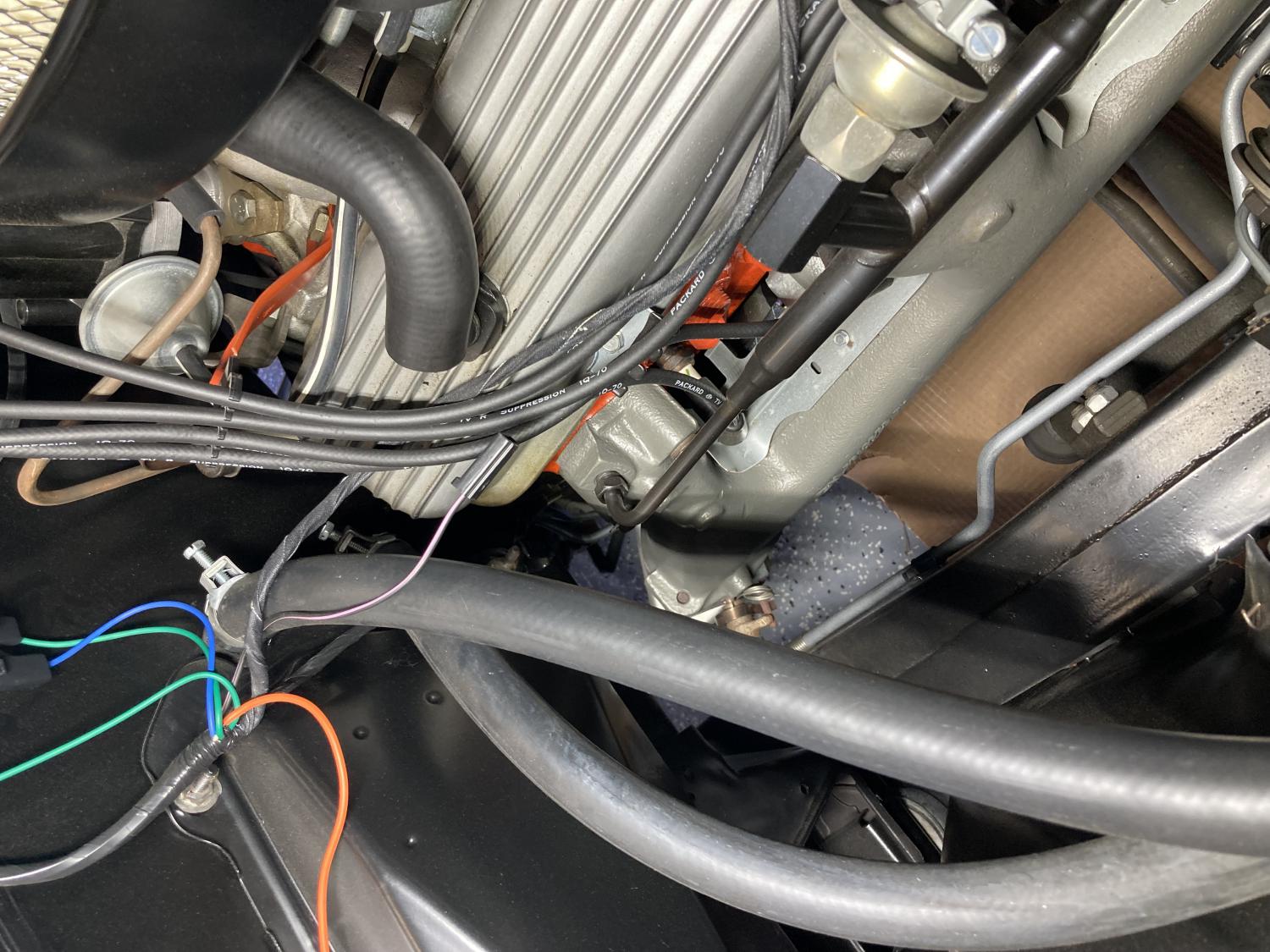

I have a wire on the passenger side off the firewall on the passenger side that has a connector on it but I cannot find another wire nor connector to attach it to. Here is a pic.

The purple wire?

Purple and black-think it might be for TCS.

That goes with the green and blue wire to the TCS solenoid on the remaining terminal.

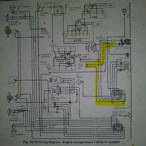

Good day, Caljim that wire seems to attach to the idle stop solenoid and another separate wire from idle stop solenoid back to the tcs on the gutter rail, as highlighted on schematic. Nice nova duece.

Pretty sure one of the wires goes to a temp. sending unit in the cylinder head...that is how they are on the BB cars.
