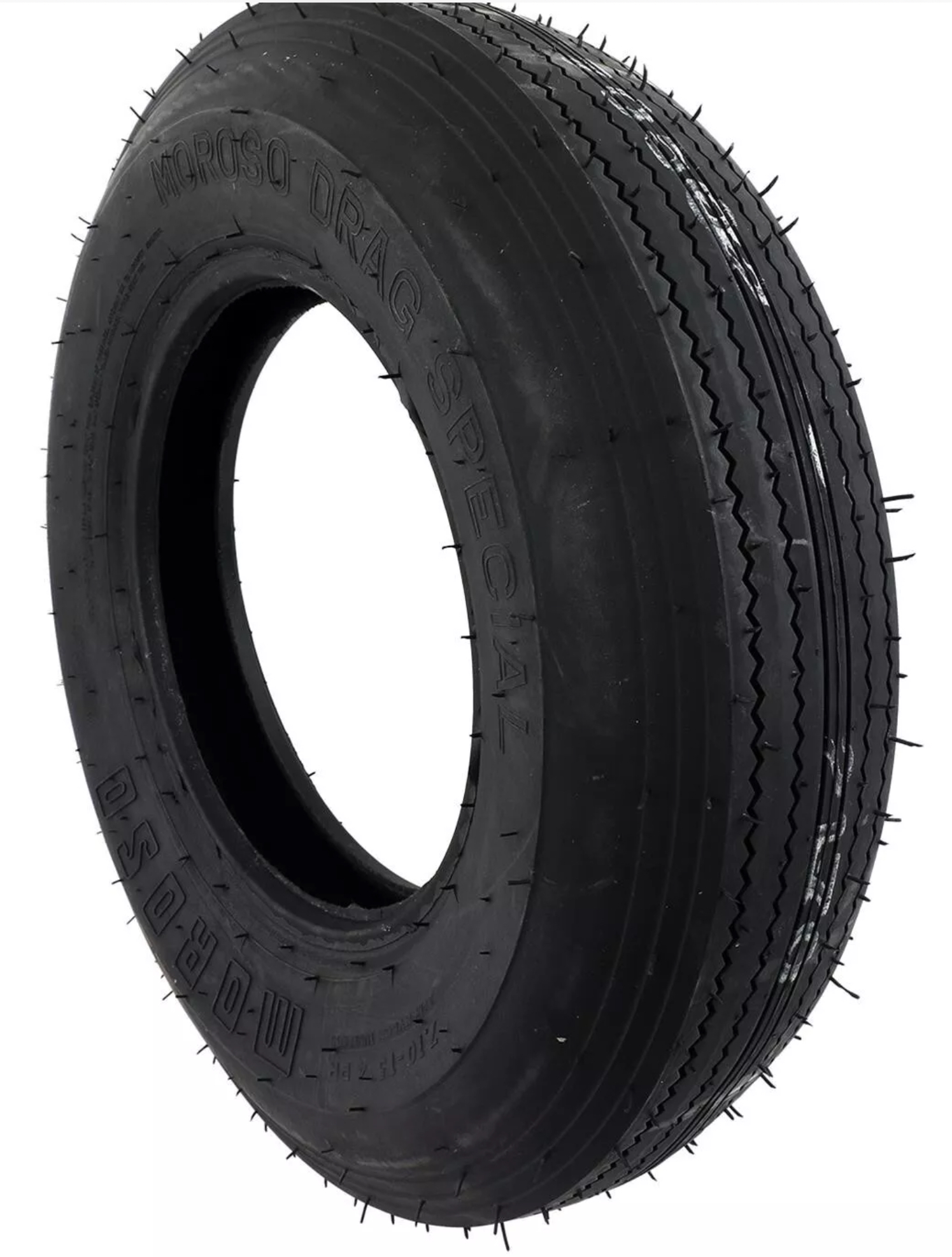

I’m running bias ply on all four corners…..if you’re trying to go for “The look”, that’s the only way to go as radials don’t look right.
My combination is 15x4 Cragars-Moroso Drag Special in the front with 15x8-M&H Racemaster in the rear. I’m not positive on the basckspace for the fronts but I don’t think there were a lot of options. The car drives fine except on wide cracks/seams in the road……I have manual steering which helps…..IMO
With that being said, the fronts are not DOT approved but the rear are……I have driven my car a lot like that since 2009 and never been questioned on them. But……if you’re going for plan on using a 4” wide wheel…..I’m assuming that’s not DOT approved either…….?

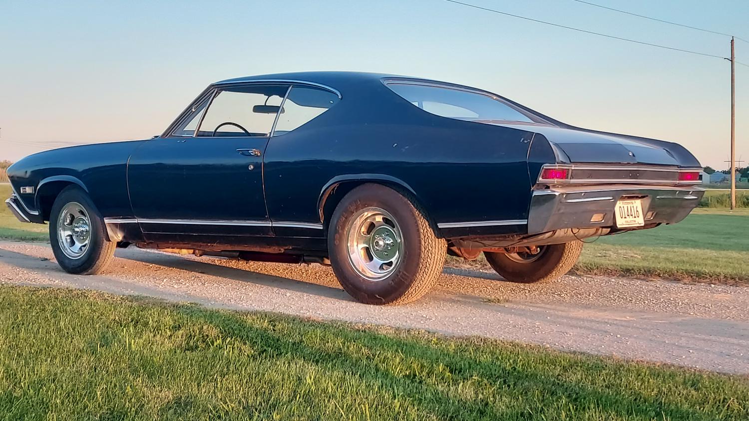

Originally Posted by GaryC View Post
What backspacing are y'all using? I've read 2" on up. The skinnies I plan on using are 1 1/2" BS. If I go bias ply the tire shouldn't balloon like the radial tire if what I'm reading online is correct
The ones on my '68 Chevelle are 5" with 2.5" backspace, so the extra inch is all to the inside compared to yours.
I can't imagine you'd have any fitment problems with the backspace. I've actually been considering putting a 1/2" spacer on mine just to move them outboard a little to match up to the rears a little better. From some angles, they look like they sit way in the fender opening.

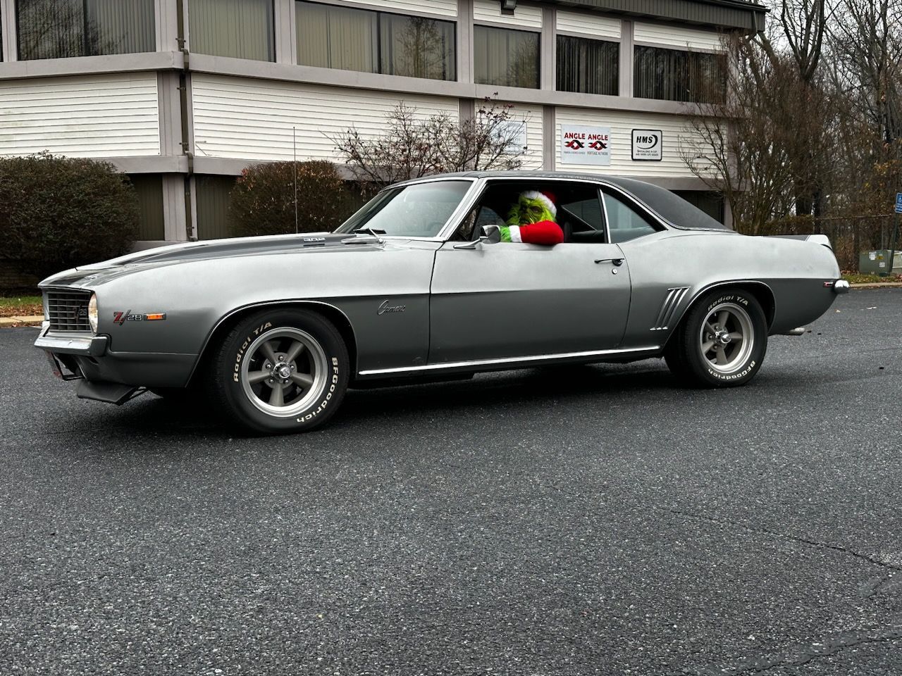

That's why I'm asking the BS question. How far OUTSIDE is too far? There are a lot of tires out there and I have noted from 165/80, 165/70, 195/75, 205/70, 205/65, 205/75 and some of the tires y'all mentioned.
Curious what the tallest would be for the 69 Camaro at the front well. My car is already low, Z28, with 235/60/R15 with 15x7 Vintage Wheel Works V40 version of TT II's and they fill the wells good. I'm ready to go for a different look. Going day two. I want to go with a 15x8 rally 4.50 BS and something that will fit for the rear. The rear tires are a no brainer L60 or 275R. Sure seems to be a 50/50 thing with who is running what tire.
