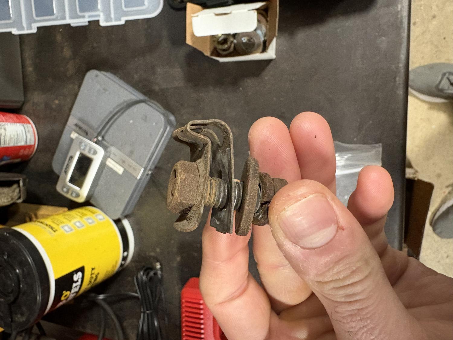

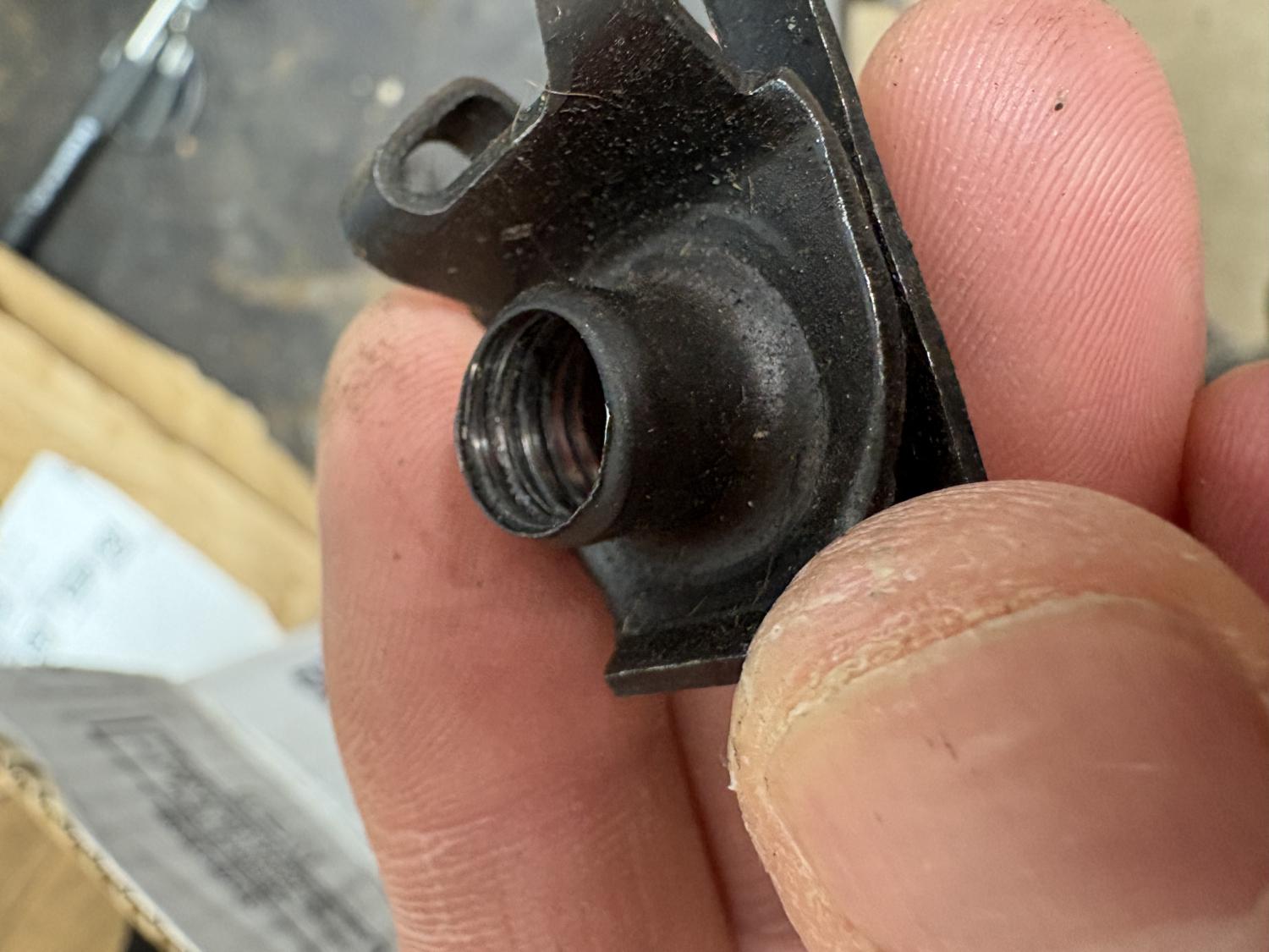

For the Sake of discussions. What is the wrench size on the nut flats and then the threads sizing. I wonder if the replacements are inferior to the Orig design? & can a Guy take Cone style and TIG weld a appropriate sized Jam nut in place for a working option.
I cross threaded one of my Origs as the "J" part of the nut was 'Sprung' which lead to miss alignment of the starting thread and caused a problem that I quickly corrected by NOT forcing it and removed and tapped it out and was really careful starting the bolt again.

Clamp the break closed, v groove and weld it. Grind, hand file to finish.
Welding would the same as a butt, small tack and cool between welds until complete. Blast cabinet with medium coarse media and low pressure to give the repair a slight texture.

Here in WI, the nuts break off the clip. The cone style is far better.

9/16 hex.

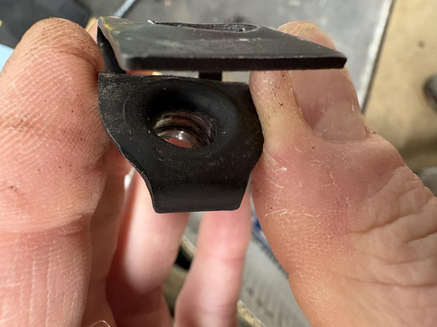

This is the result leading me to go back the OEM route with factory j clips.
3 of these clips stripped out way before I could even torque to spec. All by hand. I wouldn’t trust these.

well that def is a problem, wonder if different manufactures of these are the problem?
I like the orig style and would probably do a spot weld on each nut to be sure they don't break loose.

What torque are you using.
