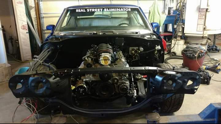

After all the fab work and paint was done, I made some steady progress on reassembly for a little while, but then hit a wall again when it came to wiring and plumbing. I don't enjoy that type of work, and couldn't stay motivated to work on it. I had also made a career move into a position with high stress and little free time, but decent enough pay that I didn't need to be such a tightwad anymore... So, in 2017, I dropped the car off with Steven Kiehne, and picked it up a couple months later with the fuel system and wiring completed, and the car was yard-drivable. It still needed a lot of work to be roadworthy, but I could hear it run, and that was enough to motivate me to keep working on it.

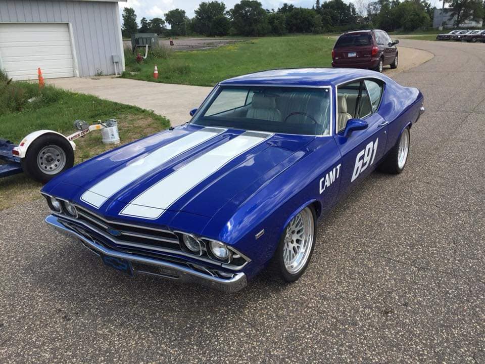

Over the winter of 2017/2018 I finished assembly of most of the car, and bought another new set of wheels, this time finally buying the expensive ones that I had wanted for many years, 18x9.5" and 18x11" CCW Classics. I had to make a little extra clearance in the rear, but I was able to stuff 315/30s in with no rubbing.
By spring of 2018 the car was nearly complete, and finally looked to be ready for the road...

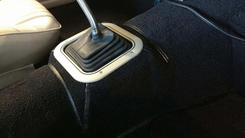

Custom made carpet to fit the floor by Steve Augustin, and Cale cleaning for reassembly...

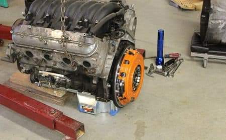

I ran the car a little bit with open headers, but without exhaust on the car, the oxygen sensors were too close to the end of the pipe, so it was reading lean at lower RPM, and dumping in enough extra fuel to start fouling plugs. I cleaned the plugs, installed exhaust, and took the car to the Lyle car show for it's first trip out on the road. I didn't realize all that extra fuel had thinned out the oil, and was destroying the bearings.
I bought a cheap junkyard 5.3L to replace the damaged 383 just to get by for the rest of the summer. I then signed up for an autocross at DCTC, where a tensioner pulley seized and shredded the belt. Easy fix at least there.

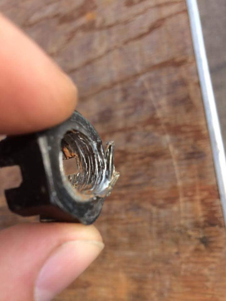

At Street Machine Nationals, my season was ended with a loose lower balljoint coming apart, jamming the tire into the fender. In all my late-night thrashes, I had forgotten that I left the lower balljoint nuts loose so that I could adjust ride-height.

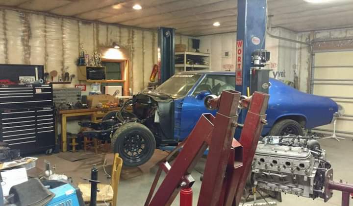

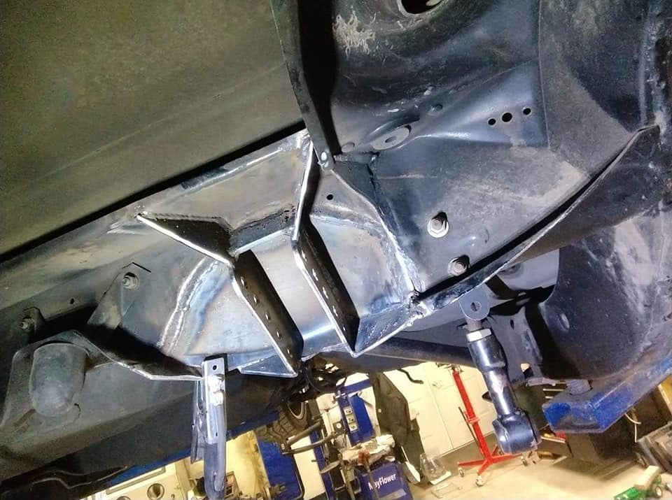

Over the winter of 2018/2019, I had Dad replace the fender and repaint the whole right front corner of the car, and took the wounded 383" LS1 in to Baier's Engine Service for a rebuild. I pulled the junkyard 5.3 and while I had extra room to work, I cut the frame pockets out and installed Speedtech Chicane upper coilover mounts to change from the old dirt-track spring/weight-jacks to VariShock DA coilovers. I got it all back together and had it tuned by Steven Kiehne, making 434hp to the wheels peaking at 5650rpm.

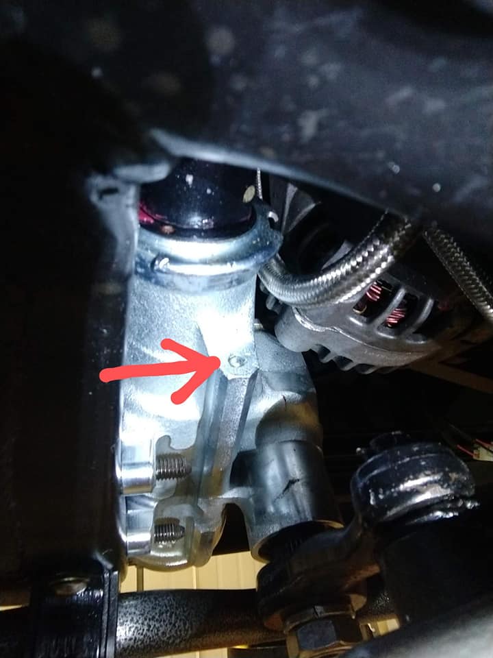

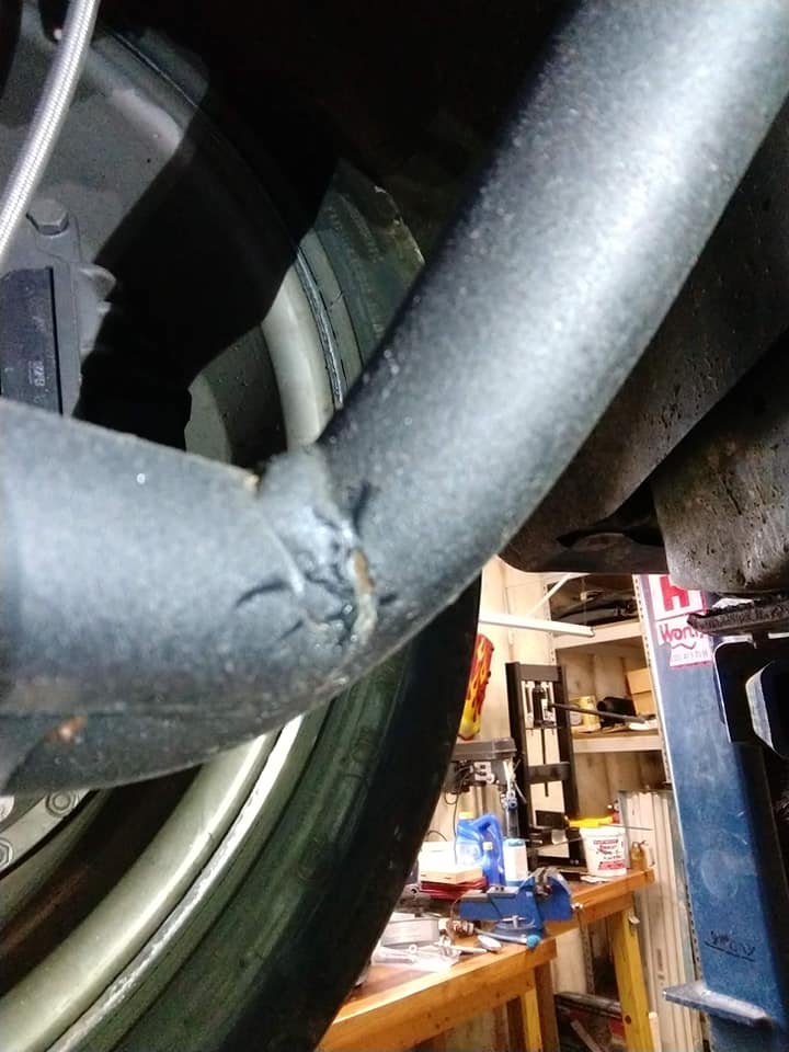

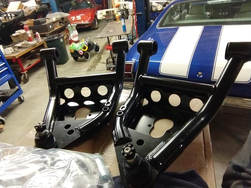

I didn't change much over the winter of 2019/2020 other than removing the hydroboost and changing to manual brakes. First time out for a cruise in spring of 2020, my 8:1 Sweet Mfg. steering box (new previous fall) had developed a pretty significant leak, and while looking at that, I noticed that I corded the inside edges of the front tires. I re-checked alignment and everything had moved. Less camber, and a lot of toe out led to discovering my lower A arms were just starting to collapse. Thankfully, SPC replaced them with their newer beefier version.

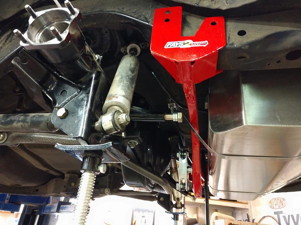

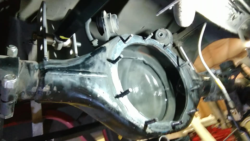

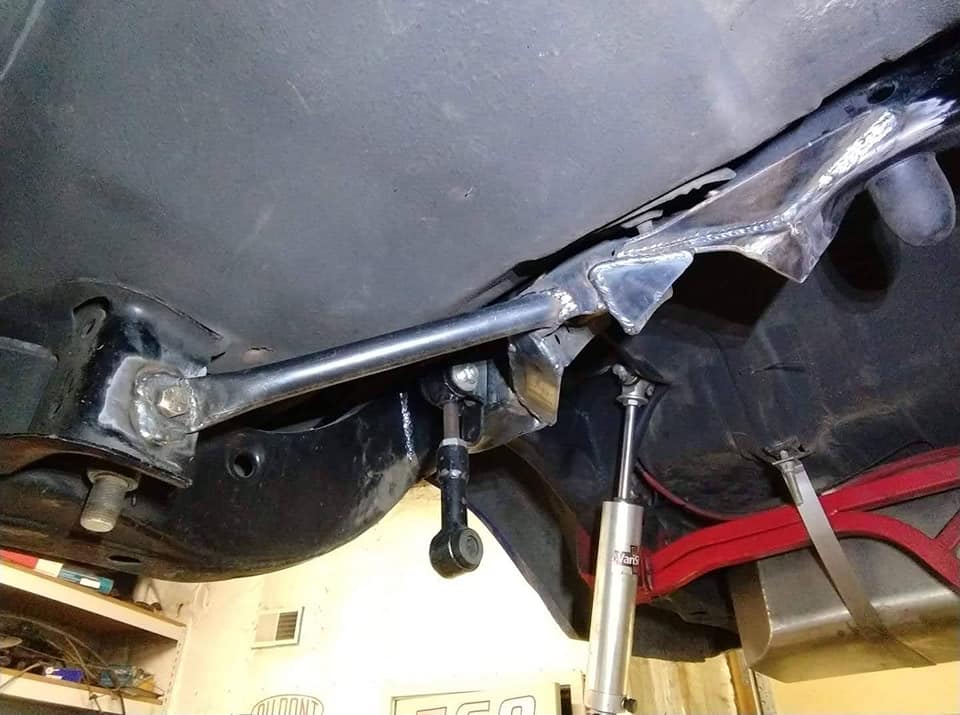

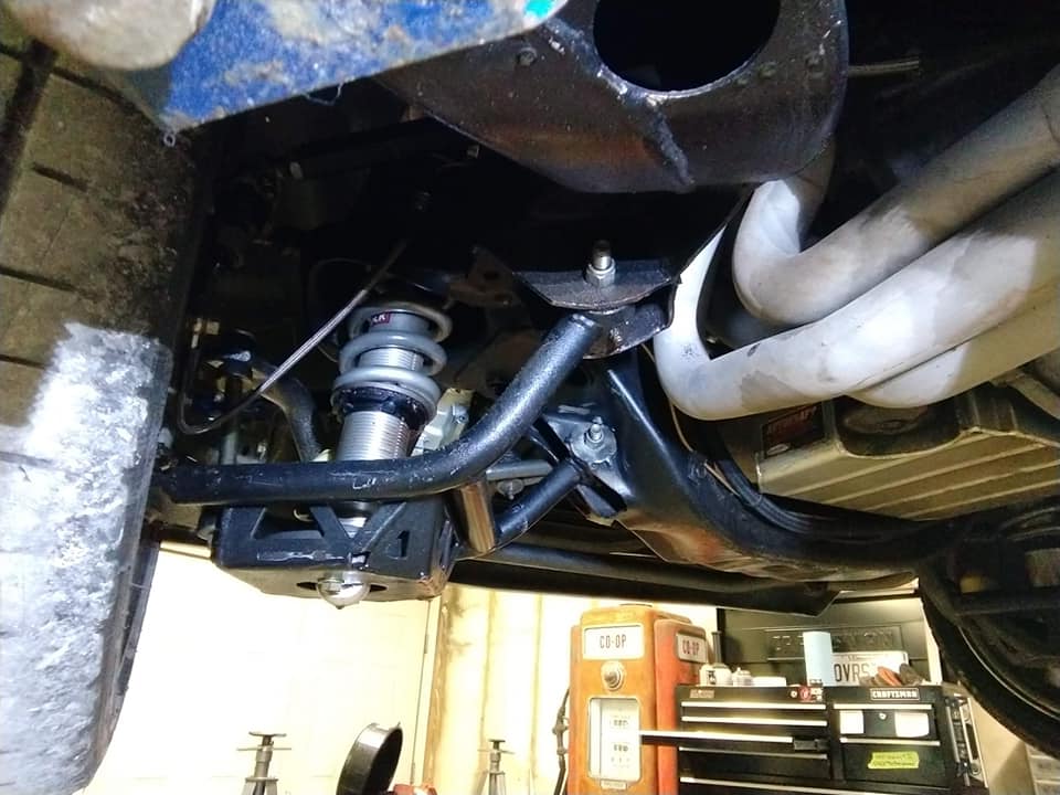

With no karting league at the beginning of winter due to covid, and waiting for parts to come in I made a decision to cut up the rear suspension and change the converging 4-link to a parallel 3-link. Getting decent geometry while keeping the back seat is a challenge. The result is an 11" upper link, offset 9" from center, and a lot of adjustability for anti-squat.
Instant center location is improved a lot over stock, all roll-bind is eliminated, and I have full freedom to adjust roll-center height. The only unknown is whether the 9" offset will work... I'm not smart enough to figure out the math needed to calculate that, so I will just try it and if it doesn't work, I will add a link to the other side and turn it into a parallel 4-link.
I also added a drain plug while it was apart... If you ever put a Ford 9" in anything, get the drain plug option. You're welcome.
