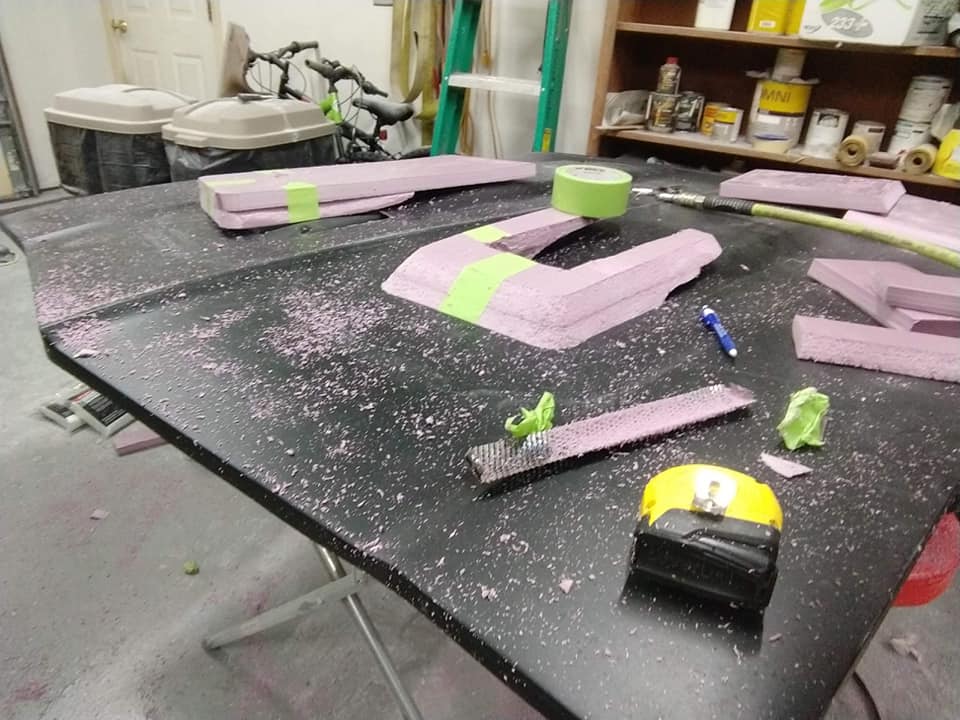

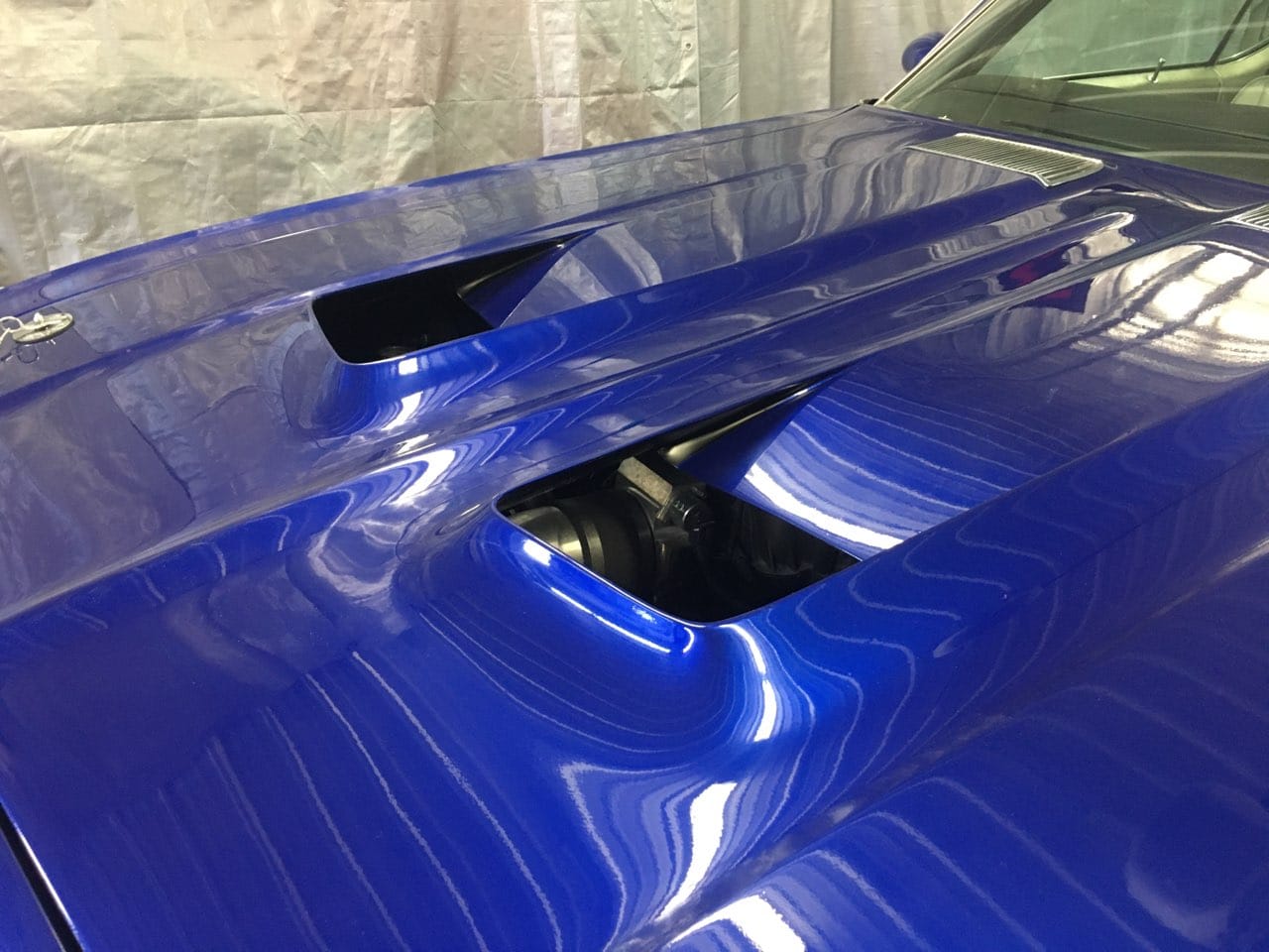

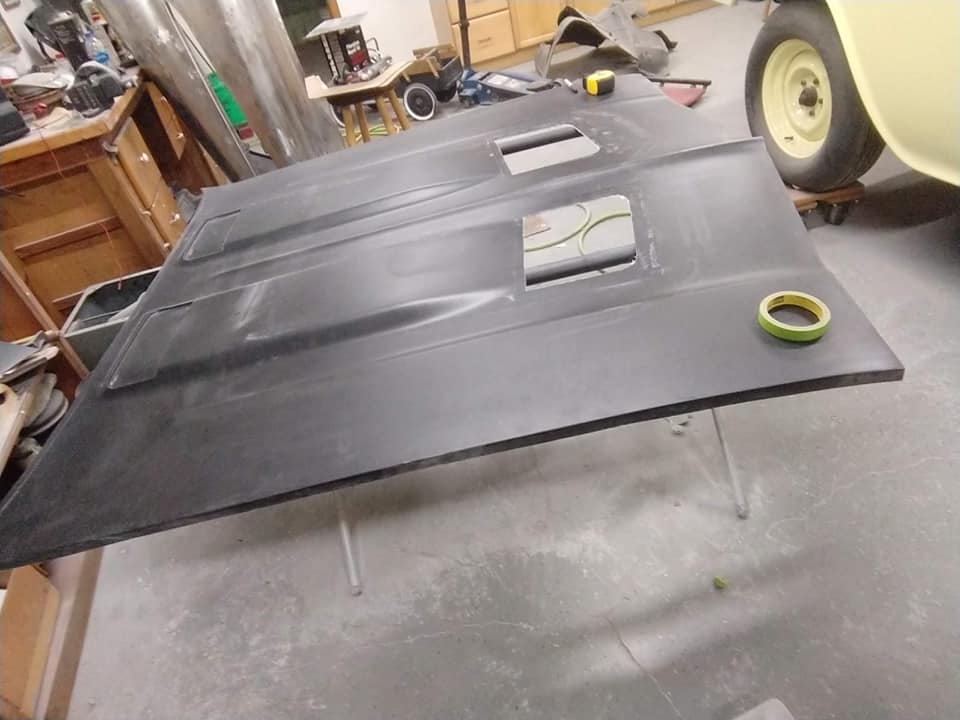

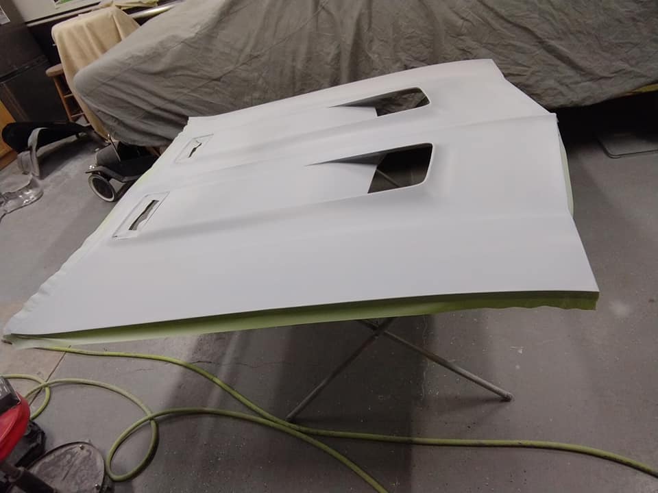

Spring of 2021, I decided to finally do a project I had wanted to do for about 12 years.

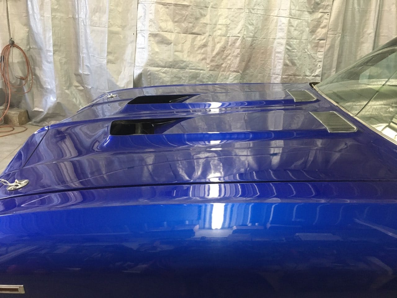

I bought a fiberglass hood from Glasstek, and modified it for functional heat extractors that I moulded into the hood and tied into the shape of the SS bulges. The holes are right behind the radiator, located in a low-pressure area and will help pull high-pressure air out from under the hood, significantly reducing aero-lift at high speeds, reducing under-hood temperatures, and increasing air flow through the radiator.
The fiberglass hood also removed 40 lbs of high-centered weight off the front of the car. (Stock hood 72.3 lbs, FG 32.3 lbs)

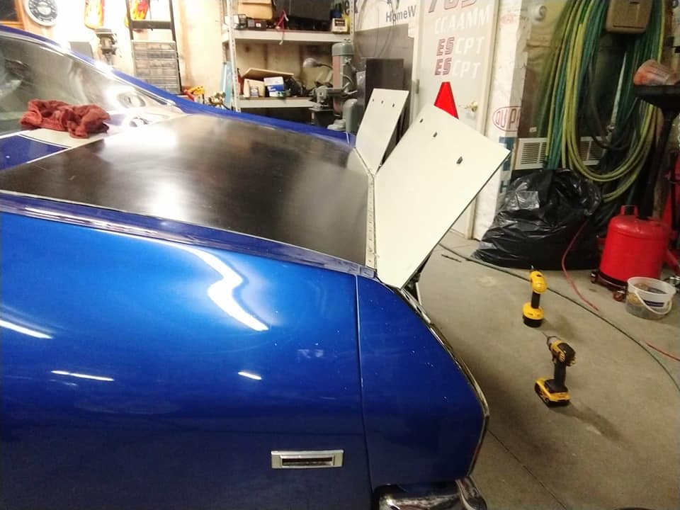

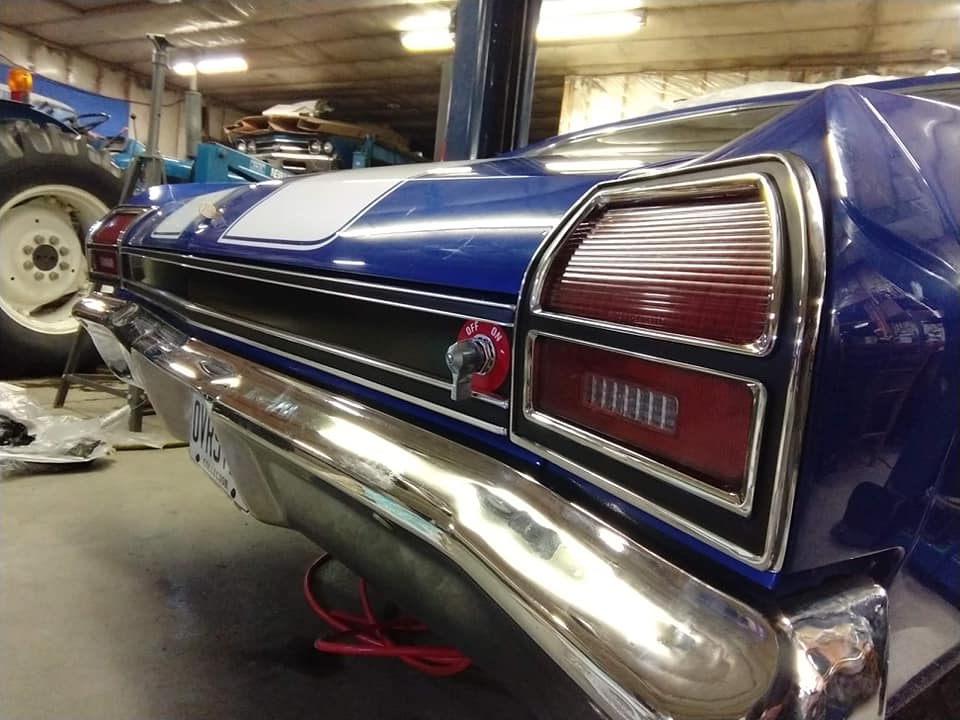

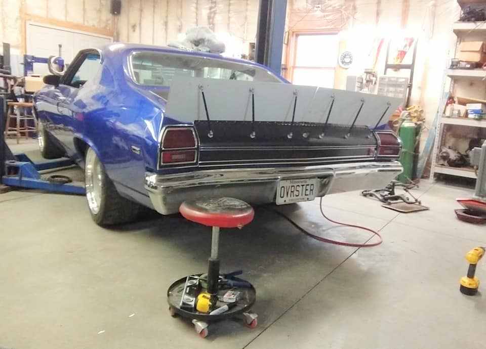

Over the years I had changed my opinion on a few things, and wasn't real fond of the smoothed rear tail panel painted body color anymore, so in 2021 I added the trim back on, and painted the panel satin black like a factory SS car.
I also moved the battery to the trunk to help balance the car, and bought a fiberglass trunk lid to help shed some weight.

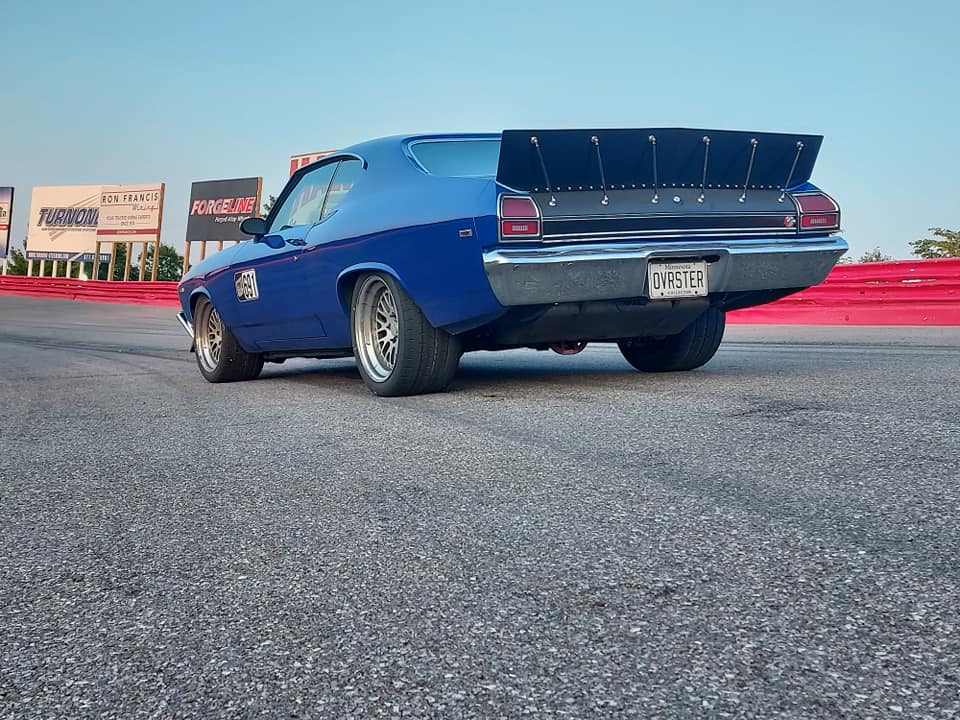

I wanted to take advantage of the aero allowances for the classes I intend to run with. What you see here is a ridiculous looking 10" SCCA CAMT-legal spoiler. I also made an 8" version for USCA events. It will be easy enough to swap out size and adjust AOA depending on use... Big one at steep angle for low-speed events (autocross) and smaller ones laid back more for higher speeds (roadcourse)
I don't expect everyone to like it, but it is there for a purpose, and I will take any performance advantage I can get.

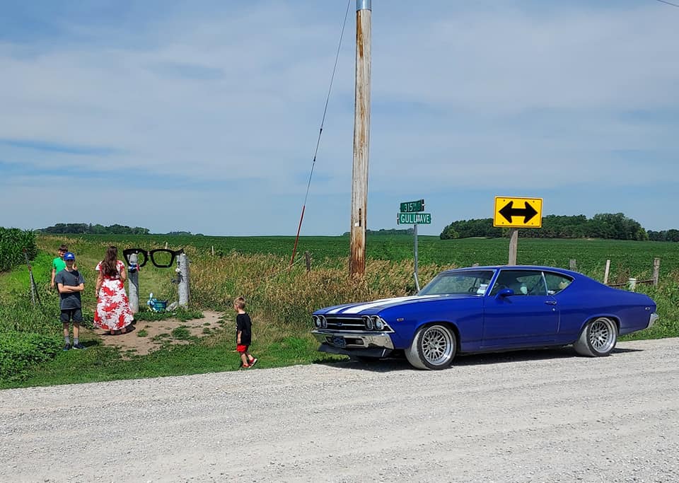

Drove my Chevy to the Levee but the Levee was dry... stopped at the Buddy Holly crash site on the way home from Goodguys Des Moines.

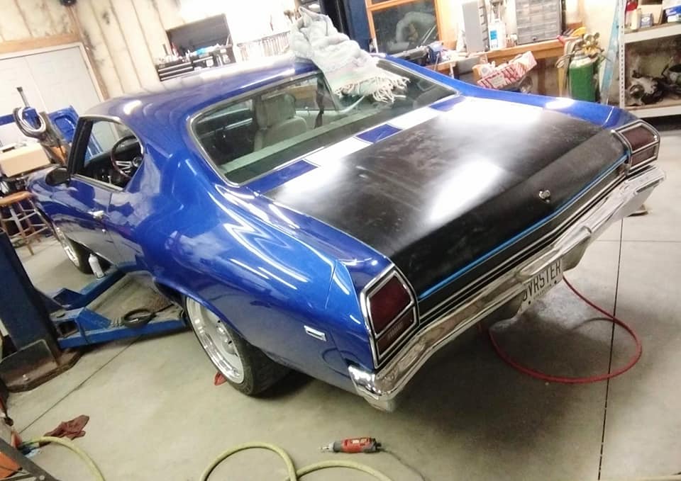

I was signed up for UMI Autocross Challenge 2021, and decided if I wanted a shot at winning an invite to KOTM, I'd need the fiberglass parts and the spoiler mounted. I didn't have time to get blocked smooth and painted, so I shot them with black epoxy primer and installed them unfinished for the rest of the summer.
Fresh 295/35/18 squared Yokohama A052s, as well as taking 40lbs off the front, 18.5lbs off the back, and adding the spoiler did the trick, as I won the invite by 0.059 second over 2 days.

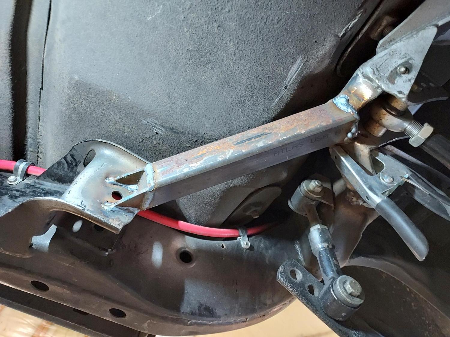

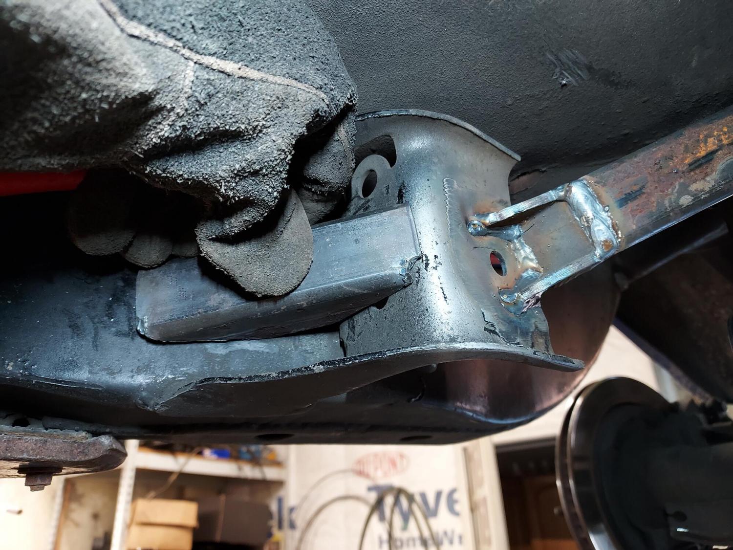

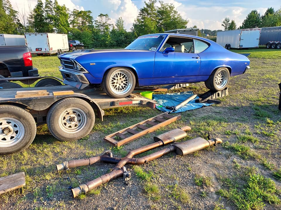

The night I had to load up and leave for UMI King of the Mountain 3.0, I discovered the real reason for all the smoke. The rear seal on the T56 was leaking really bad on acceleration, and the driveshaft was throwing trans fluid onto the exhaust. I didn't have a new seal, but I loaded up anyway and headed to Pennsylvania. Thinking about the problem on the way, I realized I'd be driving right past Summit Racing in Talmadge OH, and would have no problem getting a new seal on short notice there. I replaced the seal at UMI Motorsports Park, but also discovered another problem. The lower brace connecting my 3-link upper frame mount to the lower mount was starting to buckle. I had made it out of too thin of metal for the stresses I was putting it through, and braking into T5 at Road America from 135mph had pushed the driveshaft too far into the trans, wiping out the seal.
It was too late to fix the brace, so the decision was made just to replace the seal and run it for the weekend and weld in a new brace when I got home.

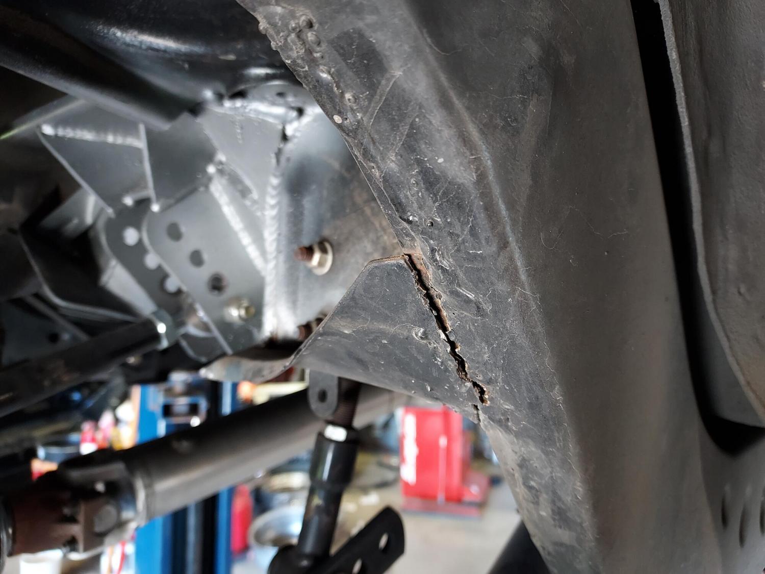

The decision to run KOTM with a buckled chassis brace probably wasn't a smart one, but I had already towed 14 hours to get there before it was discovered... When I got home after the event, the brace had fractured on both ends and was laying loose on the floor of the trailer. Putting the car up on the lift revealed that repeated flexing was tearing the rear crossmember away from the frame rails. The rain on Saturday, with the last runs of the weekend being in the wet probably saved me from more serious problems.
I built a new brace out of much heavier material, and added some gussets. I now paint all of my chassis modifications in light colors (white or silver depending on what I have on hand) to make inspections for cracks easier.

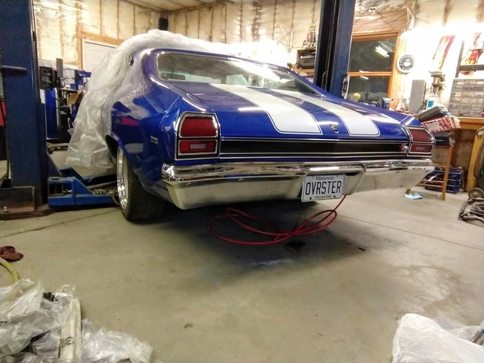

Winter of 2021/2022 Dad and I traded cars for the season. Neither of us wanted to work on our own junk, but we both were able to get stuff done on each other's cars.
His skills, garage, and tools are better set up for paint and body, and I'm better set up for chassis and mechanical work.
He got my Chevelle hood and trunk painted while I installed power steering and did some suspension work on his '68 Camaro.

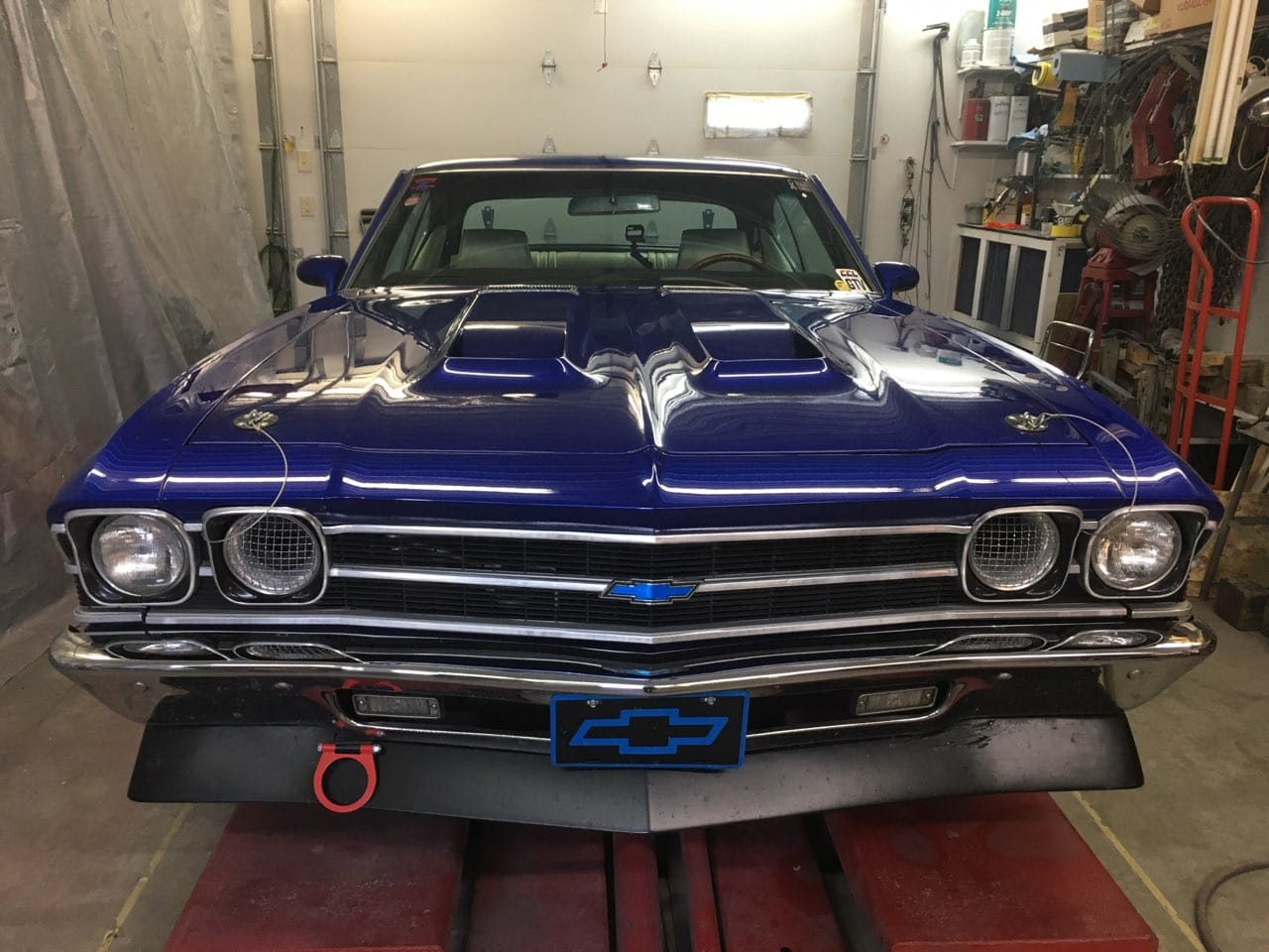

Spring of 2022, with the new hood/trunk and no stripes.
