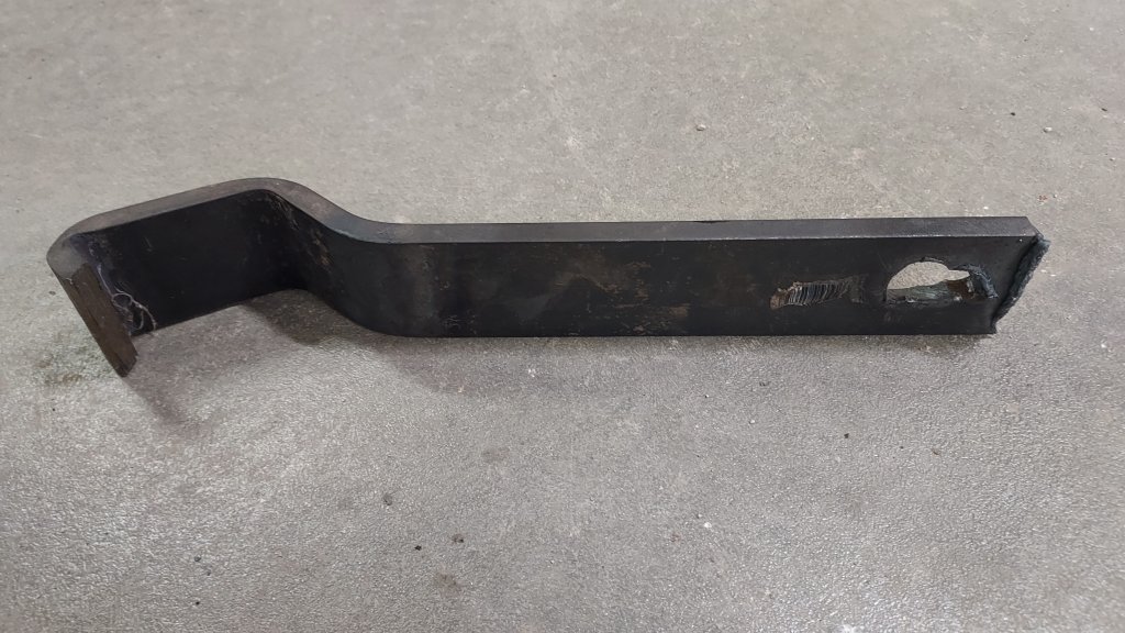

Goodguys Des Moines 2023, I broke a spindle and jammed the driver's side wheel into the fender.
The manufacturer sent me a new spindle of a revised design, and the suspension was fixed pretty easily a few weeks ago, but the fender was pushed into the door, making it unable to open and close. I fixed that problem by making a hook that i could use to pull the fender out.
All the damage is down low, so I just touched up the paint chips, and leave it dented.
