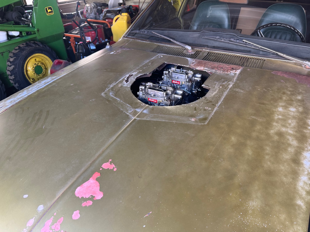

Beautiful day out today. Opened the garage door and spent a few hours working on the Tunnel Ram, carbs, and hood of the SC. The hood isn’t original and is already rough so I don’t feel bad cutting it more.
I’m ordering tires today for the slot mags. And ordering a bunch of small parts to finish up the install of the carbs and stuff. It came out pretty good.
Thanks for reading. Should have another update soon. Including installing the headers. I can’t wait to take this car to Kenosha in July.

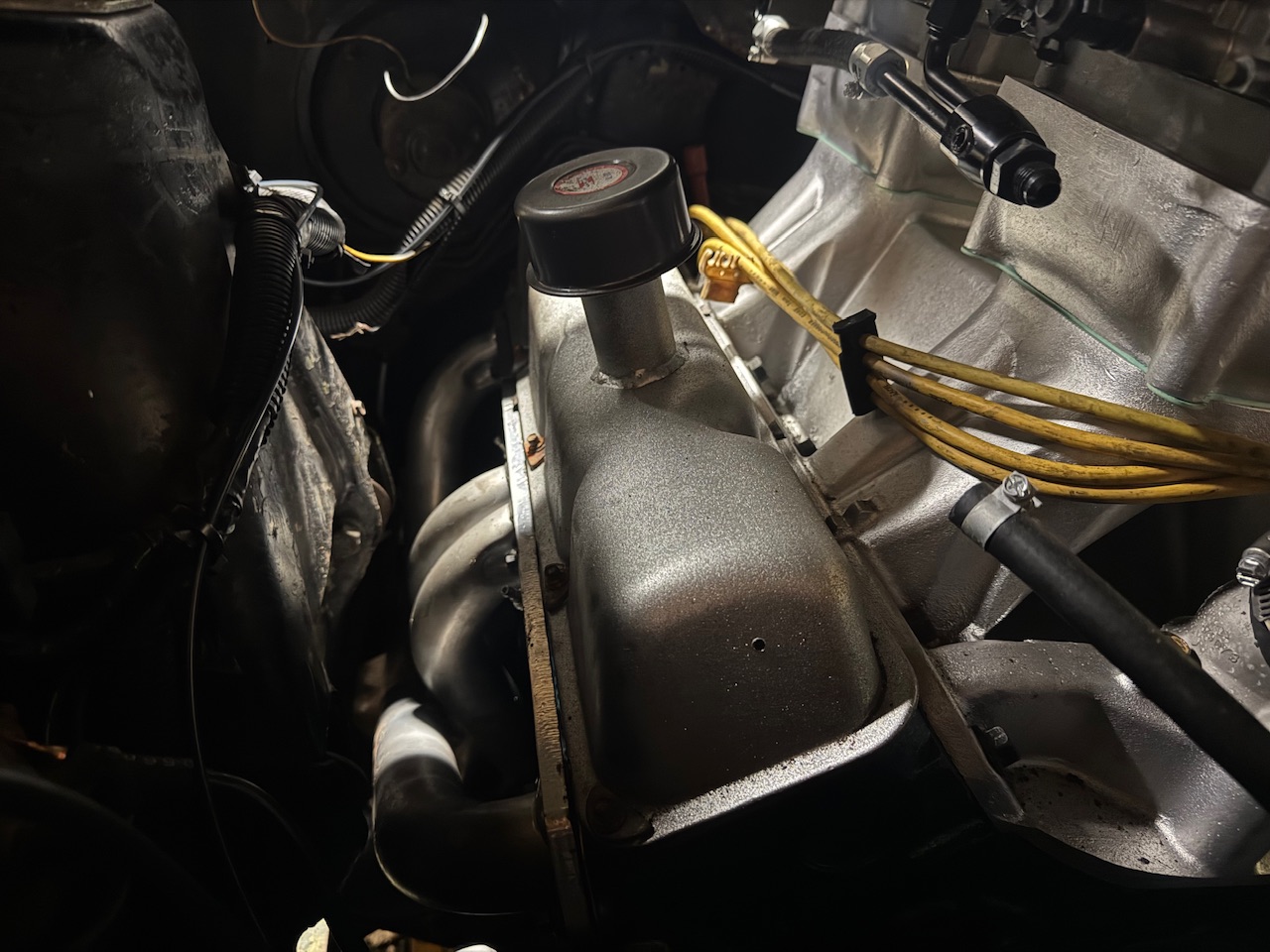

Back in November at MCACN I picked up a set of used Doug’s D103 1.75” headers. They’re ceramic coated and almost 1k new, I picked these up for like 200 bucks because they’ve seen speed bumps a few times. But for this car they’ll work perfectly.
After pulling the manifold off the drivers side the header fit right in after a little jack magic and a few choice words. I used copper SCE gaskets and ARP bolts so hopefully I don’t have any leaks.
The passenger side was a bit more of an adventure because I had to remove the starter, partially put the header in, slip the starter in, then hold the starter up near the block while sliding the header further up. Another set of hands would’ve made the work easy. But Marty can’t do that yet since he’s only 2. So I had to make do with it myself. After many more choice words everything was installed and tight. Tomorrow I need to make a parts store run and I’m waiting for some Amazon stuff to finish the intake.
Thanks for reading.

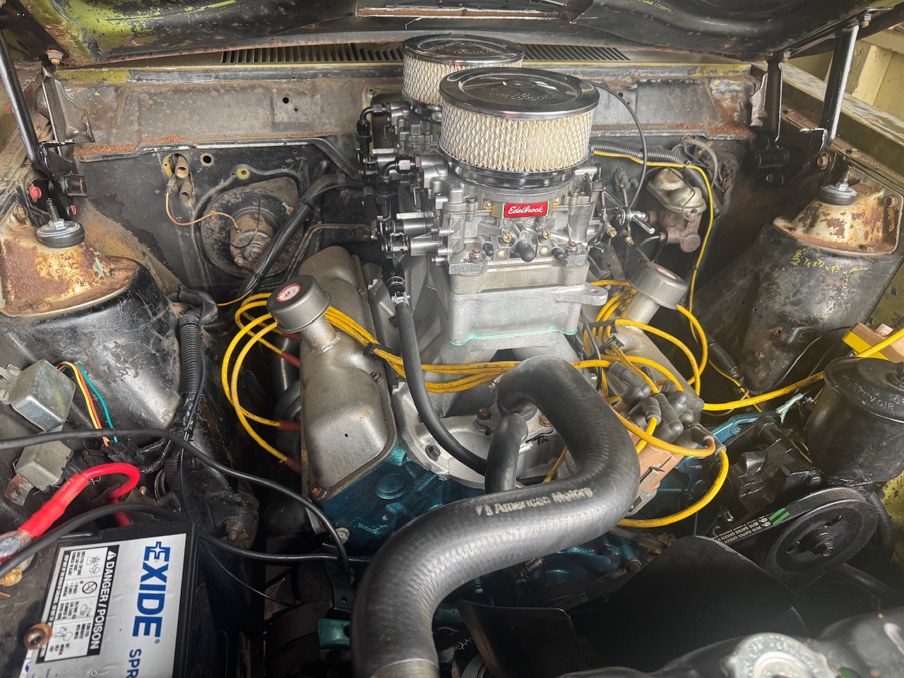

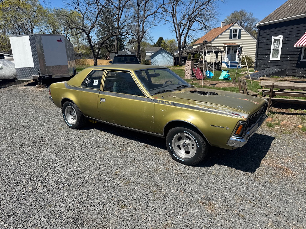

When I bought the car it had old American Racing Slot mags on it. I decided since I want to use the car this year I’d get new tires mounted on them. I also found NOS hub covers for them. I still hate the look of radials but I didn’t feel like spending 1200 dollars on bias plys so I spent 750 on new T/A’s.

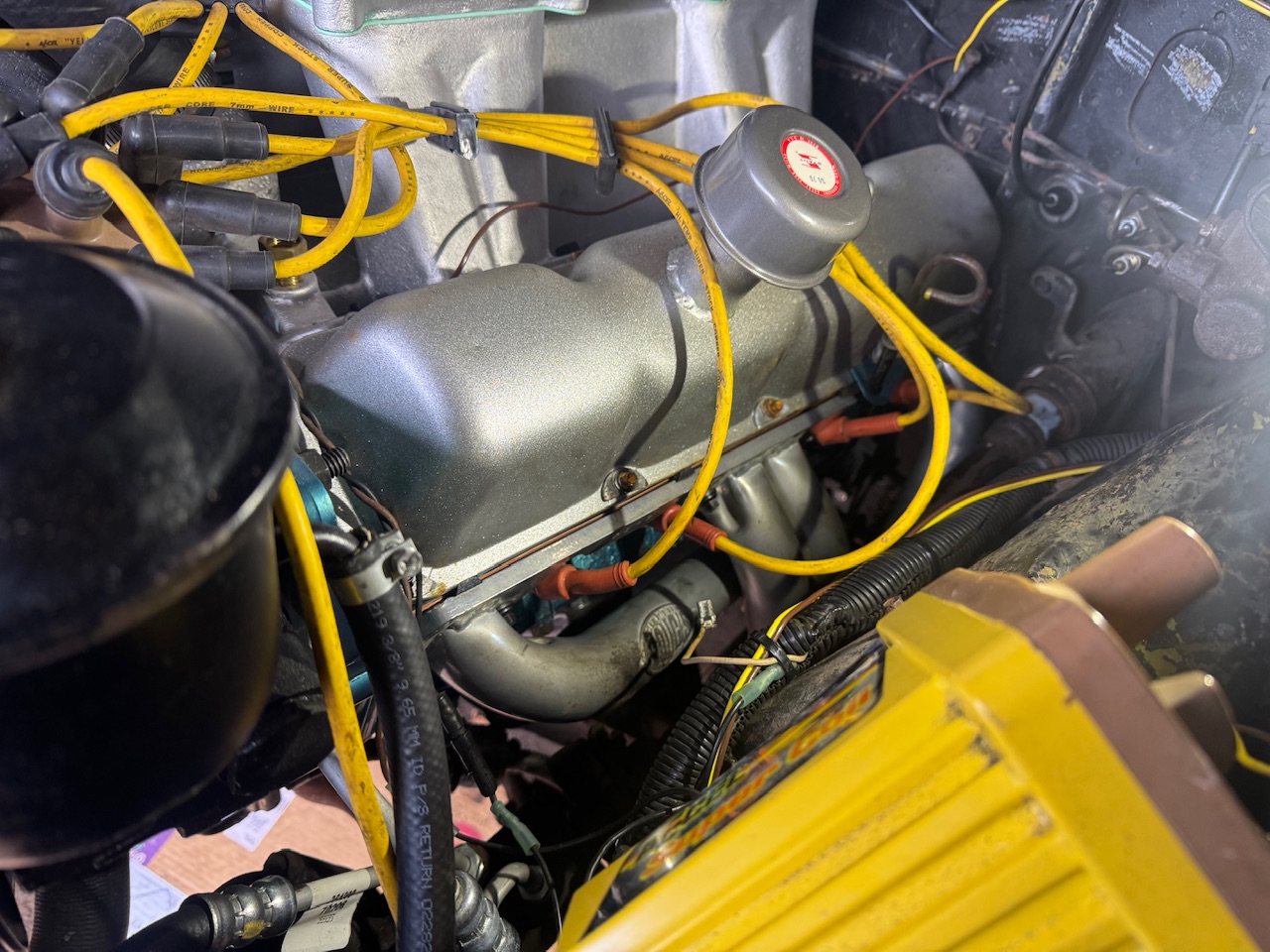

The headers are finally done and the new mini starter is mounted. Just need to finish up the wiring and it should be ready to crank. I bolted Purple Hornies to the collectors so it has mufflers on it.
The throttle linkage is kind of done. I cannot for the life of me find a throttle linkage bracket that lines up to the stupid Edelbrock carb. I already hated Edelbrock carbs and this issue isn’t helping the matter.
I still have some wiring to finish up and a bunch of small tie up work. But I think if I get a nice day or 2 I can have the car running again.

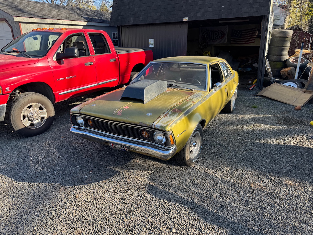

Had a little time today and then decided to run errands with the 360. I beat this thing like a rented mule. It’s a blast. The tunnel ram runs good. After getting fuel close to home I had to run back home to fix a few issues. The right side valve cover needed the bolts snugged up. I put a spacer on the starter as the drive was lightly touching the flywheel, it needed another throttle return spring and I had to clearance the hood a little because when the engine torqued the throttle got stuck on the hood. That was fun to find out.
Ran and got all-thread and cut it to put air filters on, then drilled the hood and mounted the Grump Lump. It’s ridiculous and I love it.
