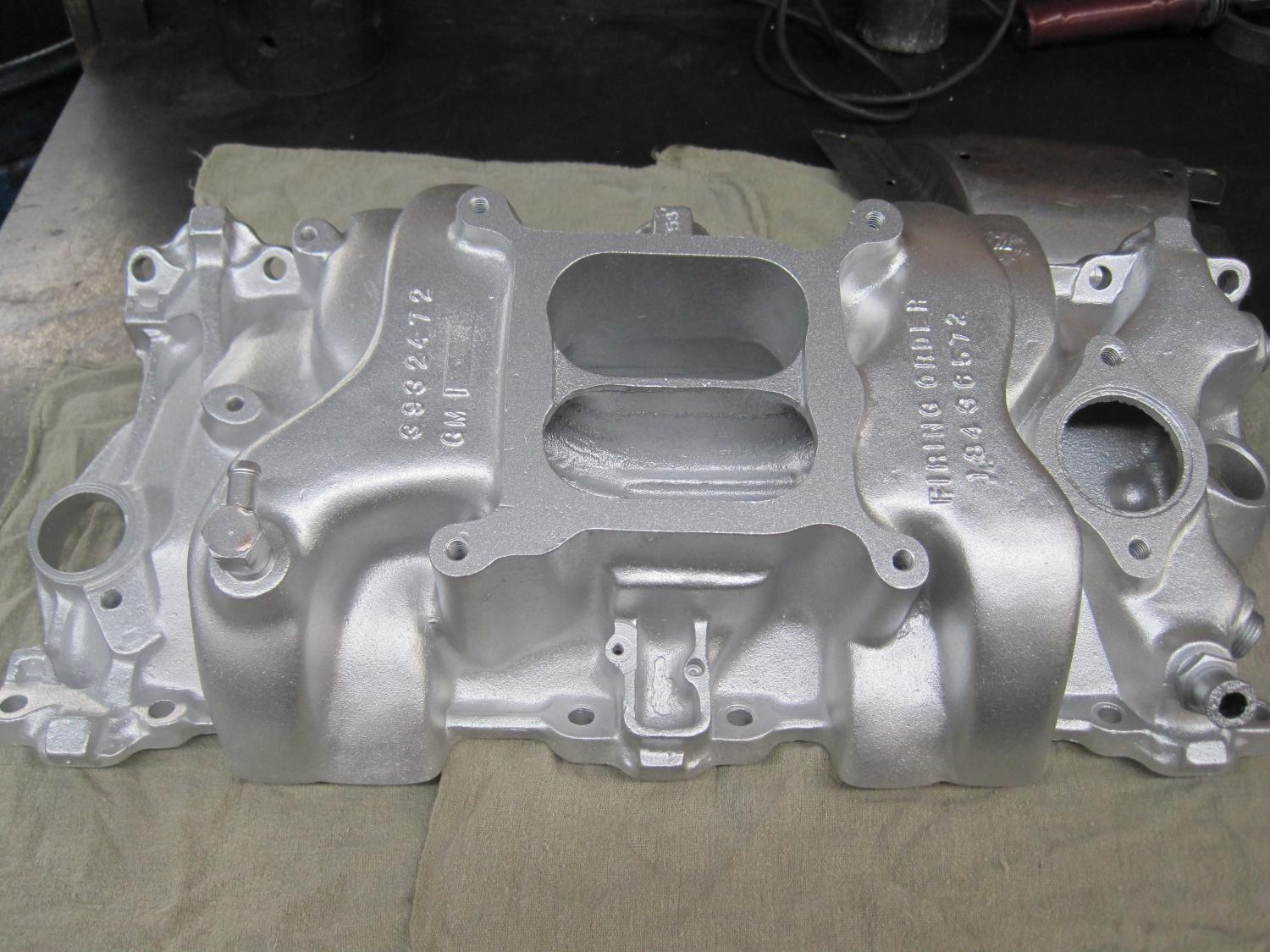

This Aluminum Intake was METAL Shot Blasted in a machine that is only
used for Clean Alum Parts so as to not contaminate the metal shot

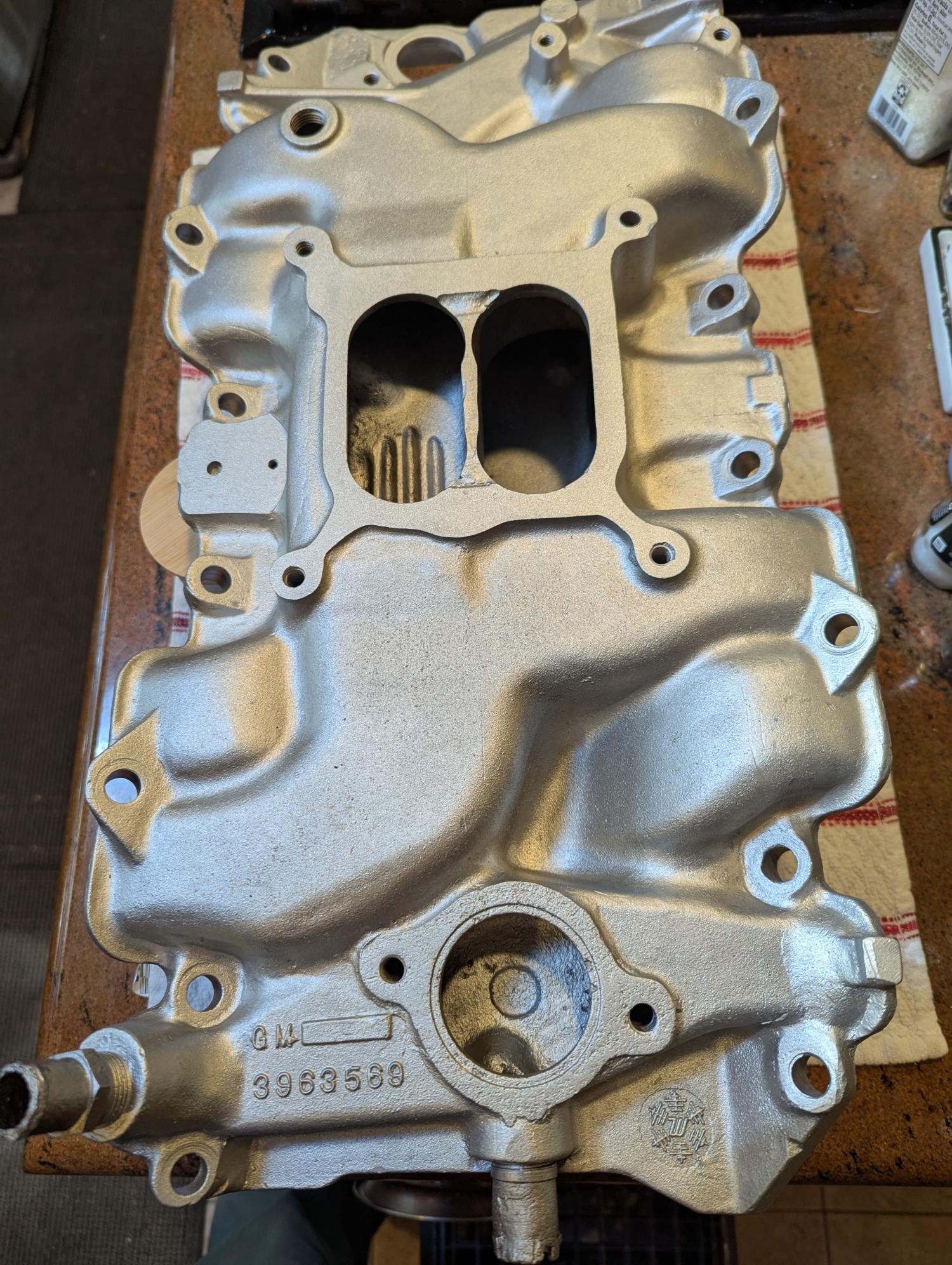

3963569 LS6/L78 Intake that I ran thru Metal Shot Blaster.................
