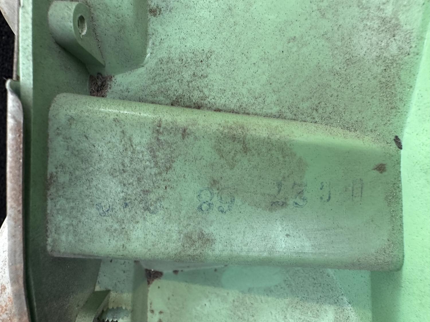

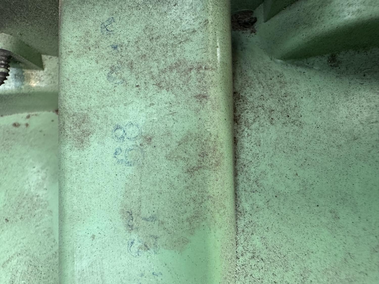

It's accepted by some as just a human error but some will disagree. I've got an engine here with the same anomaly but it has a 9 vs a 0. To me, that's easier to buy because it's just one roll of the digitizer and that can happen by accident imo. Since it would happen so seldom, I don't think you're going to hear a lot of personal testimonies, just opinions on either side.

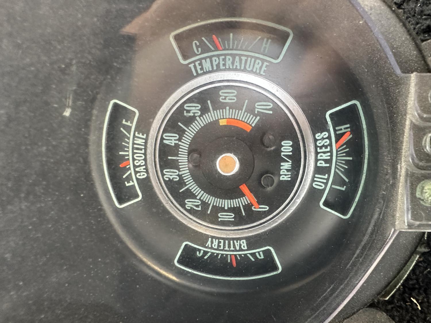

I got the front clip and drivers door on and for the most part adjusted where gaps are nice! The hood is a different story it almost touches fender on drivers side but passenger side has 3/4” gap. I think I can push drivers door in about 1/8 which would allow me to move drivers fender in about the same but I don’t believe that will be enough to close up gap on passenger side! Assembly manual says between the fender opening in back by windshield should be 56 5/8 my opening is 57”. Anyone have any advice on this ? This car has January build date with GM factory 6,000 rpm redline tachometer cloth bench seat (originally) and column shift . I pulled dash cluster out this week to find a late 68 date code on it. The dash cluster is also from a column shift car. Which leads me to believe its original to the car but it had been restored By the Lions Club here in Michigan before the wreck!

Another interesting thing about this car is it has all deep groove pulleys. The car was restored by the Lions Club here in Michigan as earlier stated however not sure they would add deep groove pulleys. Cloth bench seat (755) column shift, column shift gauge cluster, with factory 6,000 redline Tachometer, single 3/8 fuel line, GM deep groove pulleys, front disk brakes with 636 and 637 front brake calipers, 512 casting 4 bolt block, with late 68 dated 840 heads and factory 3:31 posi! Someone also installed both NOS quarters and both NOS front fenders before accident.
