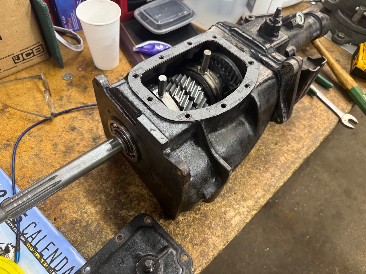

Had some time to work on the transmission on breaks and lunch. I’m waiting for new bearings to finish putting it together, after that it’ll get put away for whenever the car gets assembled.
First and second are proshifted
Third and fourth are faceplated
The tailshaft housing is mostly assembled and the speedo hole is plugged.

Haven’t had much time to work on the car lately. I may get a chance to play with it tomorrow. But I did end up with enough time on lunch today to get the transmission all back together. It went together fairly well, other than me not realizing I couldn’t follow the book due to the size of the 3rd gear lugs, I had to slide the countershaft back out of the way to clear the main shaft, which according to the book isn’t a problem with a factory iron T10.
I also marked what it is so if I die someone won’t just assume it’s a stock trans if they buy it at the estate sale lol.

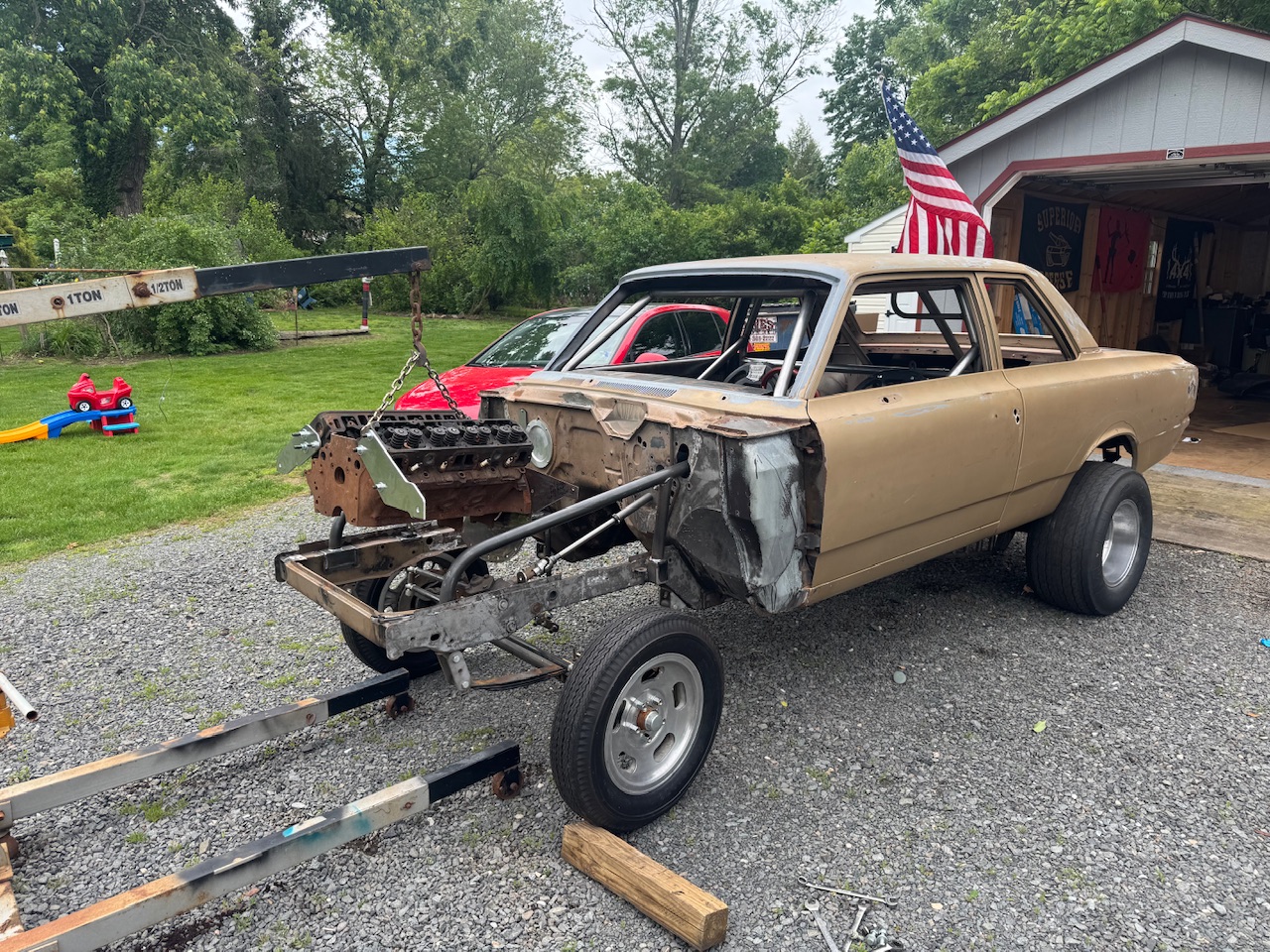

Time for a small update on the gasser.
The cars sat for the last few weeks, I just kind of needed a small break from spending money on it. But now I’m recharged and ready to get after it a bit.
I have a media blaster coming the second half of June to blast the whole car inside and out so I can have a clean base to do all my other welding and fabrication on. I need to do the floors and a bunch of other panels to cover holes and build a partition wall to the trunk.
I have a list of small parts I’m going to try to find at Ford Carlisle in a couple of weeks. Fuel system stuff.
The Lakewood bellhousing is machined flat(it was only .005 out but my machinist says he always does these because he’s seen a lot of variation on them.
And I have all of my fiberglass parts that I’ll need to figure out how to mount. I have some time off in June so I’m going to try and spend a couple days assembling the long block so it can get stored away with the transmission until it’s ready to go in. So I should have some bigger updates coming up. Thanks for reading.

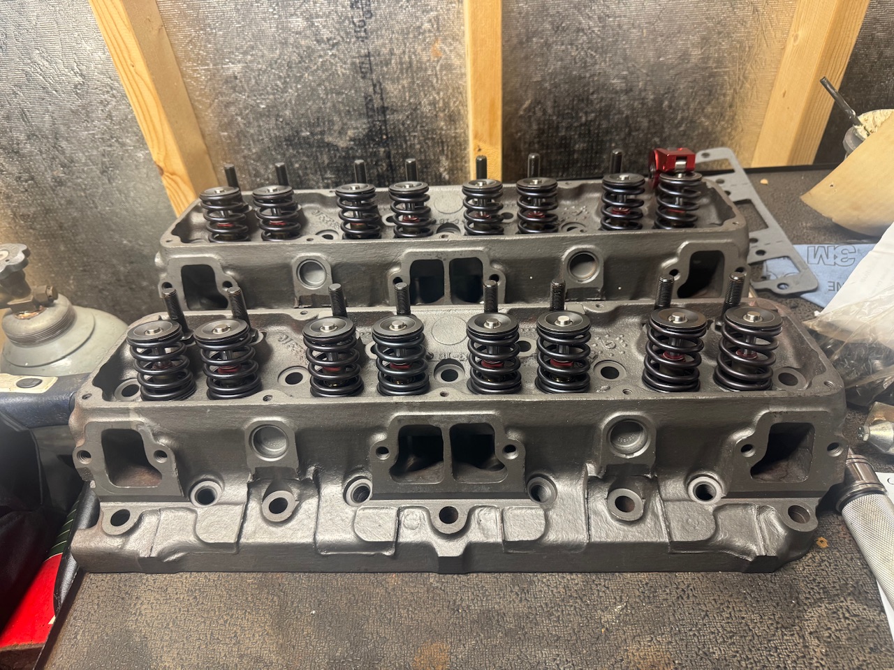

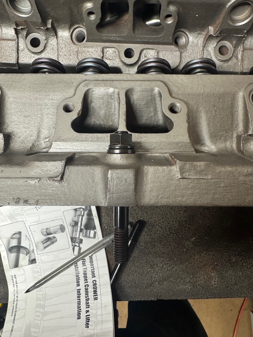

Small update today, spent a little time outside going over engine parts. I found that the Milodon head studs are way too long for the heads. After calling Milodon and sending pictures they agreed to swap them out for shorter studs. Hopefully I’ll have the long block together next week and start figuring out all the pulleys for the blower and alternator.
Also got the rocker studs in and torqued to get rid of a box that’s been in my way for months.
