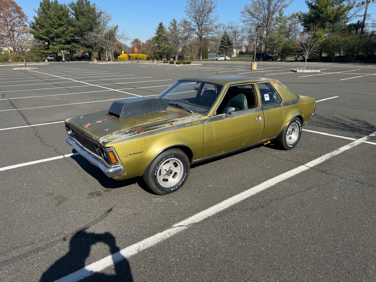

Not much of an update.
But a couple of pictures from running errands with the car late last week. It’s a bunch of fun. Ran into a problem on Saturday where the car got slower and slower. After some roadside repairs I nursed it home with the throttle pedal hanging off the firewall because the wood screws installed 50ish years ago to hold it pulled out of the sheet metal.
Spent some time yesterday bolting the pedal back in and fixing the firewall a bit while Marty played with the steering wheel and jumped on the drivers seat.

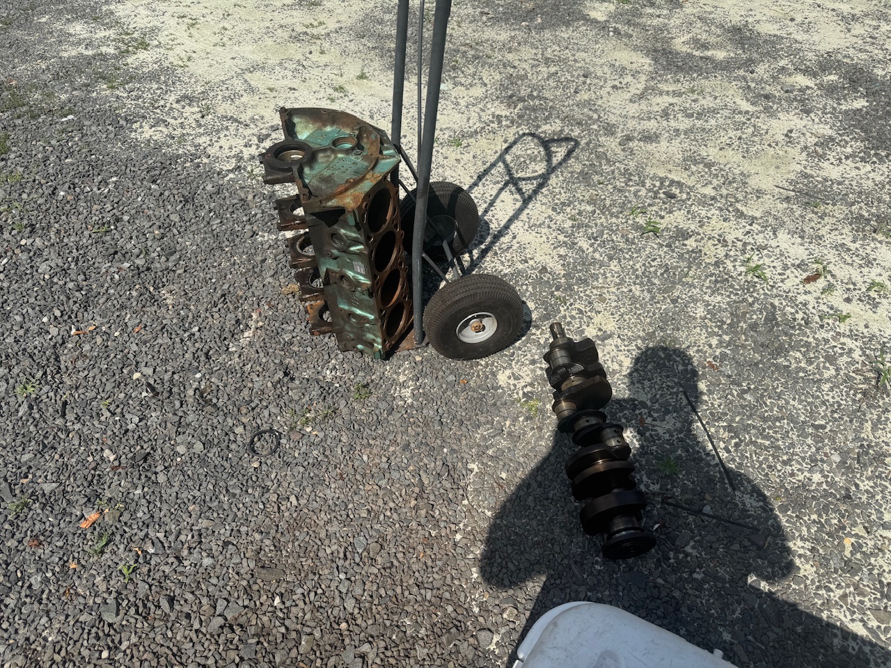

The short block is another 100 dollar 360 I picked up that was remanufactured at some point in its past. It’s bored .040 over at 4.120 and the crank is .010 on the mains and .020 on the rods. I’m not using that crank though as I have a nice uncut standard 360 crank I was given months ago.
My current plan is to go to 4.155 bore(stock is 4.080) and have the crank cut offset to increase the stroke to 3.66(stock is 3.44) with NASCAR 6.200 rods that use a 1.850 rod journal. They’re super cheap on eBay. I’ll just need pistons made for it which a friend in the AMC community is offering to help me spec so I get everything correct.
I really like this car and since I’m going to keep it I figure I’ll build something nicer for it than the basic 360 I built for it last year.
