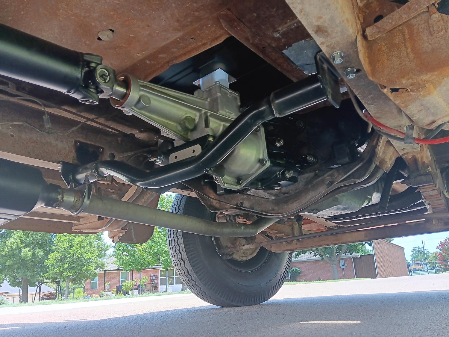

Been tinkering on the truck a bit and decided that three-on-the-tree gobbledygook shifter had to go. So what’s one to do? Simple, add a T5 to it!
This of course, involved swapping the rear to a 58 Apache open axle which completely ditches the enclosed driveline. It drives MUCH better now. Added a few new engine bits, sealed up leaking gaskets, and now there’s not a drop of anything under the truck. Before I couldn’t put enough cardboard down to keep my floor clean. New tires, master cylinder, and a few other bitsas. Coming out nice!
What’s next? I’m not sure but, I’m thinking a driver quality paint job in Washington Blue would look pretty killer in this. Everyone loves patina, but I’m not a fan of it. Of course if I go down that route I might have to yank the cab and bed off the frame, new glass, seals, interior, add an old school 392 Hemi….you know, just a few things.

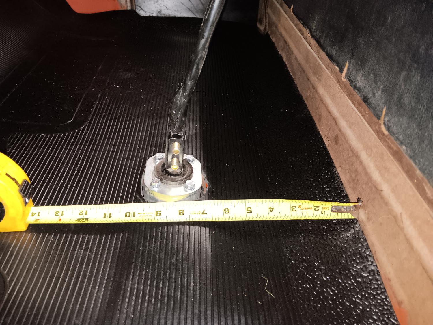

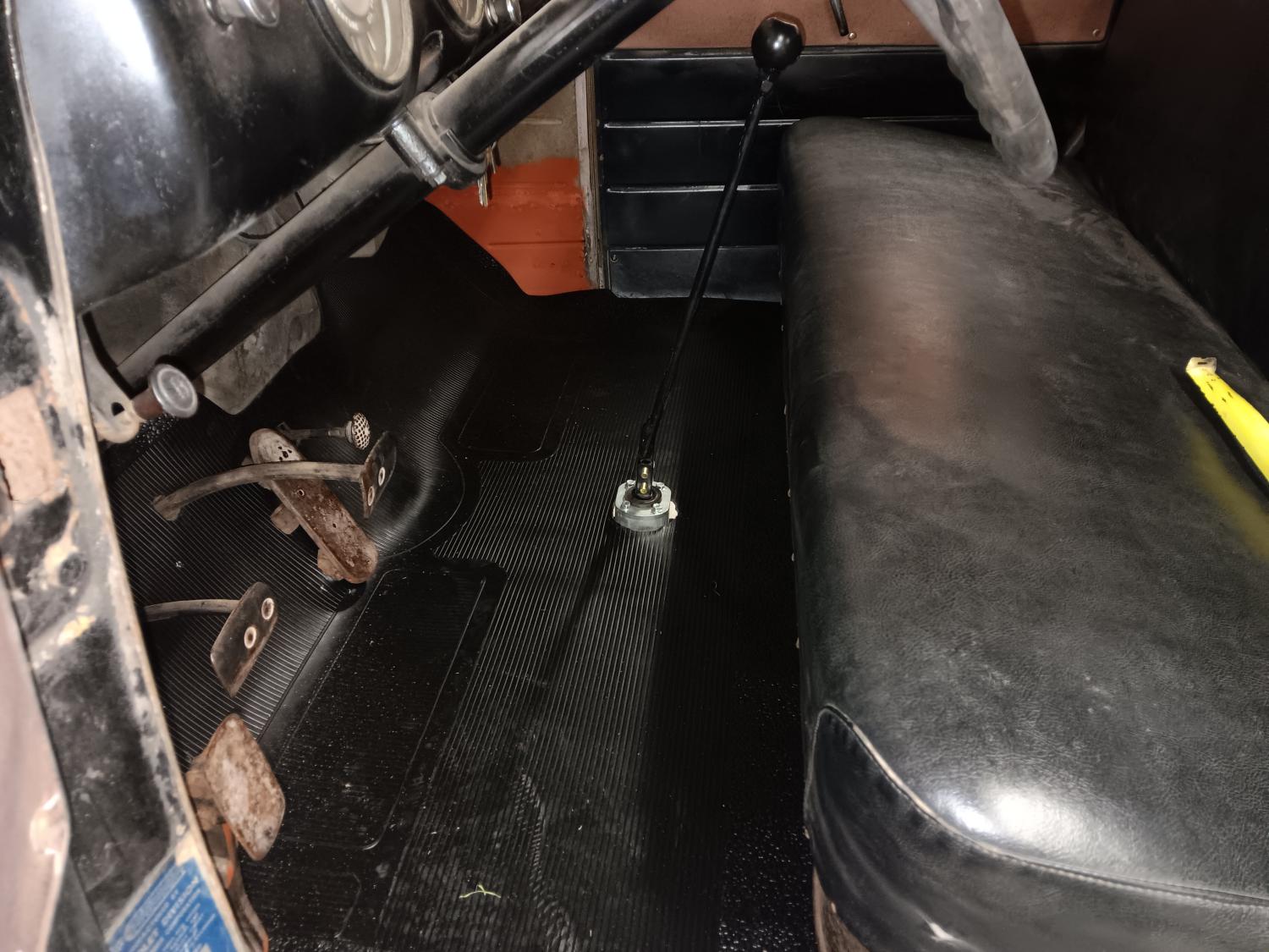

The shifter protrudes through the floor at roughly 8.25" to the center of the shifter when in neutral. This shifter is just one I made until the one I ordered gets here Monday. It clears the seat with no issues. That help?

Thanks for the pics Dave and the referral Freddie.
Its good to know that it clears the seat. I would still like to find something that is more forward, so maybe the extenders I see for other ford tremec applications would work. thx
