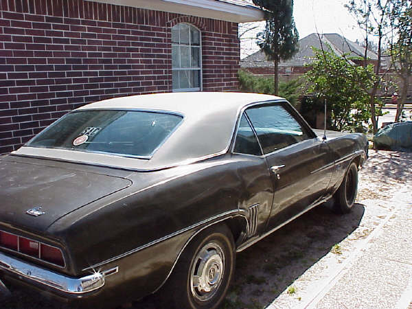

how would a x44 camaro with a code of 55 50 PNT be painted. I know it is azure turquoise and dover white, but did that mean the vinyl top or paint? I know it had a vinyl top originally. The complete line of the tag is:
TR 727 55 50 PNT

727= Standard Ivory/Black bucket seats
55-50= Lower color is Azure Turquoise and the top color is Dover White (both are painted on no vinyl top

I believe thats 2 tone paint, white painted roof, Azure body. Whoops, Jeff beat me to it anyhow! [img]/ubbthreads/images/graemlins/biggthumpup.gif[/img]

It didn't have a vinyl top originally, the 2 tone combos used the same trim as a vinyl top to separate the top color from the body color.

Wasn't this fairly a rarely ordered option? I've yet to see a car with 2-tone paint.

Thats what I was going say. Can someone post a picture of the car. I have never seen a two-tone first gen. Camaro before.

Here's a late production (11A) 63-50 coded car. It's actually about 200 cars from the end of production Though it looks like a vinyl top, it's not.
