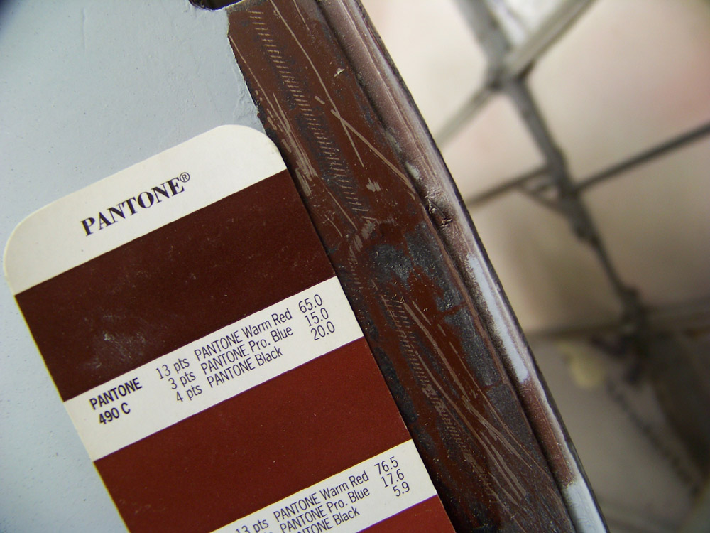

  #13
Old 09-10-2017, 05:51 PM
firstgenaddict's Avatar
Posts: 5,596
Thanks: 161
Here is a PMS color match... get an old PMS book from a local printer and mix to the colors...

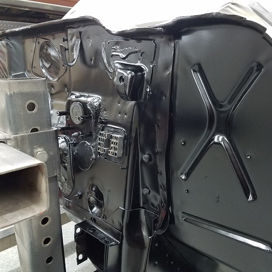

Default SPI Epoxy Primer
Wanting to show people who turn up their nose at SPI (Southern Polyurethane Inc)
Epoxy primer what was applied to bottom of my current 2nd gen Camaro project....
Firewall Pic show semi gloss PPG Delfleet Essential Polyurethane Single Stage
mixed to semi gloss....
Chuck Sharin
[email protected]
69 Camaro COPO "recreation"

  #19
Old 02-27-2018, 01:49 PM
x77-69z28's Avatar
Join Date: Apr 2008
Posts: 2,153
Thanks: 3,016
Chuck, that looks great! I am hoping to be at that point soon.

  #20
Old 02-28-2018, 12:17 AM
70-SS/RS-L78 70-SS/RS-L78 is offline
Join Date: Oct 2003
Location: Phila Area
Posts: 579
Thanked 8 Times in 7 Posts
Chuck that looks great, It looks like you thinned the SPI Epoxy and sprayed it on nice and smooth. Is that the final undercarriage color for a LA built car, or will it be coated the Norwood red oxide?
