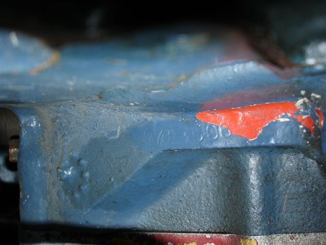

Got the car !
Block # could be: 9799506, it´s really hard to see. It´s a four-bolt main block.

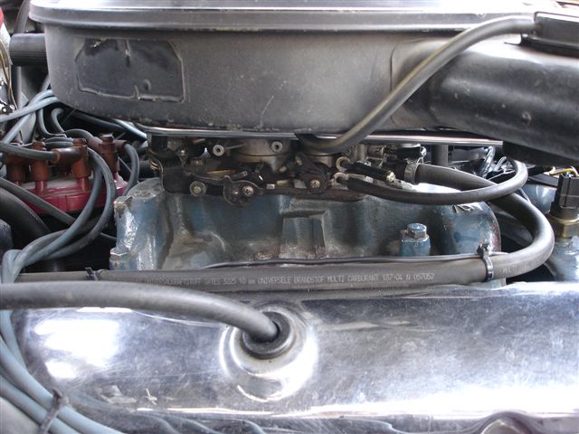

Intake # is 9799068 I believe.

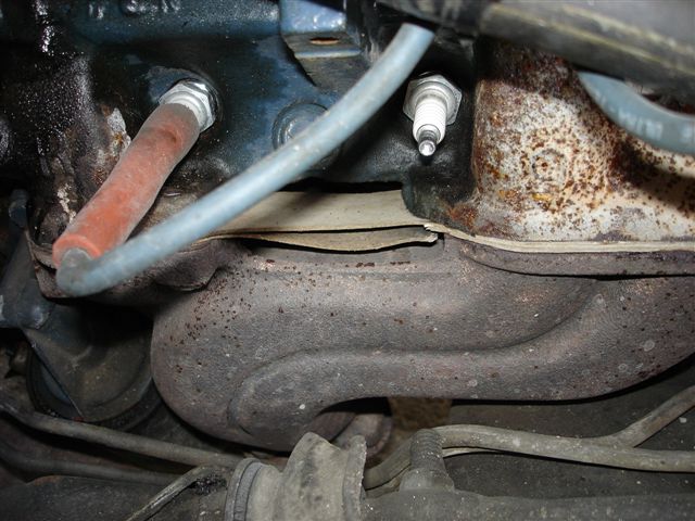

The left hand exhaust manifold # is: 478141LH

Double check the block numbers 1968 400RA #9792506 . That same casting number is a RA IV if it is dated 69. The 96 heads = 19681/2 Ram Air II 400, round exh 2.11/1.77 71 cc's.
What are the two letter codes on the block below the passenger side head. See below for codes.

Mike, it is the fourth # that is hard to see. I put the camera back there, but I´m not sure. I guess it must be a 2.
Where do I find the casting date on the block ?
Pic of intake.

Exhaust again

I BELIEVE WHAT YOU HAVE IS A RAM AIR II LONG BLOCK. 2506 IS A 68 RAM AIR AND A 69 RAM AIR IV BLOCK AND SINCE YOU HAVE THE HEADS ALSO,I WOULD ASSUME YOU HAVE A COMPLETE ENGINE WITH A 70 INTAKE ON IT. I WOULD BET IT HAS A 9041 [T] CAM IN IT ALSO. NICE FIND!

#9792506, I can´t find the date code. Where is it ?

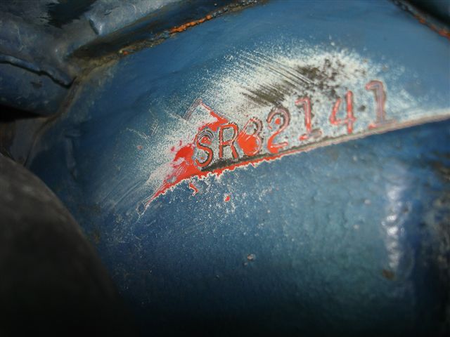

SR82141 deep down on the block. What is this ?

SR=SERVICE REPLACEMENT 8=1968 2141=DEALER DATE CODE
