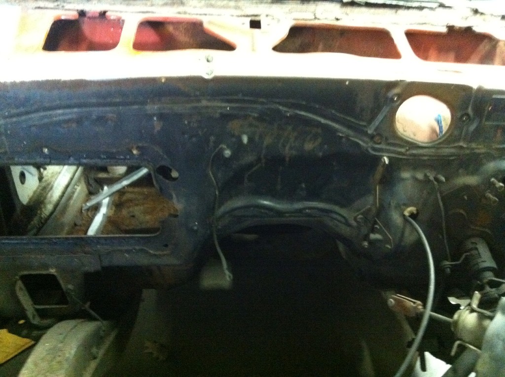

Default Re: Cowl markings on my L-78 M-22 Indy
thought this pic would help of the whole cowl..to get an idea of the location of the markings...sorry for the quality..(ifone pics)...

So i started with lacquer thinner on the center of the cowl above the tunnel where the obvious marks were...these letters appeared at first.. I think I know what they are now, but I'd like others opinions first.....
