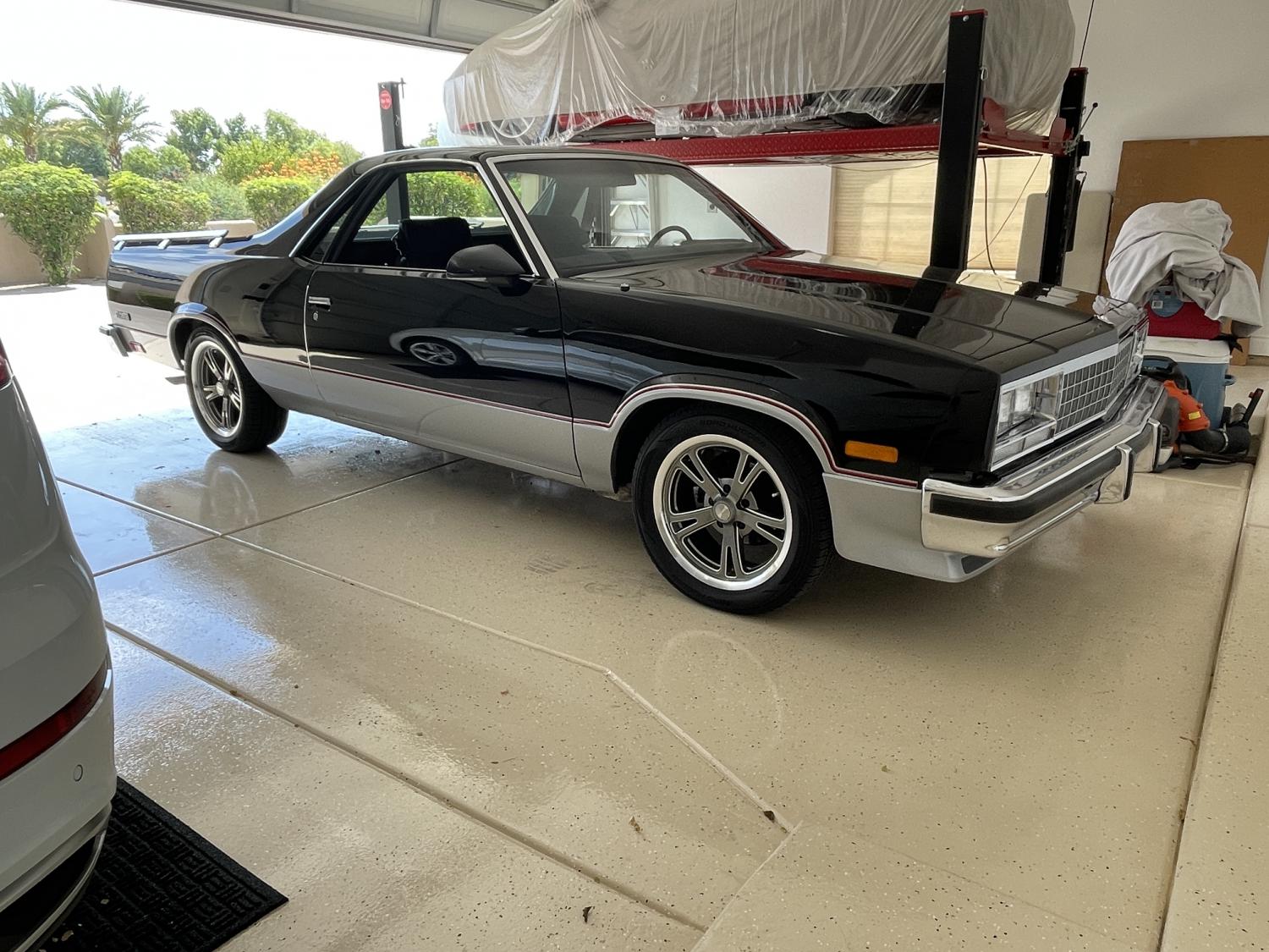

  #29
Old 11-11-2023, 02:50 PM
Posts: 9,353
Thanks: 32,277
----Wow, that's a great looking El Camino! Makes me wish I had never sold my 86 as I really liked it. Proir owner to me kindly installed a ZZ3 in it, so it delt with the one thing I have never much cared for, lack of power.
  #30
Old 11-17-2023, 04:20 AM
enio45 enio45 is offline
Location: Gilbert, AZ
Posts: 4,116
Thanks: 420
Thanked 369 Times in 215 Posts
thank you...i looked for a yr before buying these wheels - and moved up from the 14 inch stock wheels to these 17 inch. I worried it would be too big a wheel, but not.
Eddie M
Camaro-less
87 El Camino SS
Few Ferrari's
