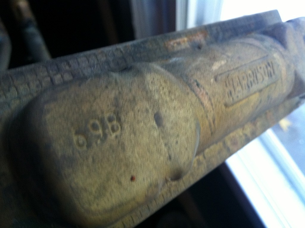

<div class="ubbcode-block"><div class="ubbcode-header">Originally Posted By: iluv69s</div><div class="ubbcode-body">and ths was really cool to me... two option codes?? any guesses?
what is that hole I wonder?? Any body seen a hole made like that before? that is nor factory is it?? an old tach hole or guage or something?? and how did they do that I wonder? </div></div>
I am going to guess that the heater core was replaced at some point in time and the push on retainer which holds the inside heater box to the firewall was not taken into consideration thus the doctrine of &quot;if it doesn't come apart, GET a BIGGER HAMMER&quot; prevailed.

d14 or ?14

is d-14 an option code??
it looks like the orig hetaer core..I assume this is a date code??? Feb 69 for an 03D car..seems to make sense...??

----Boy,,,Id be pressure testing that heater core!......Bill S

<div class="ubbcode-block"><div class="ubbcode-header">Originally Posted By: olredalert</div><div class="ubbcode-body">----Boy,,,Id be pressure testing that heater core!......Bill S </div></div>
For sure... coolant on the feet is not a pleasant experience, which inevitably will happen at the least opportune moment... like in the middle of cruising on a HOT summer night.
There is probably a line number or sequence number in red pencil on the top of the heater box, should also be on the gas tank as well as other components. It may match the number on the far pass side of the firewall.
