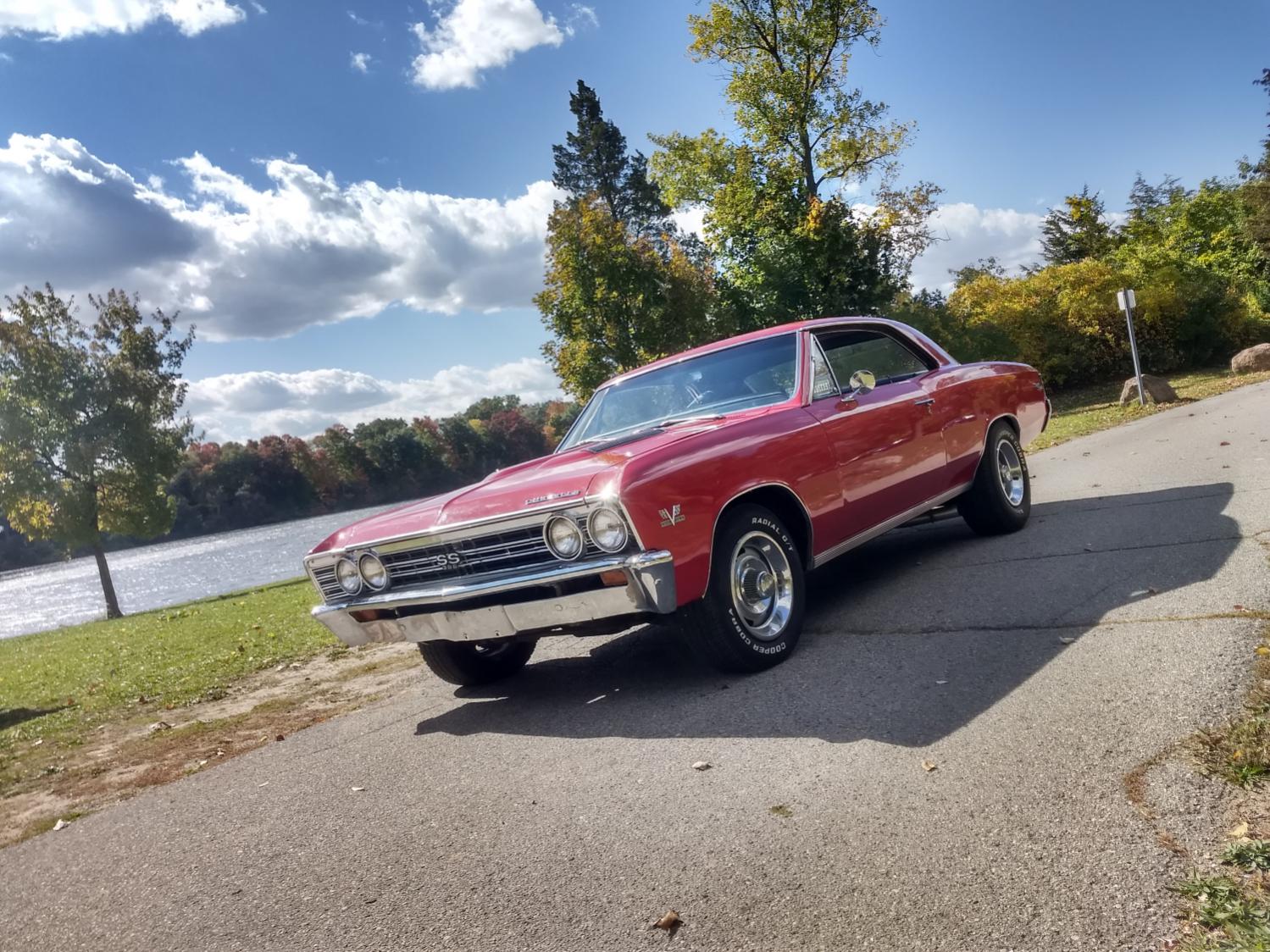

I figured it's time the Chevelle got its own topic. This one won't see many posts for a while however, since it runs just fine except for something killing its battery and it can't be driven thanks to the tires. We just got a new grille emblem and door mirror for it. Trying to persuade the dad and my Pappaw to get it the new tires it needs.
