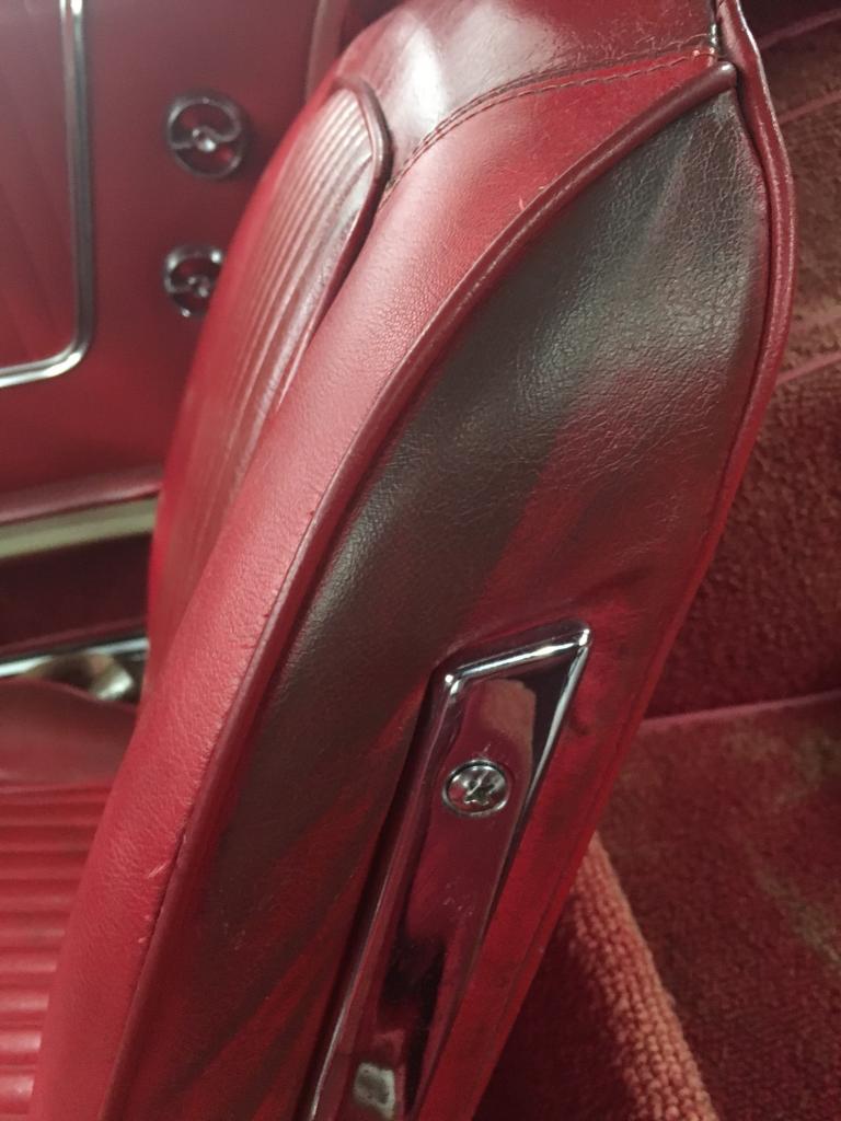

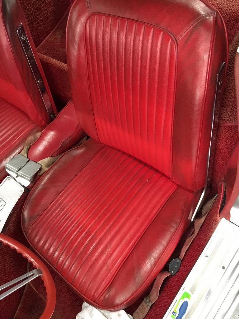

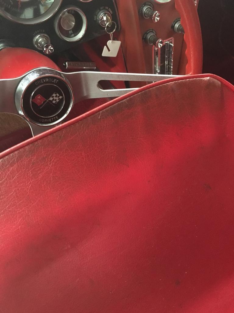

I'm heading down the preservation path with my '63 Corvette and struggling to get the vinyl seats clean. I've attached a few pictures of what I am dealing with. So far I've used 303 Products; citrus degreaser, vinyl and carpet spot remover, and interior vinyl cleaner ). They have helped but have not been able to removes the dark staining. Any other suggestions or methods?

Magic Eraser.

----Rob,,,I have a bunch of experience with 63 red vinyl Corvette seats. I wish you good luck with the eraser, but the darkening I see is what happens to original 63 Corvette red vinyl. I believe you will not be able to bring the original color back to the darkened areas......Bill S

I agree with Bill. Once the material discolors (changes chemically), that is what you have. Sounds like all the dirt is gone (if not, a magic eraser will remove it). A very talented person can re-dye the areas you don't like. Personally, I would leave it. Just my $.02 worth.

With the experience Bill and Phil have offered up, would the over all consensus be clean it as well as possible then leave it. Or try dying it to get closer to original appearance? Its a tough decision and one that crosses between restoring and preservation.

If it won't clean with Magic Eraser I would try fogging some spray dye from one of the Corvette suppliers.

Are you ready for the snowball effect? If you just dye the seats, everything else will look even worse. If the interior is good, but just faded then you can dye the seats,carpet,door panels.

----I agree with Roger. The fact that you have good, original condition seats is such a rarity that I wouldn't touch them except to make sure they are clean. The time worn statement that they are only original once applies here. I would, however restore the seatbelts. Your car would look so much crisper then!....Bill S
