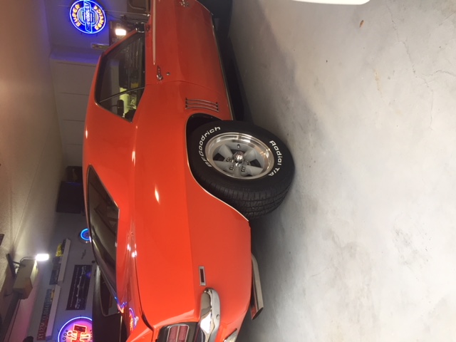

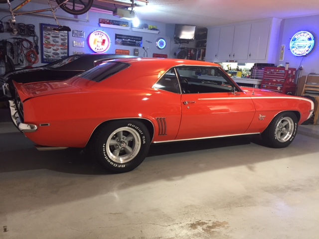

Hello,
I am looking to replace some tires on my 69 Camaro SS/RS with some bias ply. Right now I am running 215/65/15 in front and 255/60/16 in rear on SS wheels, 15/7 in front and 15/8 in rear. I am wanting the same size tires but in bias ply. I was looking at F60's in front and G60's in rear as a possible option. Need to be around 26" tall in front and 27" tall in rear or close to this.
Anyone running these tires sizes in bias ply on a 69 Camaro? Wondering if F60's will rub in the front? Wish Firestone would make the Wide Oval in a G60 radial. They just don't have a lot of options yet. So looking at the Goodyear's....

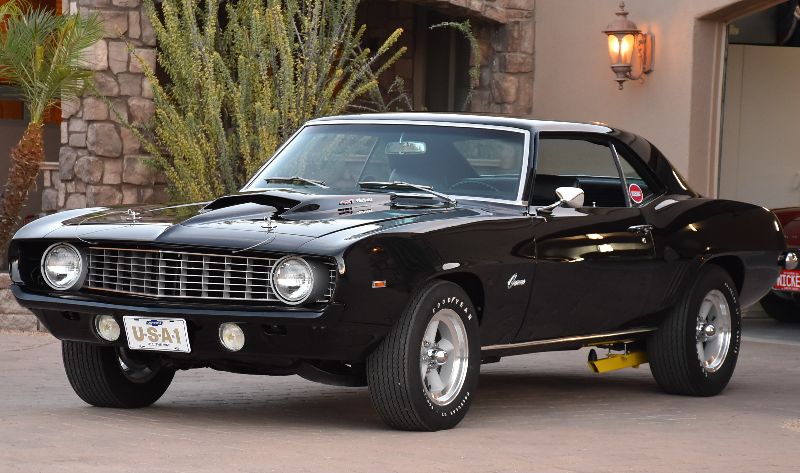

I'm running L60 Pro Tracs on the back of mine with but haven't driven it with them mounted yet. Looks like they will probably rub on corners w/o air shocks but luckily I do have a pair of those as well. I have seen one other car with L60 Goodyears and it looks really cool with the Goodyears. It is posted on TC forums (Post #702) linked here and pictured below
Don't know if Goodyear G or L 60's will rub when mounted on 8's so maybe Rusty can help you out with that. I would think G's are low enough profile so good chance those will work.

Good looking Camaro. Love the tires/wheels. I think it could stand a bit taller tire out back...JMO!

Here's mine with the Cragar 8" rears and 4.25 backspace. I went another direction on the front with skinny's on 4" rims. (old school look) I believe the red car above has E series on the front and he removed two bolts to prevent rubbing, but his front end is also dropped 2" too.
