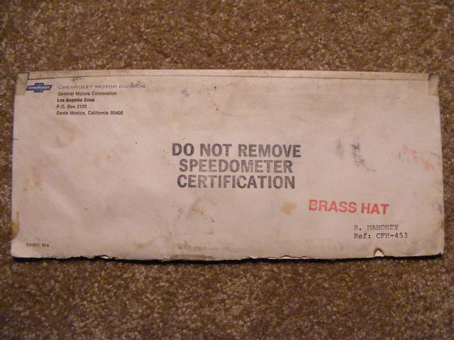

But it isn't the typical muscle car, and you have to look past its number of doors to truly understand its historical significance. It is a plain jane gold 4-door, granny-looking car that was the 2nd Nova police car ever built, and its build sheet says "COPO OPTIONS". It was ordered by an executive named Rick Mahoney who was the Fleet Sales Manager at Chevrolet's Los Angeles Zone Office. In addition to the build sheet, I also have the envelope that held the car's speedometer certification paper (which has the car's VIN typed in), and the warranty booklet which has "Zone 20 Demo" typed on the bottom (that is the number of the LA ZO). The speedo cert envelope has a return address for "Chevrolet Motor Division. Los Angeles Zone", and is addressed in the lower right corner to "R. Mahoney" and references "CFH-453", which is the car's order number from its build sheet (that is how Chevrolet kept track of its zone office cars).

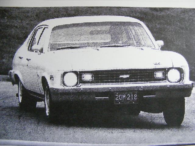

Harry and Jim took the white '73 Nova 4-door taxicab that was languishing in the Tech Center's parking lot and brought it into a room and yanked its 6-cylinder drivetrain. The taxi had tinted glass, A/C, a plain taxi interior with a rubber floor mat, and it was a perfect platform for the police car. Harry and Jim put together a laundry list of GM parts numbers needed for the project and obtained them from one of GM's many Detroit warehouses. The police car took about 2 weeks for the mechanics that were also on the police car team to build. Then the fine tuning began. GM's Proving Ground is located in nearby Milford, and contains a huge asphalt parking lot named "Black Lake", due to its resemblance to an actual lake. The engineers tried every combination of springs, shocks, bushings, sway bars, wheels and tires to come up with the best possible result. One of the hardest areas to address was the Nova's tendency to tip during high-speed directional transitions. That test occurred when the car was going 45 mph and was turned in a 90 degree direction. Jim suggested that the 14x7 wheels used on the '69 COPO Camaro in conjunction with wider bias-ply tires might achieve the desired results and stop the tipping, and he was right.

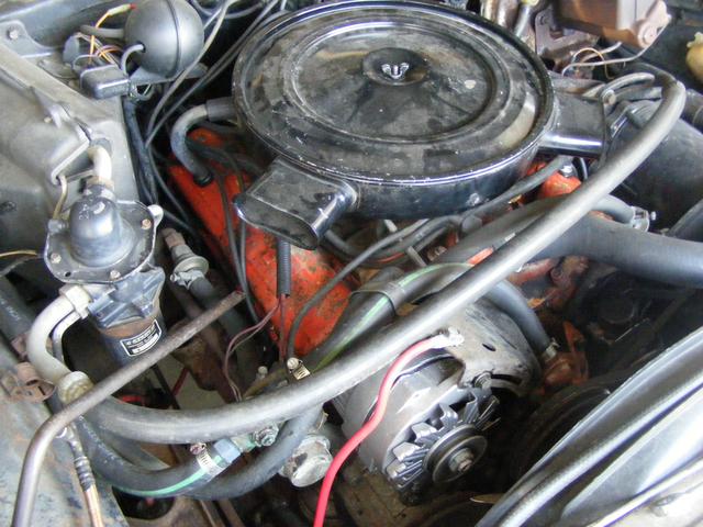

The rest of the prototype was standard GM fare...an L48 350 4-barrel engine, TH350 transmission (but with a special high-speed shift valve and a heavier-duty torque converter), a dual snorkel air cleaner borrowed from the Z28, a Z28 4-spoke steering wheel, dual exhaust, an HD radiator, a 3.08 posi axle, an HD alternator, power steering which utilized a Z28 steering box, and front disk brakes. The rear brakes were borrowed from a Chevelle station wagon as the drums had larger cooling fins and larger shoes to handle repetitive high-speed stops.
Harry and Jim left Detroit on Thursday April 25th and drove their little white sleeper to LA, utilizing as many back highways as possible to evaluate their creation. They spent the first night at a motel in Joplin, MO, their 2nd night in Tucumcari, NM, and their 3rd at a hotel in Santa Monica.
The prototype surprised and pleased the LASD officials, and easily bested the Plymouth Satellite, Dodge Coronet, and AMC Matador that it was designed to beat. It also beat Mopar's smaller entry, a Dodge Dart with a 360 4-barrel, and a Pontiac Ventura with a 350 4-barrel Pontiac engine (none of the competitors got better that 13 mpg...the Nova got 16.1 mpg on the 72 mile urban test-loop that involved both freeway and city streets).

Rick kept the car until Nov. 4, 1974, which I can verify by its original warranty booklet, which miraculously stayed with the car (along with its speedometer cert paper). The warranty book is actually for a '75 Chevrolet, and Harry believes this was because zone offices typically got rid of all of the previous year's papers upon the start of a new model year. The buyer of the car was the "County of Los Angeles, Fleet Management Division", and the car was assigned the number "46892", which is painted into the driver's door jamb area. The car's keys are stamped "LASD 46892", and also "STA 9", which was the West Hollywood station back then. The mileage at the time the zone office got rid of it was 2,169. The car also has a shotgun rack still riveted to the right side of the trunk...it contains a locking mechanism which releases the gun when a toggle switch hidden under the dash applies 12 volts. Inside the glovebox is a yellowed sticker which identifies the 4 radio channels that the car communicated with...the first is "WHD Disp" (West Hollywood Dispatch).

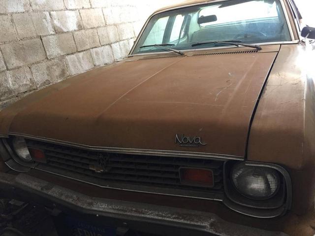

I found out about the car in June 2017 when a woman named Nancy Smith sent me an email that her 86 yr-old father, Woodward "Woody" Smith had Alzheimer's Disease, and she needed to sell his house in the Hollywood Hills (his house was on Holly Drive, right behind and up the hill from the historic Hollywood Bowl amphitheater). Inside his garage was a gold Nova that he had always told his kids was an actual police car. Nancy had tossed around the idea of having the car hauled off for junk, but thought it might be worth more than the $200 she had been offered for it. I told her to have a mechanic pull out the back seat or lower the gas tank to see if the car's build sheet could be found (it was on top of the gas tank). As soon as I saw "COPO OPTIONS" on the sheet, I told her I wanted to buy it. We settled on a price for the non-running car, and I told her I would be in LA within 30 days to buy it.
The car was absolutely pristine, just dirty from sitting inside a garage for 31 years. Woody was a compulsive pack rat and had saved every piece of paperwork that had come with the car, as well as all of the papers and receipts for the 4 other '75-78 Nova police cars that he had purchased at LA County auctions (he gave one to each of his kids for use at nearby Hollywood High School...yes, the same Hollywood High from countless movies and TV shows). It was while going through the papers that I discovered the speedometer cert and warranty booklet that confirmed the history of this unusual and historic car. Also with the documents was the LA County auction receipt from April 24, 1982 where Woody bought the car for $875. The sales receipt shows that the LA Co. agency getting rid of the car was the LASD, and that its county vehicle number was "46892".

Once I started looking the car over, I realized what a little gem it was. I has one minor rust area on the right front door, and a couple of dents, but nothing major. I cleaned the car out by removing both seats and discovered many matchbooks which included one for a Hollywood strip club (cops!), a Hollywood liquor store (cops again!), and a couple of diners (Bob's Big Boy and Norm's...both well-known LA institutions). Also found were many cigarette butts, a couple of .38 caliber shell casings, a couple of crumpled cigarette packs, a Moon Pie wrapper, an orange plastic key fob for the LA Zone Office, and a money clip for the LA Zone Office with the initials "RM" engraved on it.

I got the car running by replacing its varnish-filled gas tank, replacing its fuel pump, cleaning out its clogged fuel lines, and having its original Q-jet carb rebuilt. I towed it up to Fenton, MI so Harry could see the car he designed and ordered. We shared a burger and a couple of drinks at his country club, and he gave me several police car books and GM documents that related to the design and building of the police car prototype. He also signed the inside of the trunk lid...I am deeply honored.

He invited noted muscle car expert and writer, Drew Hardin from Muscle car review magazine to look at the car. Drew spent 30 minutes photographing it and taking notes on it. Drew said he had never seen anything quite like the Nova, and was especially impressed with the envelope which showed it was a Brass Hat car. He put a sidebar on the car on p37 of the Oct 2018 issue of Muscle Car review, and indicated he would like to do a feature on it at some point in the future.

For the time being, I plan to keep it unrestored. Its body is pretty beat-up, and there is no saving the roached paint. I had the left valve cover off 4 months ago to replace a very leaky gasket and discovered that it has Z28 heads (numbered "330545") with screw-in rocker studs and high RPM push rod guides, which are definitely not stock L48 heads. Harry Hammond thought that Rick may have had some mods done to the engine to make it faster for demonstrations for police officials, but he couldn't confirm this. It will be rebuilt this winter, and I'll be taking it to the Heartland Nova Show in the Quad Cities in June. The club president, Jeff Grady said it would be allowed in their pavilion in case it rains. ;-)
