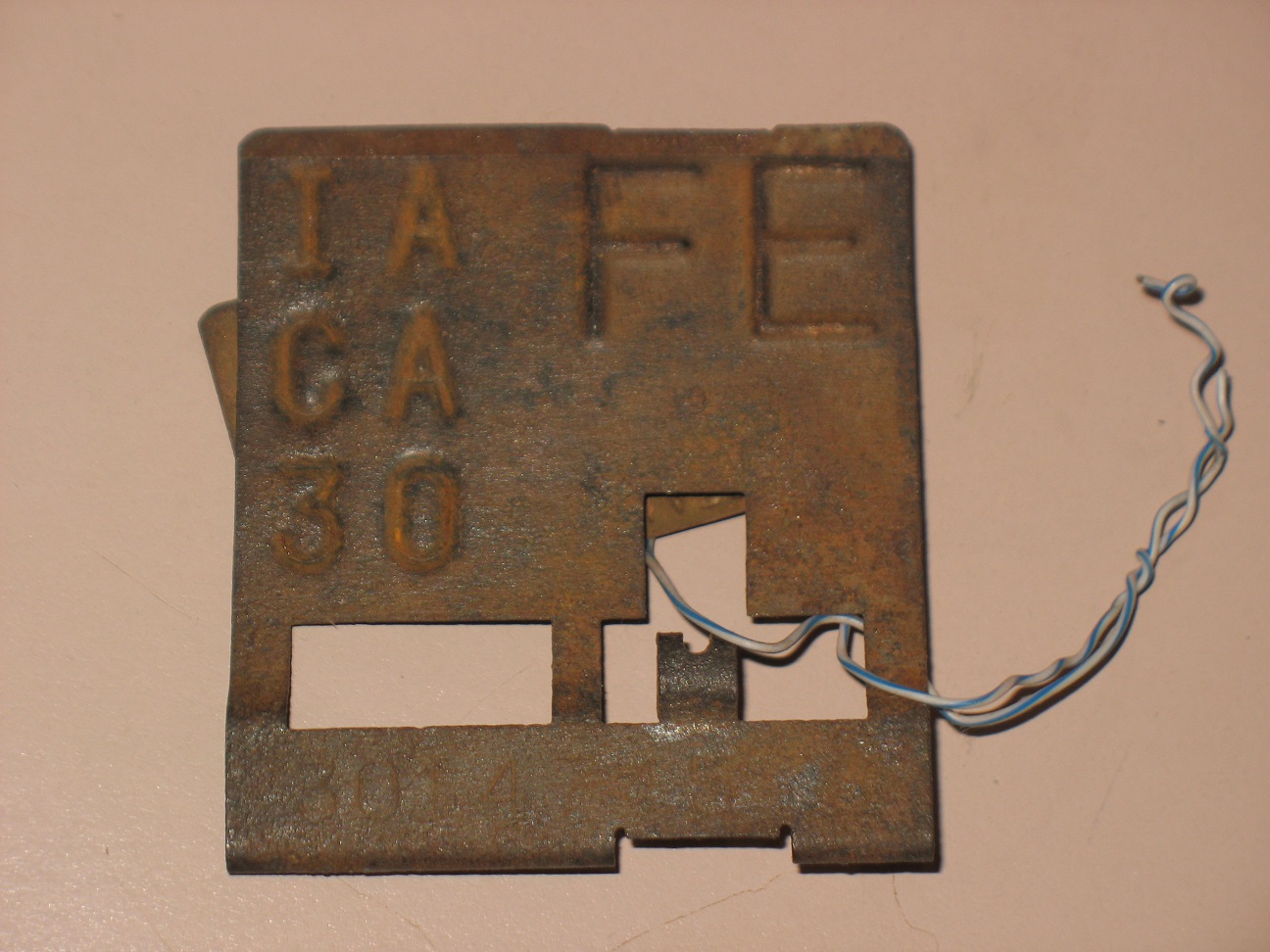

Radiator tag is FE tanks IA CA 30, does anyone know what this is off of?

There’s a chart in the parts book, I can look it up in the morning. But my book starts in 1976 though.

I believe fe is 1970 442 Cutlass, vista cruiser. It may also be for 69. I had a fe radiator in my 70 442.

What dvss1 said....'70 Olds BUT...
It looks like your radiator is a the "HD 2.00" core" radiator which means it is a 3 row core.
This would be correct for a '70 442 or W30 WITHOUT AC I believe.
For a big block '70 Olds Cutlass, 442 or W30 WITH AC, the car would have come with a 4 row radiator (2.70" core - tag "EC").
Also - your radiator would be appropriate for a '70 W31 with 3.42 gears....3.91 '70 W31s got the larger 4 row radiator.
