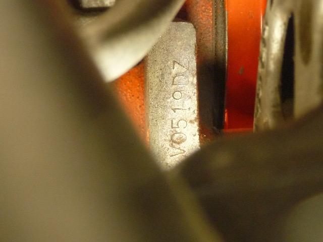

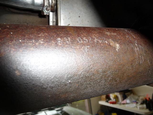

Here are some drivetrain pics i was sent.
