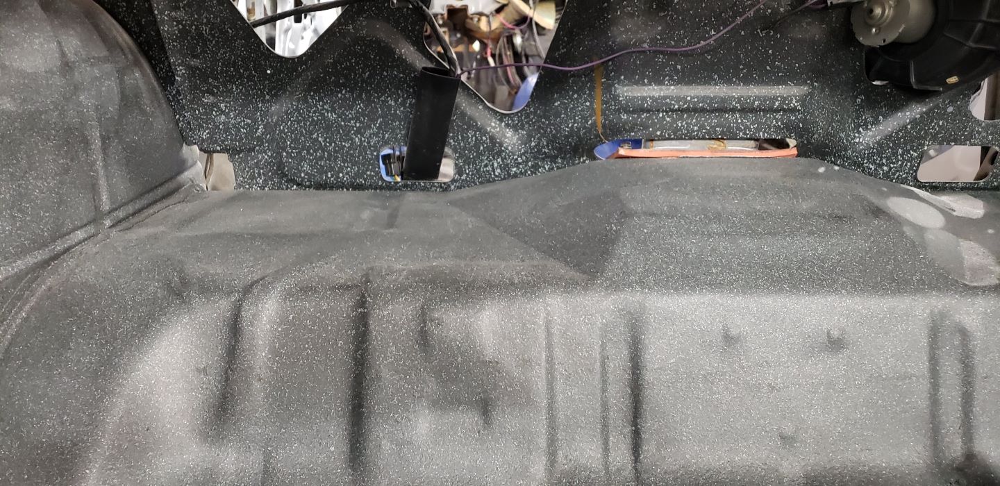

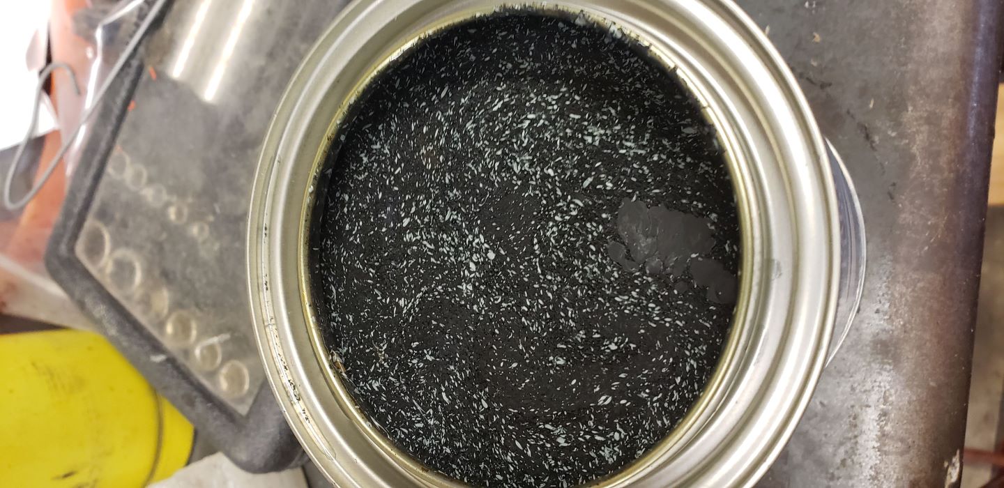

Last night I did a test spray of black with aqua trunk spatter from "The Parts Place" using a Wagner Power Painter.
When gently stiring the product, you can really see the green specs, and the color on the paint stick looked close. I have a sample piece of metal from my original trunk to compare it too. i do think the specs are a little smaller in the new paint.
It did "not" work. It came out looking like blackish gray undercoat and i could not see any of the green specks. My guess is the way the electric power painter's small piston throws the paint, it probably breaks up the green specs.

Ok, It's done. After trying various methods, I got great results by using a soft foam roller from Home Depot and foam brushes. When doing it, I used the foam brush to do corners and other areas the roller will not do. Just dont press hard on roller or brush. If you do, it smashs the aqua specks. No bid deal, you just roll over it again. It does not show roller marks. I have samples of the original truck floor spatter to compare it to, and I am very happy. Doing it this way also eliminated me from overspray. Like I said in earlier post, i used: black with aqua. I bought a quart of the product from "The Parts Place".
Before breaking out your spray gun, I recommend buying a cheap roller and doing a test.
